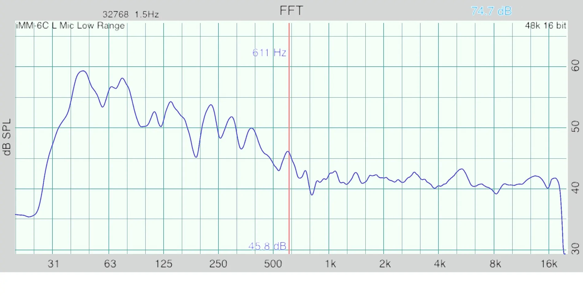

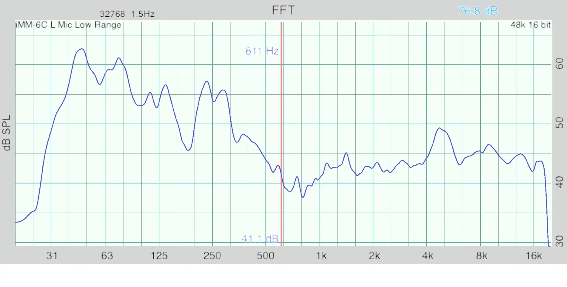

I first record a 30-second pink noise playback sample without any EQ (both in-car and external from my Android digital player FiiO M21). I use Bluetooth (SBC codec), since I cannot use Android Auto due to this app is not installed as system app so the car won’t recognize it (It worked for 2 years with my older M11S, but somehow Google does not allowed me to do so earlier 2026, weird). Anyway, below is the measurement without any EQ. There are some huge dips around 170Hz (I guess due to door panel harmonics maybe?) and between 400Hz and 1kHz (which explained why I felt the vocal was missing something). There is also a spike up on 4700Hz but that should be easy to attenuate. Good news is that the the frequency is pretty flat overall for 1kHz and above.
I output the FFT analysis in .txt file and feed to Claude to give me an initial approach draft (yes I am being lazy lol). I reviewed two draft pass and made some minor adjustment for a pass 3. Here is the final result I got for now:
I think it is a much better representation, although low frequency spike & dip is still there. The dip in midrange is mostly resolved, and high frequency above 1kHz is just beautiful within 2-3dB.

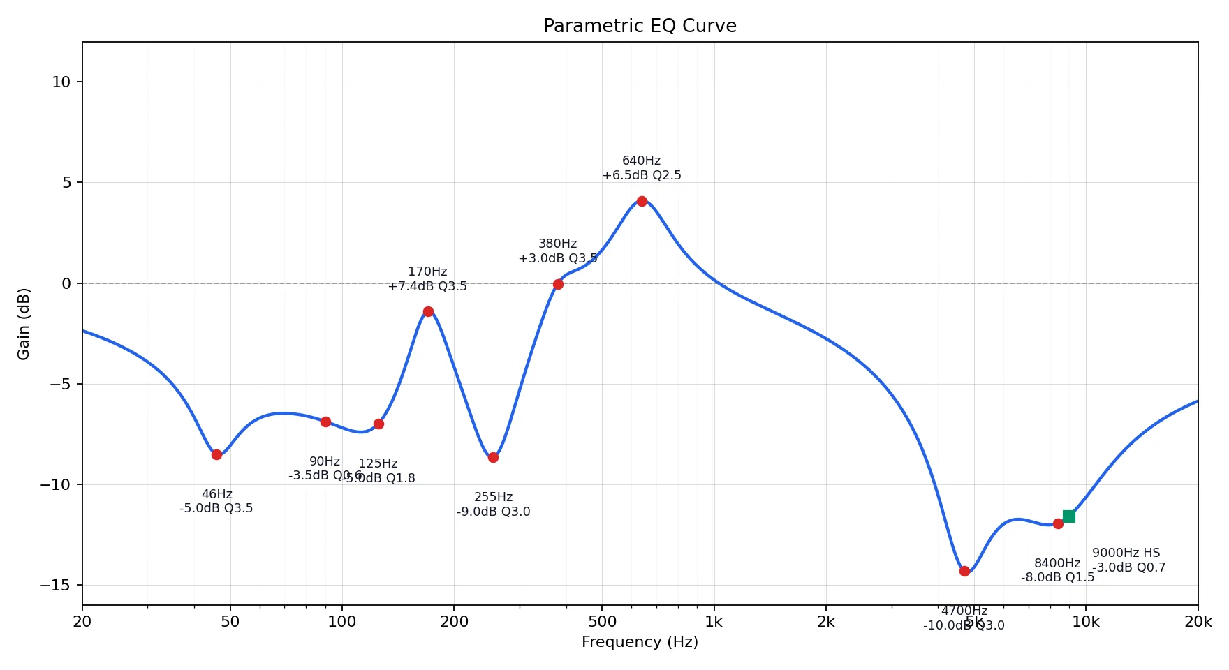

Here is the Parametric EQ setup I use now on my FiiO in PowerAmp EQ:
46Hz -5.0dB 3.5Q,
90Hz -3.5dB 0.6Q,
125Hz -5.0dB 1.8Q,
170Hz +7.4dB 3.5Q,
255Hz -9.0dB 3.0Q,
380Hz +3.0dB 3.5Q,
640Hz +6.5dB 2.5Q,
4700Hz -10.0dB 3.0Q,
8400Hz -8.0dB 1.5Q,
9000Hz high shelf -3.0dB 0.7Q.
Preamp set to -7dB to prevent clipping on specific boosted frequencies. I also turned on compressor with the following settings, to compensate road & wind noise:
Attack: 35ms
Release: 190ms
Ratio: 1.8-2.0
2-band cutover Frequency: 600Hz
Threshold: -18dB
Gain: +10dB
Knee: Soft 4dB
Final EQ summing curve is like (I used Claude to show an overview, although the 4700Hz dip seems too deep in my opinion, need further checking.):

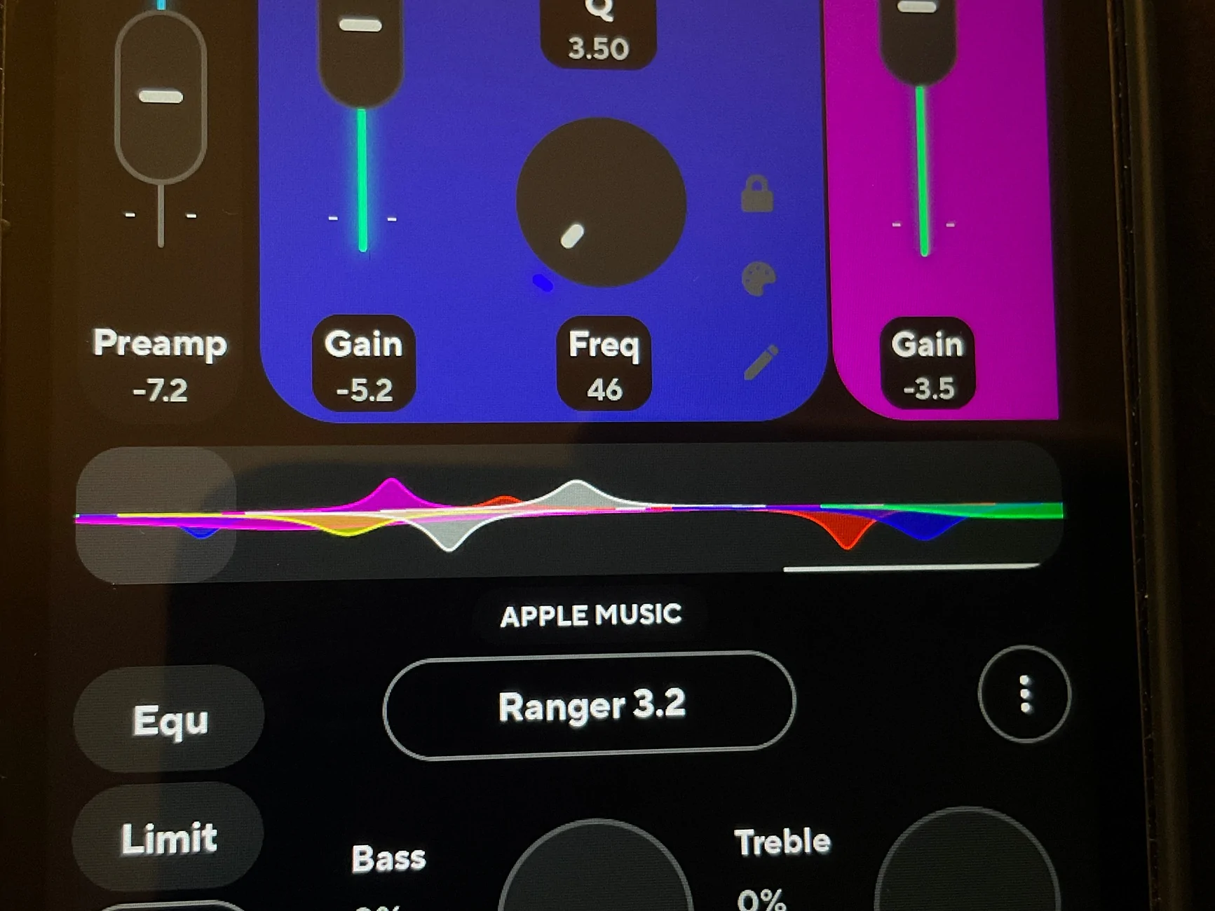

My Poweramp EQ shows:
Now the audio is more balanced but a bit bland. I might turn up bass gain a little bit to get some beats lol.
