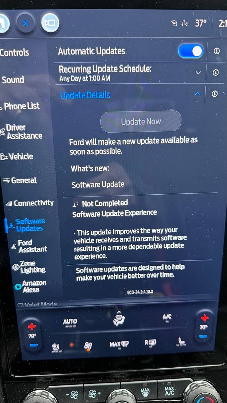

So where do you see that a software update has been done? If I go into Software Updates I see this. What doers it mean "Not Completed"? It's been like that for days.
Ford Ranger Latest software update reset all my presets / memory settings IMG_1073
