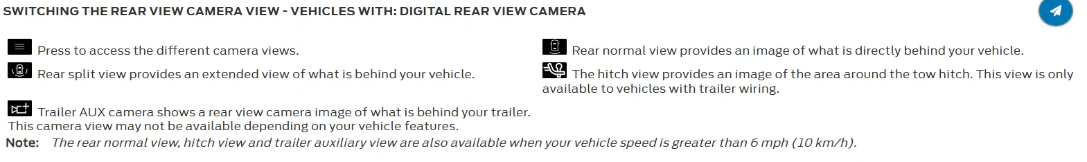

My update was over air... In reverse the camera now shows the trailer hitch in the screen on my Lariat. Trailer assist update?

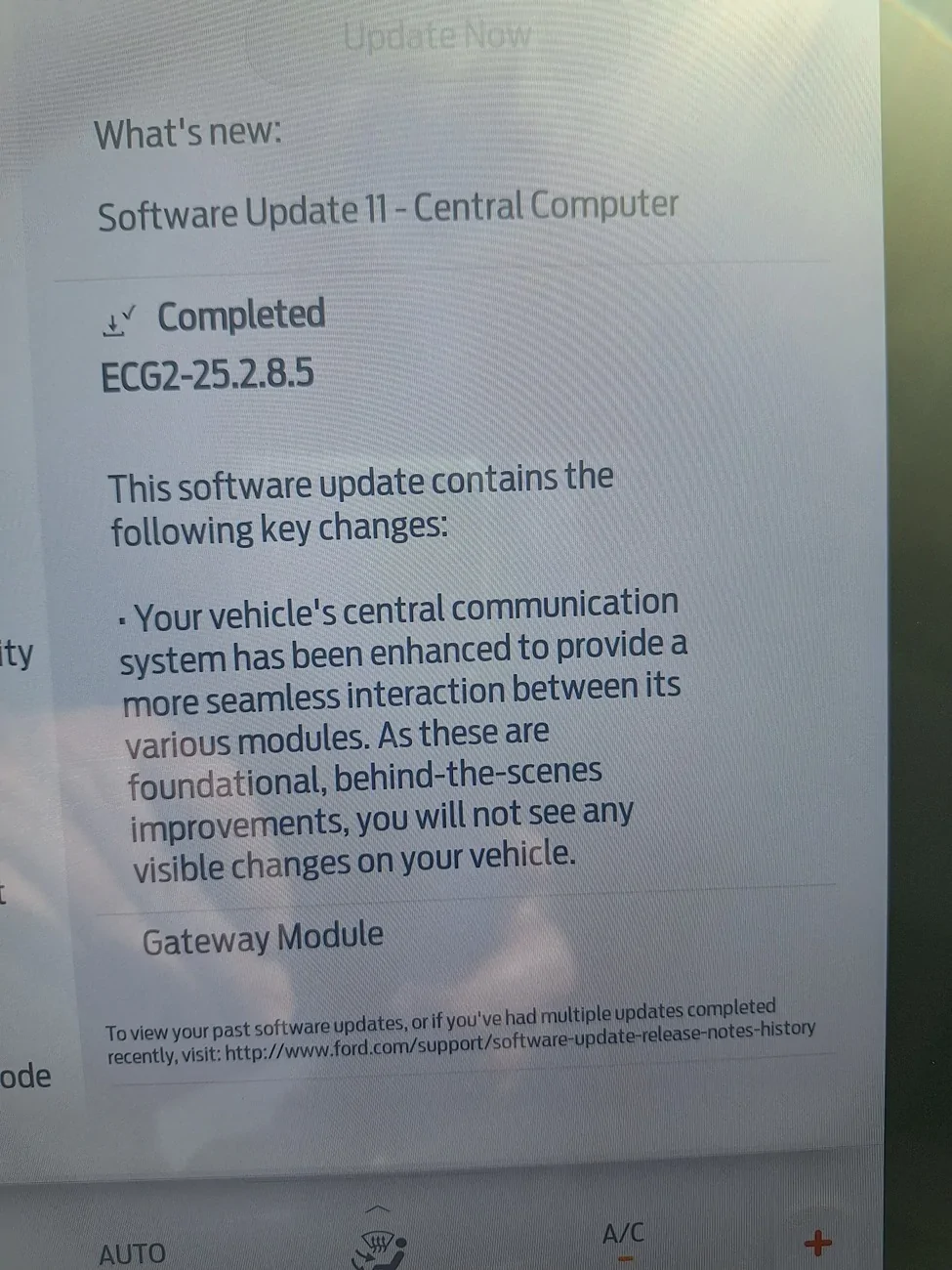

I have a 2024 Ranger Raptor and I got an OTA update installed Friday. Onscreen note as everyone has posted but not much info.
