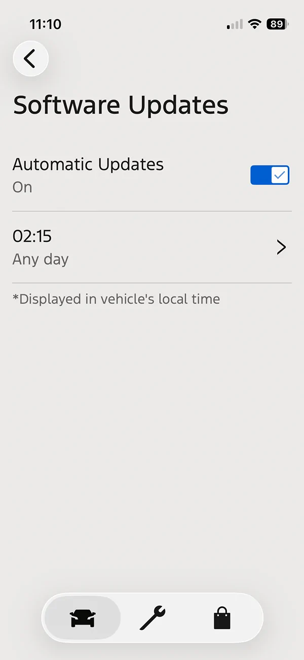

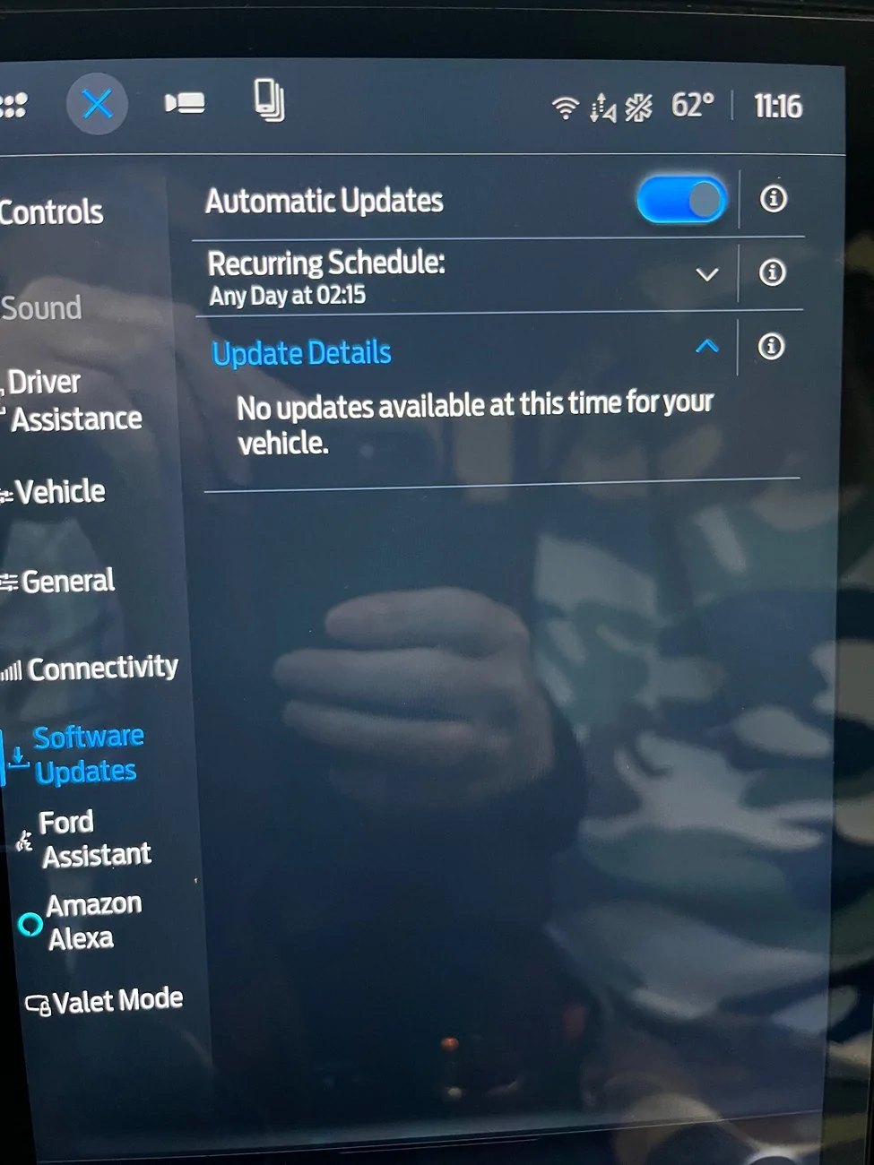

Hmmmm.... Checked the app and the truck and not seeing anything. Under the Connectivity section there was a SW version for the SYNC, is that for the vehicle too?
Ford Ranger Over the air update last night, wonky first start IMG_0938
Ford Ranger Over the air update last night, wonky first start IMG_0939

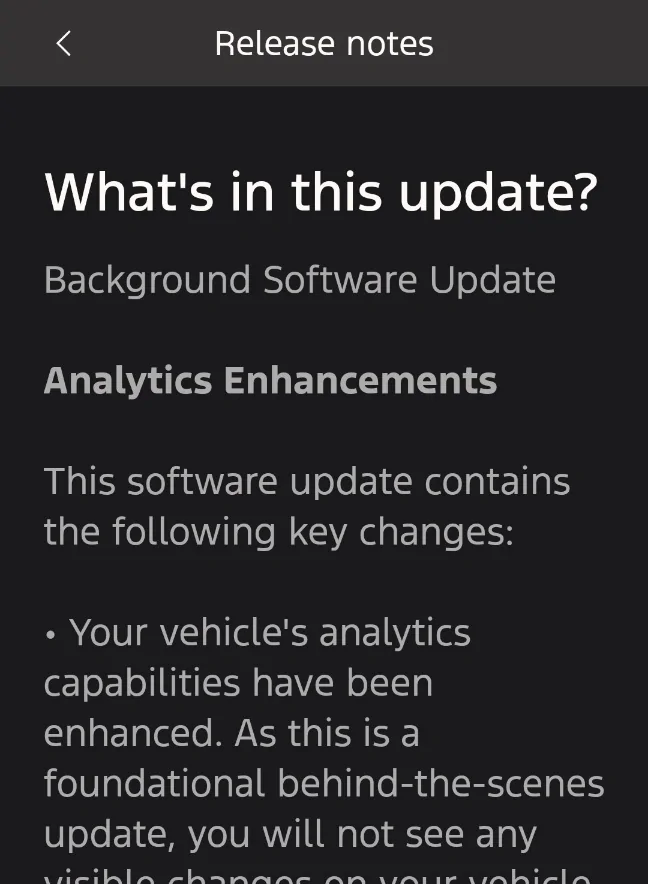

On my Ford app I just received an update on 9/26 and it shows up as...
Ford Ranger Over the air update last night, wonky first start Screenshot_20261004_142742_Ford

Hmmm, maybe with picking up my truck in June I am all up to date... Time will tell!
