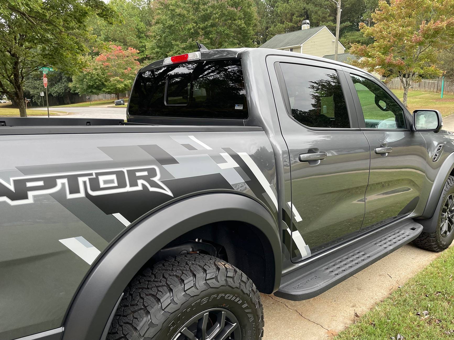

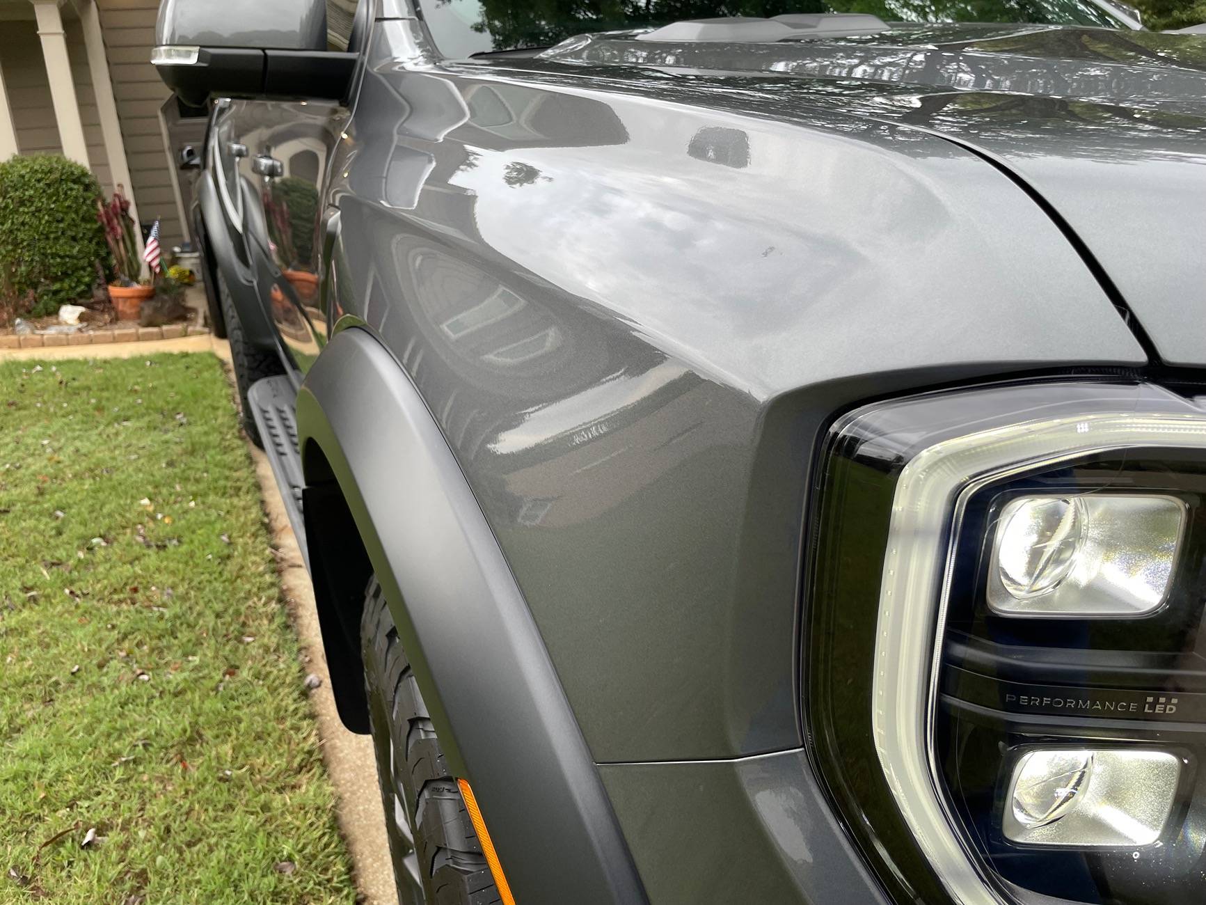

Did the Gtechniq ceramic. turned out great, washing it is easy—-can’t take it through a Carwash though. Dry it off with a leaf blower, and looks showroom ready!
Ford Ranger PPF, Ceramic Coat or Both? IMG_7516
Ford Ranger PPF, Ceramic Coat or Both? IMG_7515

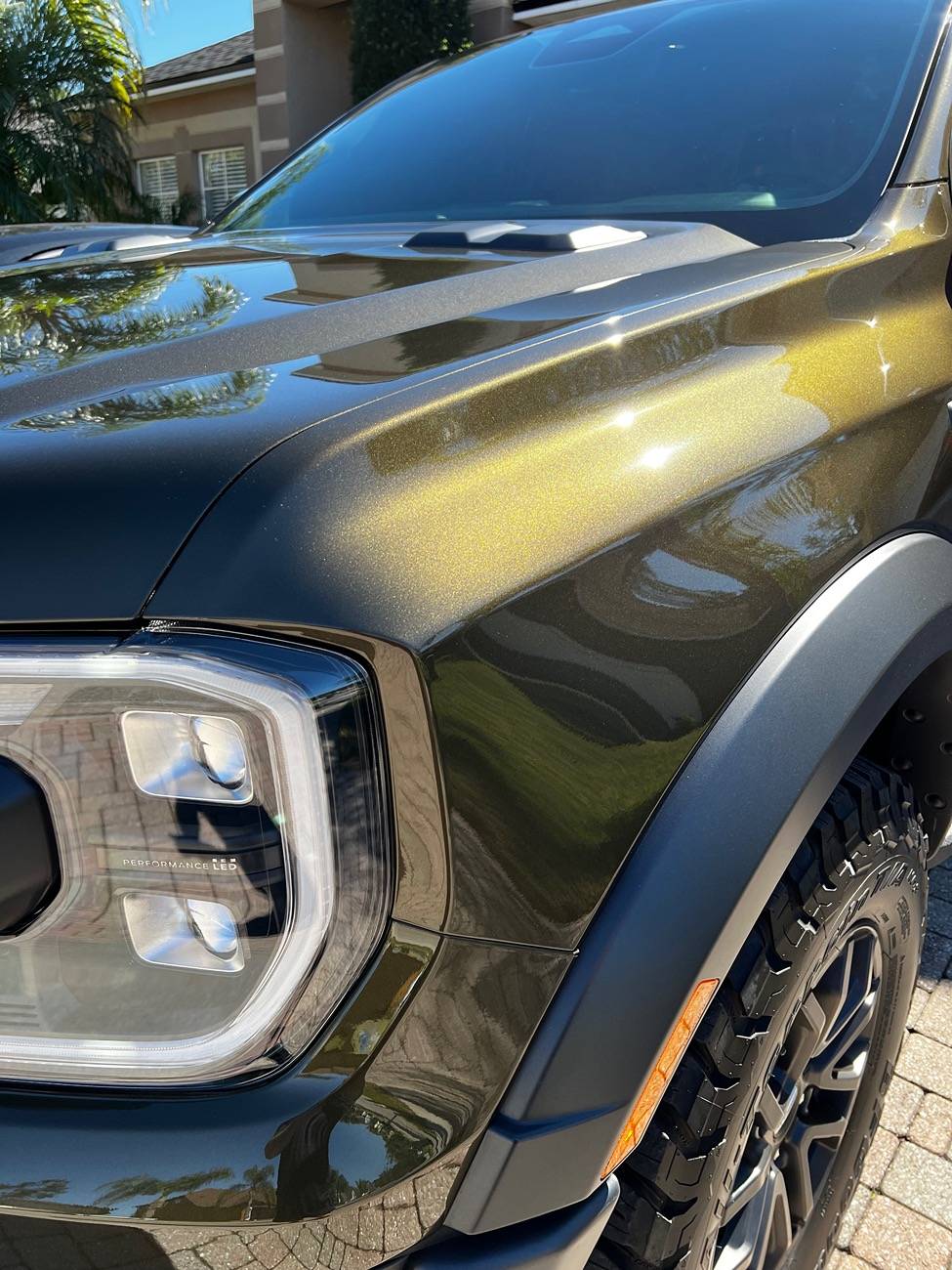

Both. Xpel PPF and Gtechniq crystal serum ultra/light and Exov5
Ford Ranger PPF, Ceramic Coat or Both? IMG_2869

Looks sweet ! Do you have info on the coating ?
