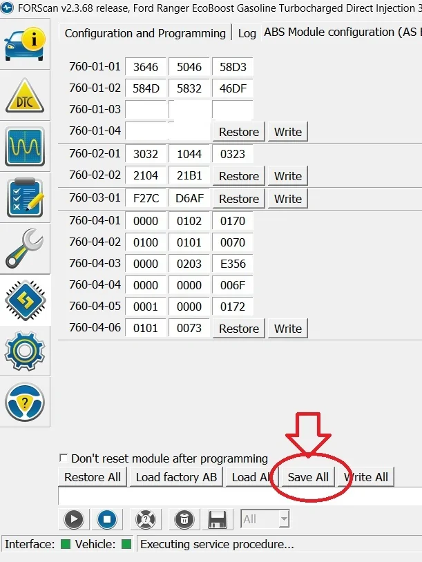

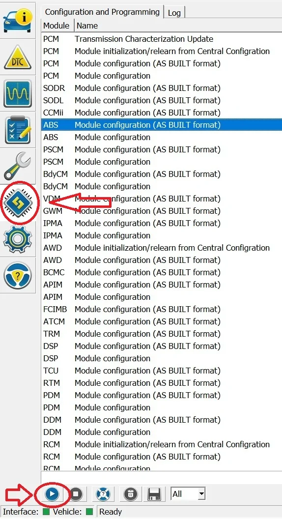

- Connect Your RANGER by diagnostic interface. Start FORScan and wait for connection established.
- Go to Configuration and Programming
- Choose module to collect data
- Run/Start - accept risk
Ford Ranger Ranger 6G FORScan data decoding tool(s) project 1
- Save All
Ford Ranger Ranger 6G FORScan data decoding tool(s) project 2
This procedure will make file in a folder ./[user]/Documents/FORScan/.
File name will contain [VIN number]_[short name of module]_[Date]_[Time].abt.
Ford Ranger Ranger 6G FORScan data decoding tool(s) project 3

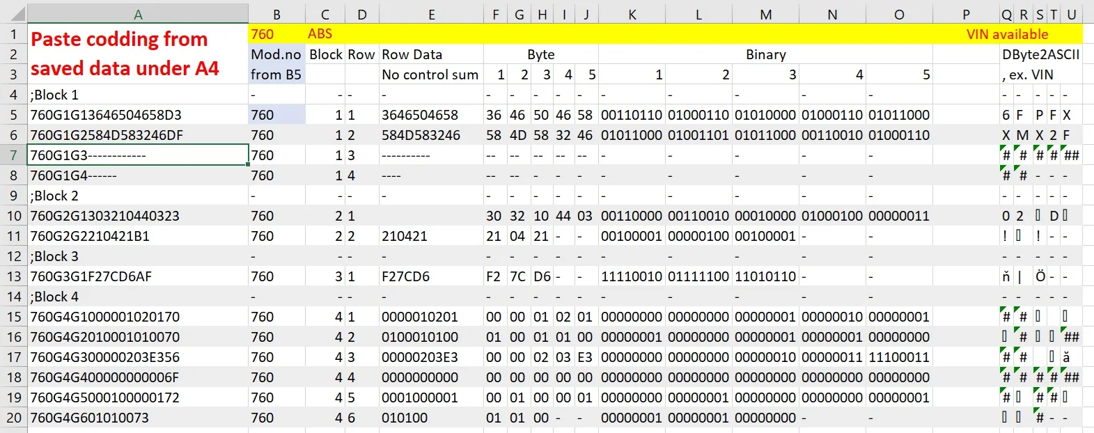

In fact if you already understand the way data is collected and which part of it is needed, than you can pass this part. Anyway even if I understand it well, I find it super useful for easy extracting as well as for avoiding errors.
- Open "Ford Ranger 6G codding calculator.xlsx" file from CC folder.
NOTE: this calculator is done with Excel 2021 in Polish. If in any case, contents is wrong for you, upload it in google drive and open it in web browser.
- Paste your data from .abt file under cell A4. It should looks like this:
Ford Ranger Ranger 6G FORScan data decoding tool(s) project 4
Your data for future use are in column E.
What else You can see here:
1. Cell B1 - number of module - it is a copy of cell B5
2. Cell C1 - name of module - taken from module list using number from B1
3. Cell P1 - if in this module VIN is coded anywhere, you can see if it is avaliable
4. Column B - number of module extracted from data
5. Column C - block number
6. Column D - row number
7. Column E - codding data extracted for future use
8. Column F to J - single Bytes for better understanding
9. Column K to O - bytes decoded in to 8 bits for better understanding
10. Column Q to U - Byte2ASCII decoder in case of VIN presence

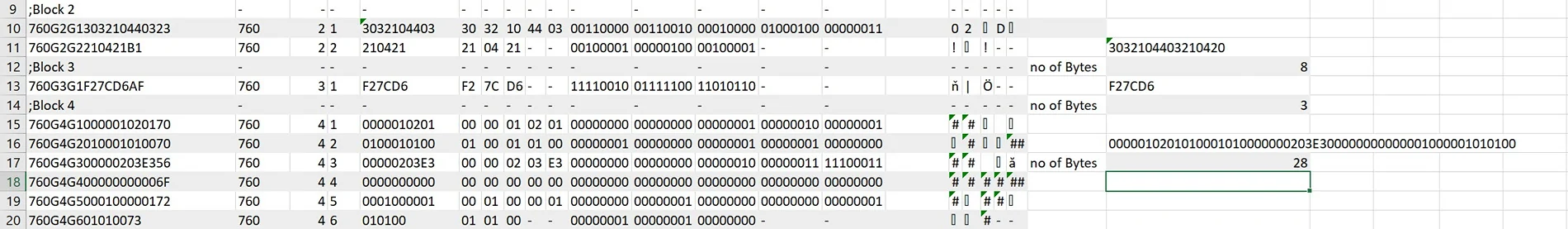

NOTE: From here can go in to next step but just for ease I did for myself another formula. Since I decided to separate codding in to blocks (more later) I use "&" in excel to merge data of every block.
Ex: "=E15&E16&E17&E18&E19&E20" to see complete codding of this block. It looks like this (number of Bytes is for later verification):
Ford Ranger Ranger 6G FORScan data decoding tool(s) project 5

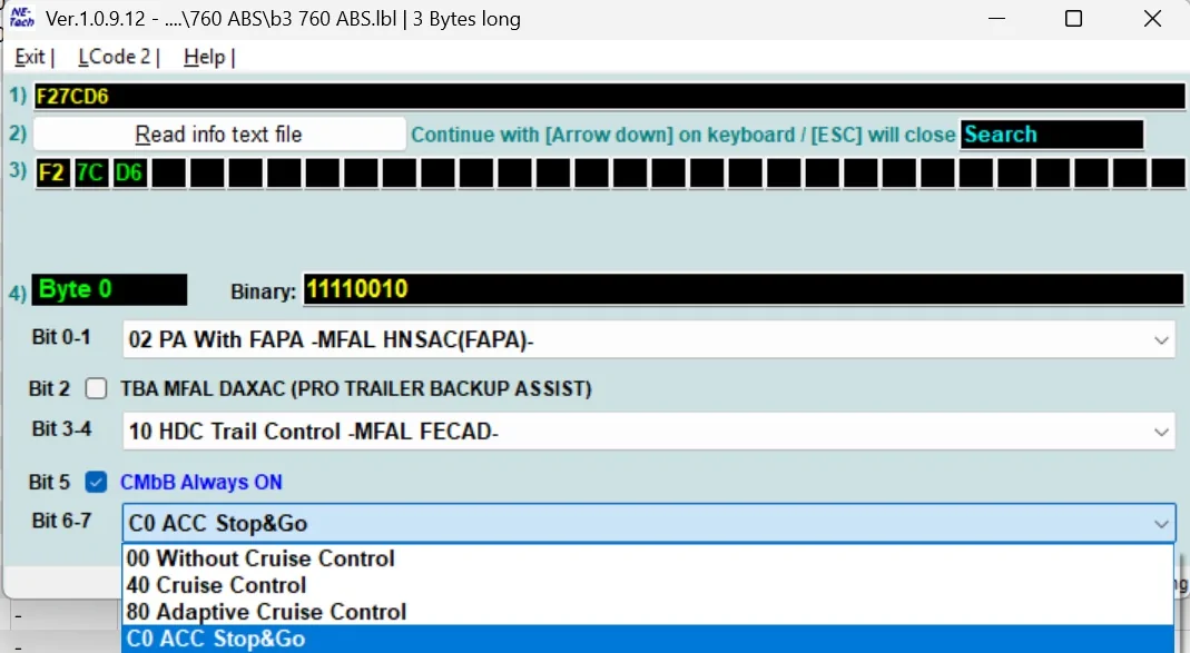

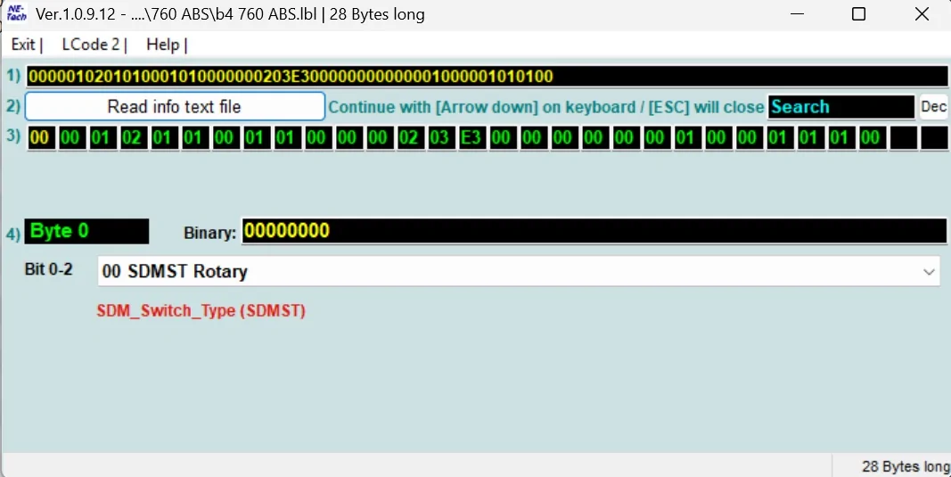

Use of LCode
- Open LCode.exe from the folder LCode
- Paste your codding i the row 1
NOTE: If you use not merged data you need to repeat pasting from very row at the end of previous row already pasted. It can cause some errors so I strongly suggest to use excel formula for it
- click "Read info text file" and choose label corresponding to your codding.
NOTE: Labels can be found in folder "../labels/[module number] [module name]/" IF ALREADY EXIST. Every block has its own label since for some modules (Ex BCM) would be to long.

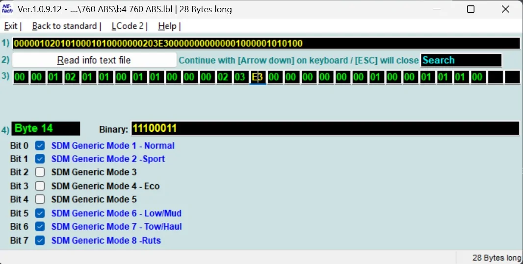

You should se this (as example I used ABS block 4):
Ford Ranger Ranger 6G FORScan data decoding tool(s) project 6
1) coding pasted and future changes
2) button for label loading - some help - search box, can be used if you are looking for some particular name of codding - switch between HEX and DEC view (not useful for us)
3) codding separated by Bytes
4) number of Byte you see now (starting with "0") - binary view of this Byte
5) codding visualization
You can choose Byte by clicking on it or just use keyboard up/down for next/previous Byte.
Ford Ranger Ranger 6G FORScan data decoding tool(s) project 7
In codding visualization You can see:
- drop down menu - if this byte contains more codding for the module, You can choose it from it and see the result. Drop down is mostly used if can be choosen only 1 option of many posibilites.
- check box - setting like ON/OFF for single function/option - read description since some options are reversed (ex. unchecked for ON/active)
- red line - just comment. If there was a space for it, I added some explanation or better description of the option
Search can be use for function name as well as comment. No need to follow characters size. As soon as it done it's job, it will point result in light blue color on Byte codding in row 3)
Hope this post cover all scenarios of use but in any questions, just post it here or send me PM.
PS. At the end of 1st post of this thread, I put also screanshot of super mixed Byte.

     NOTE:I will keep typology of folders as XXX YYYYYY where XXX - number of module in Forscan, YYYYYY - shortcut of module name
        - b2 760 ABS.lbl - label file of ABS block 2 codding
        - b3 760 ABS.lbl - label file of ABS block 3 codding
        - b4 760 ABS.lbl - label file of ABS block 4 codding
     NOTE: block 1 in ABS is VIN number so no way of decoding it in LCode. Instead in codding calculator i implemented HEX2ASCII which decodin VIN characters. I also added information of in which module VIN is avaliable.
- LCode - folder with LCode software.
    - LCode.exe - decoding software
    - LCode.ini - configuration file for LCode. not sure if need to download as well.
- sample - folder with sample file for easy uderstanding of how it is working as well as for anyone who would like to help in my work
    - ABS.abt - sample codding from my vechicle without VIN coded in it. standard file generated/saved by ForScan is saved in the way: [VIN - 17 characters]_[module short name]_[date 8 dig YYYYMMDD]_[local time of save 6 digits HHMMSS].abt
     NOTE: .abt file is text file with different extension so it is possible co open and/or edit with any text editor (ex.MS Notepad, Notepad++ etc...)
    - Ford Ranger 6G codding calculator_sample 760 ABS codding.xlsx - codding calculator with some extra data to see the way I decoded it using data from FORScan - (2024+) 6G Ranger.xlsx
    - FORScan - (2024+) 6G Ranger.xlsx - file downloaded from ranger6g.com forum. I strongly suggest to use newest version from google docs/drive.
    - sample. lbl - label with some extra comments and information for easy understanding for those who would like to help with prpering labels of other modules.

I like that drop down version you were going for on top. Looks cool
m3iaz
Michal
Oct 4, 2024
26
Poland
EU RR '24.5 3.0 BlueLighting 422HP
Drop down is useful if more than 1 BIT is affected by codding (ex. Cruise Control has 4 options and 2 Bits).
If option is only ON/OFF or Enabled/Disabled it mostly takes 1 bit and checkbox is better and lbl preparation is faster
