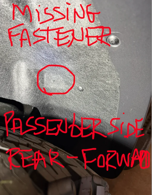

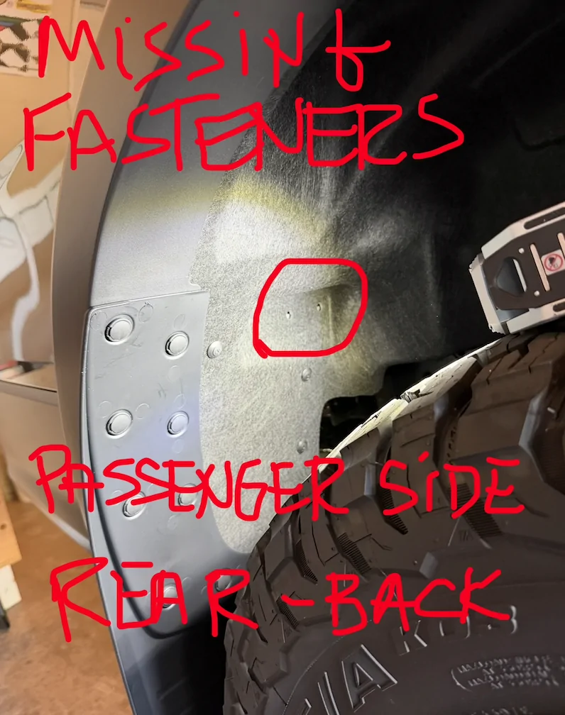

1) The rear passenger side wheel well liner was loose.
Three fasteners were missing.
One on the forward side.
Two on the back side.

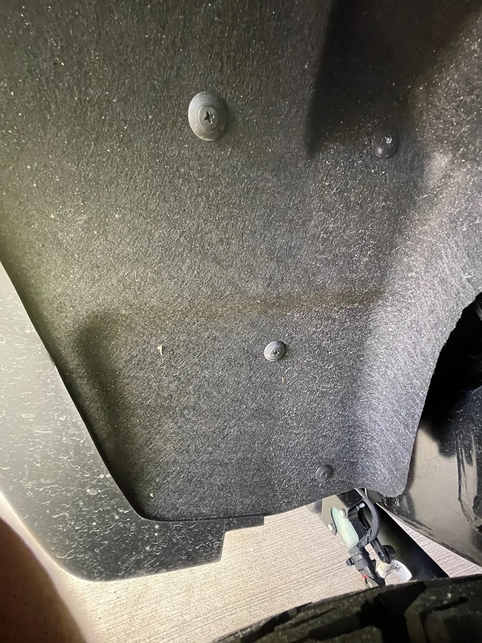

2) The driver side wheel well liner was secure. However, it had steel pop rivets in the same locations as the passenger side empty holes.
The rest of the fasteners used inside the wheel wells are all black phillips headed plastic rivets.

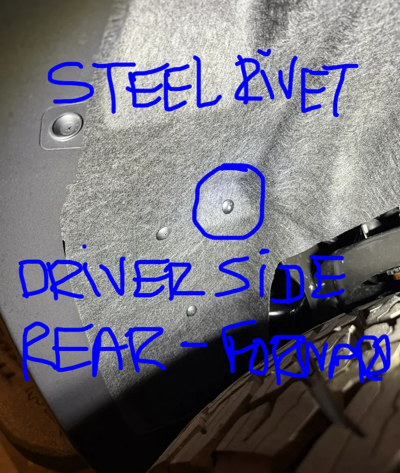

One steel pop rivet on the forward side.
Two steel pop rivets on the back side.

I took it to the local dealer and they installed three black phillips headed plastic rivets in the missing holes on the passenger side wheel well liner.

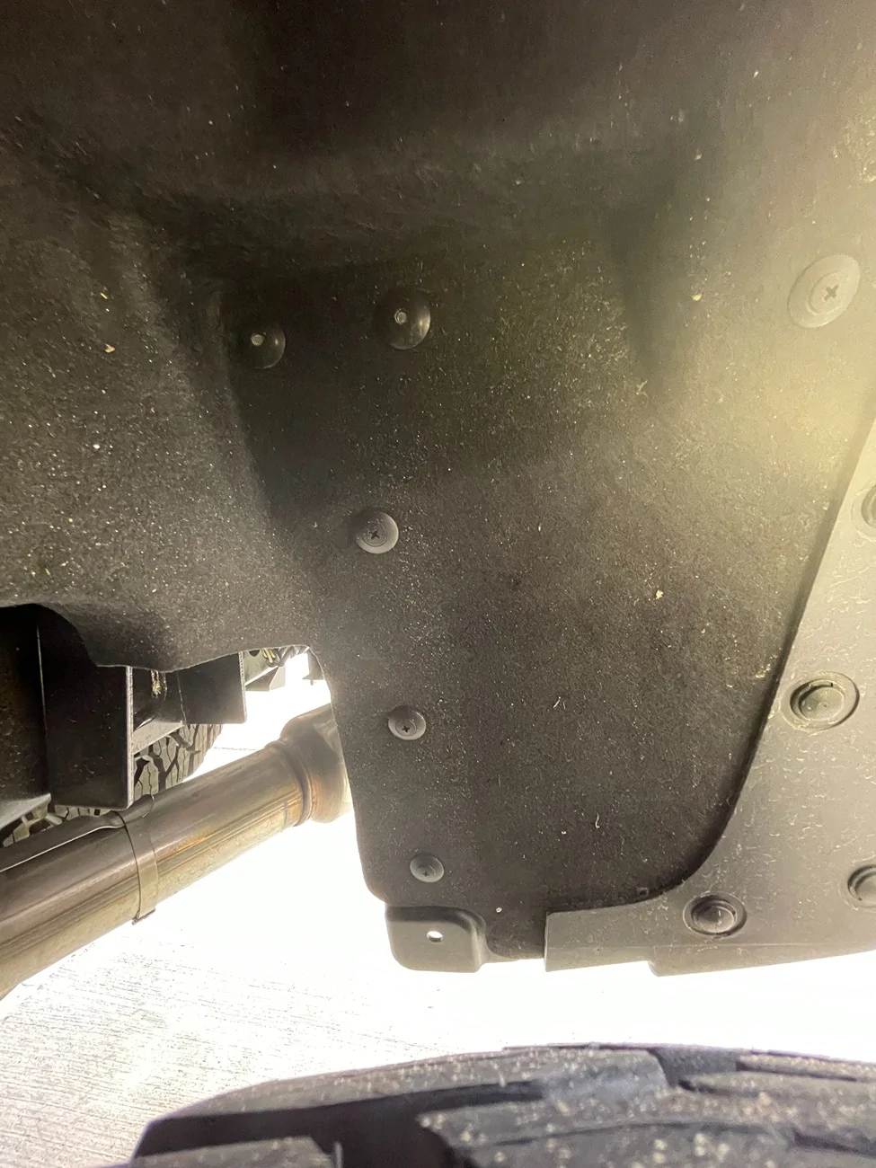

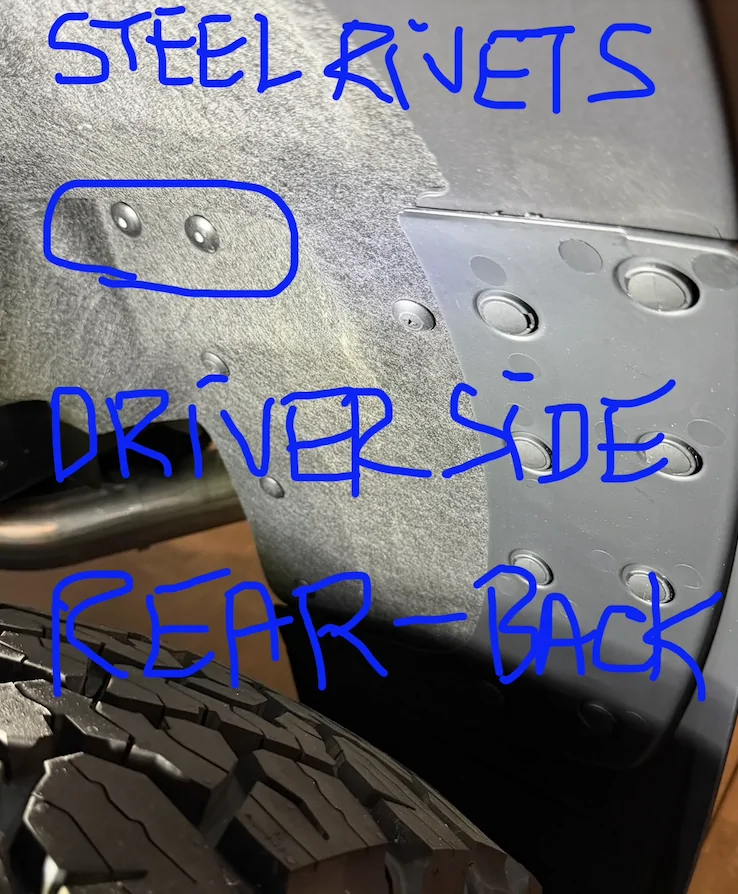

Here is the driver's rear facing rearward,
The top two on the upper left are steel; the others are plastic:
Ford Ranger Ranger Raptor May 2026 Build - Both Missing & Steel Pop Rivet Wheel Well Liner Fasteners IMG_6712
Here is the driver's front facing forward.
The upper right one is steel; the others are plastic:
Ford Ranger Ranger Raptor May 2026 Build - Both Missing & Steel Pop Rivet Wheel Well Liner Fasteners IMG_6713
Both drivers and passenger's side are the same.

If the dealership replaced the ones that were missing that were supposed to be steel with plastic ones... they screwed up.
The plastic ones have very little holding power compared to a steel rivet.
Chippewa76
Feb 22, 2026
Midwest
Ford Car, Truck, & SUV
Maybe so. But the Tech that worked on it, said the fastener type wasn’t called out on the drawing he had access to.
The real issue started with non-installation of the steel pop rivets.
I do not know the design intent of placing steel rivets in those locations.
Quite frankly, as caustic as the winter road chemicals are that are used on the roads here in Wisconsin, I would prefer plastic/composite over untreated steel if at all possible.

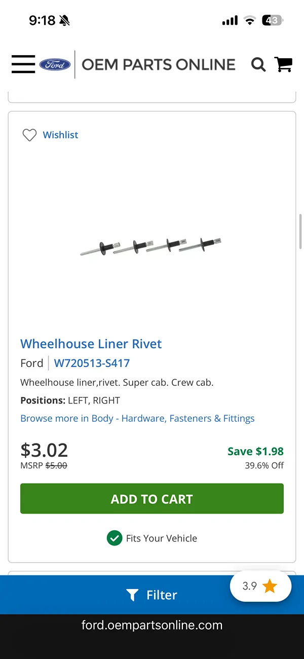

Bluestra1n
Aug 31, 2025
Pennsylvania
2025 Ranger XLT 2.7
I was missing steel rivets on my 25 xlt. Got a dealer to install them at no charge when I was in for another recall. At least for a non-raptor, they are the only steel rivets in the fender. Everything else is scrivits or push clips. The part is called a “wheel house liner rivet”. Could be a different pn on a raptor, but I doubt it.
