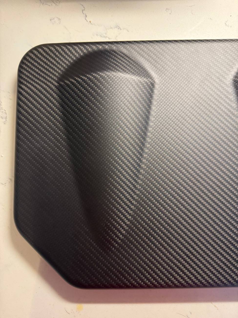

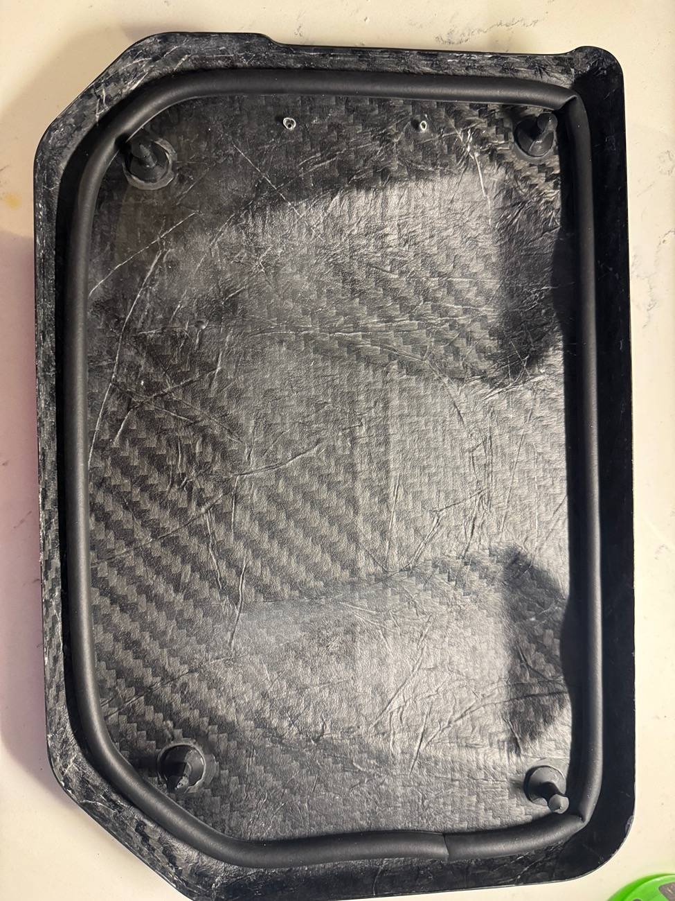

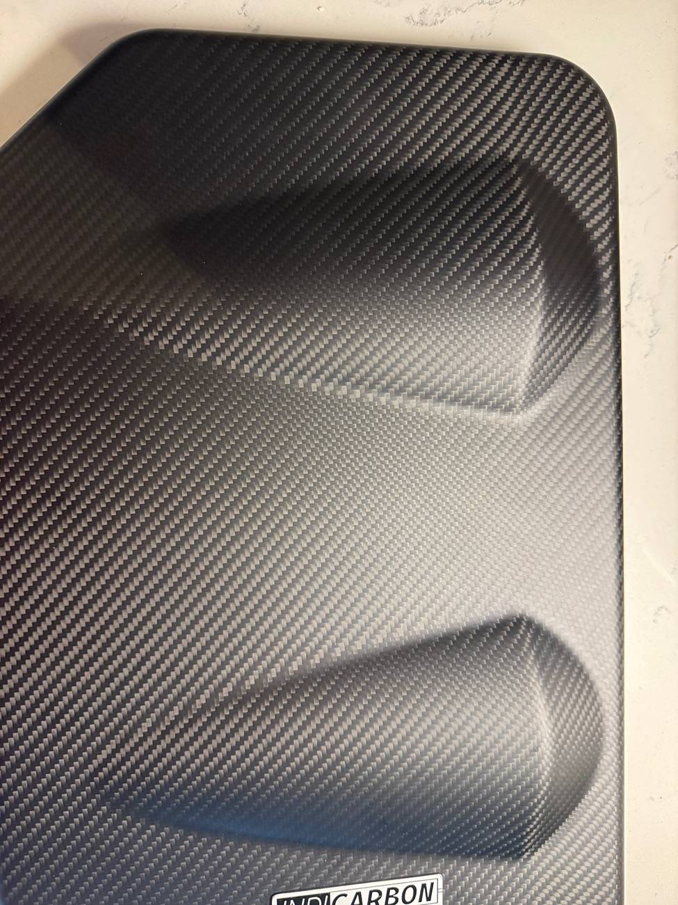

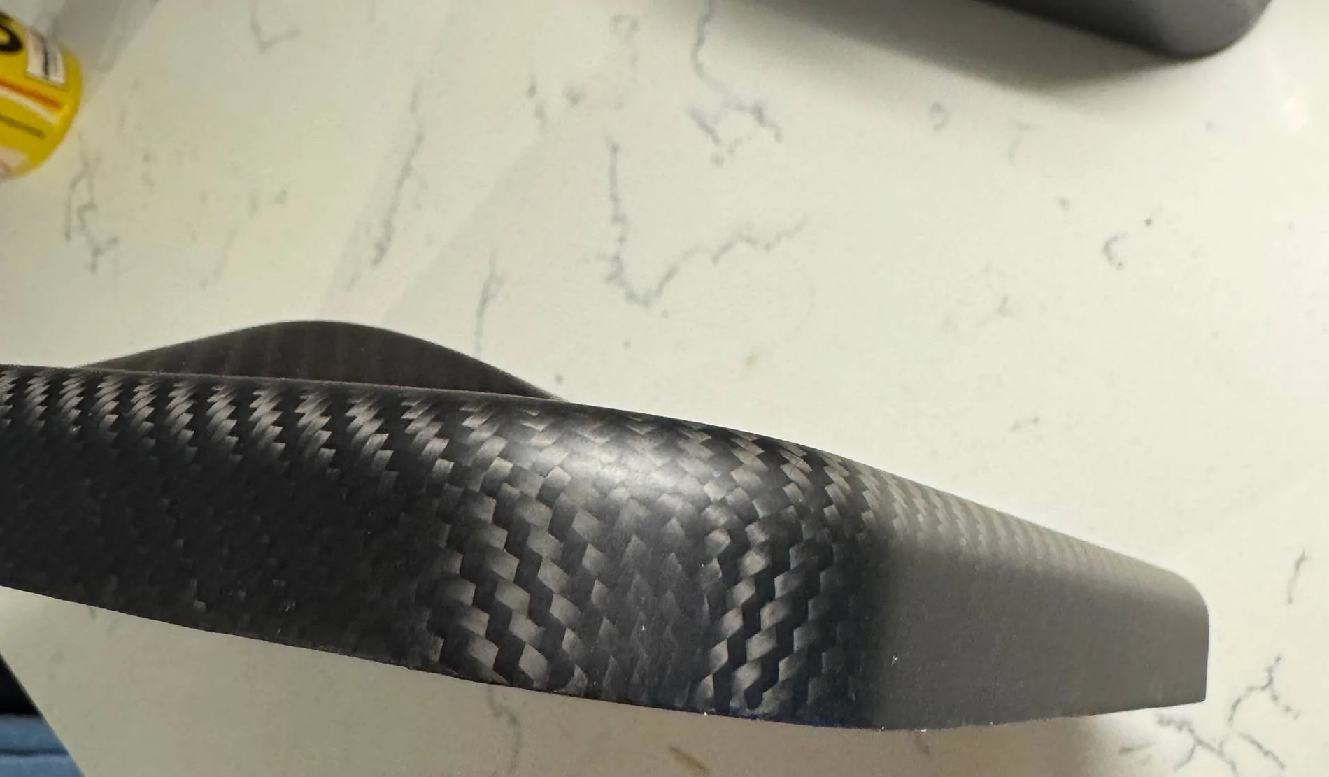

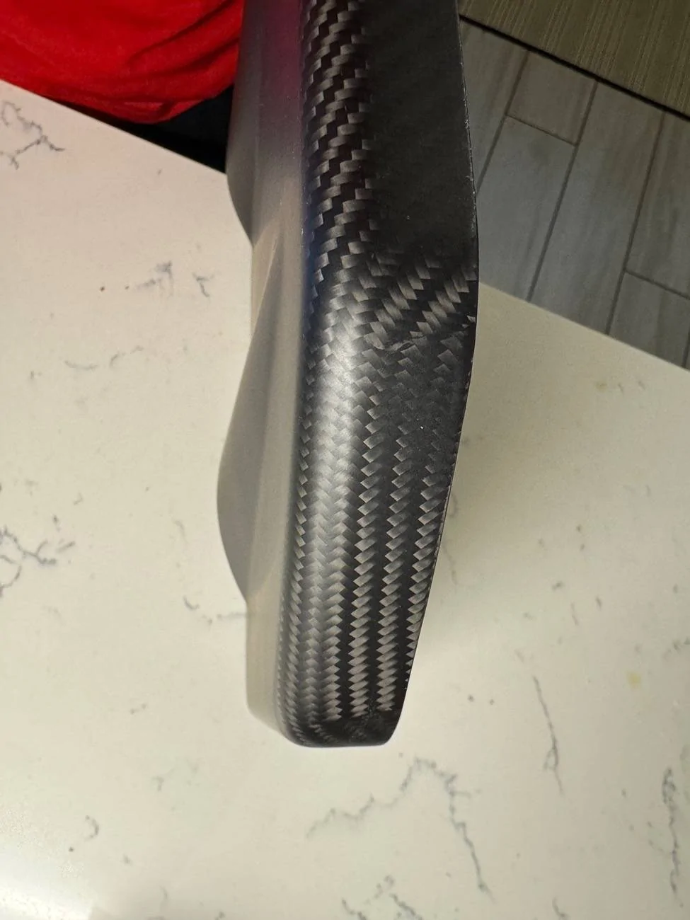

If anyone on here as any expertise or opinion on carbon fiber I would like your thoughts. It’s meant to be a piece of an air intake. Can’t quite tell if this is real, totally fake, or maybe carbon fiber layered over fiberglass or plastic? Any thoughts help!

Appears to be real. It’s dry carbon (no gel coat) and looks like it was vacuum molded based on the imprints on the underside. Can see the weave well enough to think it is not faux CF.

I've been looking into the IndiCarbon kits also. I think these are real. Other carbon fiber trim and parts I've seen that are fake didn't have a visible weave on the underside of the part and seemed to flex easily like a hard plastic would.

It‘s real CF. It’s not FRP OR FRPCF.??
