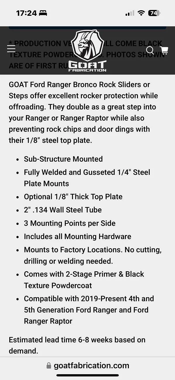

Not attempting to burst anyone’s bubble here but; Aren’t real rock sliders consistent with frame mounted, instead of chassis mounted?
Seems that if you bounce them off a rock, mounted to the chassis, you’re going to have a problem bending the chassis, which is not what you’d want to do???

I had to go look it up. It states it mounts to the factory locations. Not sure what that picture is showing. I grabbed it from the internet to show what they look like on the rig.
Deleted member 9086
Factory locations are on the chassis, not the frame……this is why I questioned them as being real rock sliders. That I’m aware of, real rock sliders mount to the frame, not the chassis as I understand.
if you hit or bounce them off a rock, they‘re intended to bend, not the frame or chassis.??

That's correct. Real rock sliders mount to the frame because the frame is the strongest part of the vehicle. Not the chassis. Like it says from the webiste, from the picture above, it's only good as a side step and preventing rock chips... So these are just side steps that look like rock sliders. I wouldn't slame on these onto a rock or use it to pivet off of boulder rock. Just get real ones from Hot Metal Fab.
