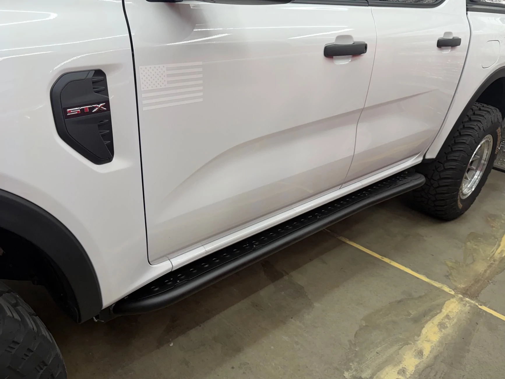

Stock rails 16.5lb each. Rci rails 75.9lb each. Total extra weight 118.8lb
Well, you could save 18 pounds by buying $1000 worth of aftermarket wheels....

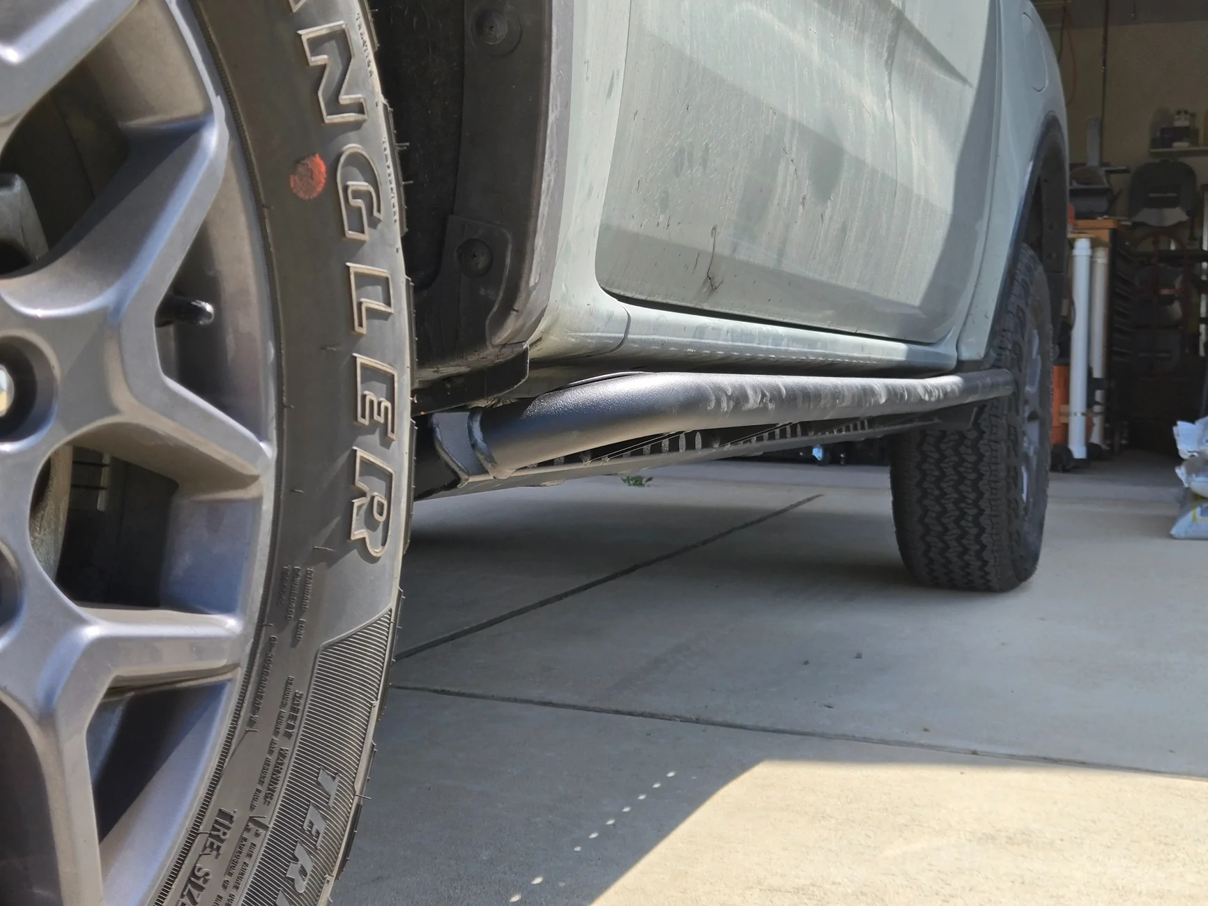

Nice!

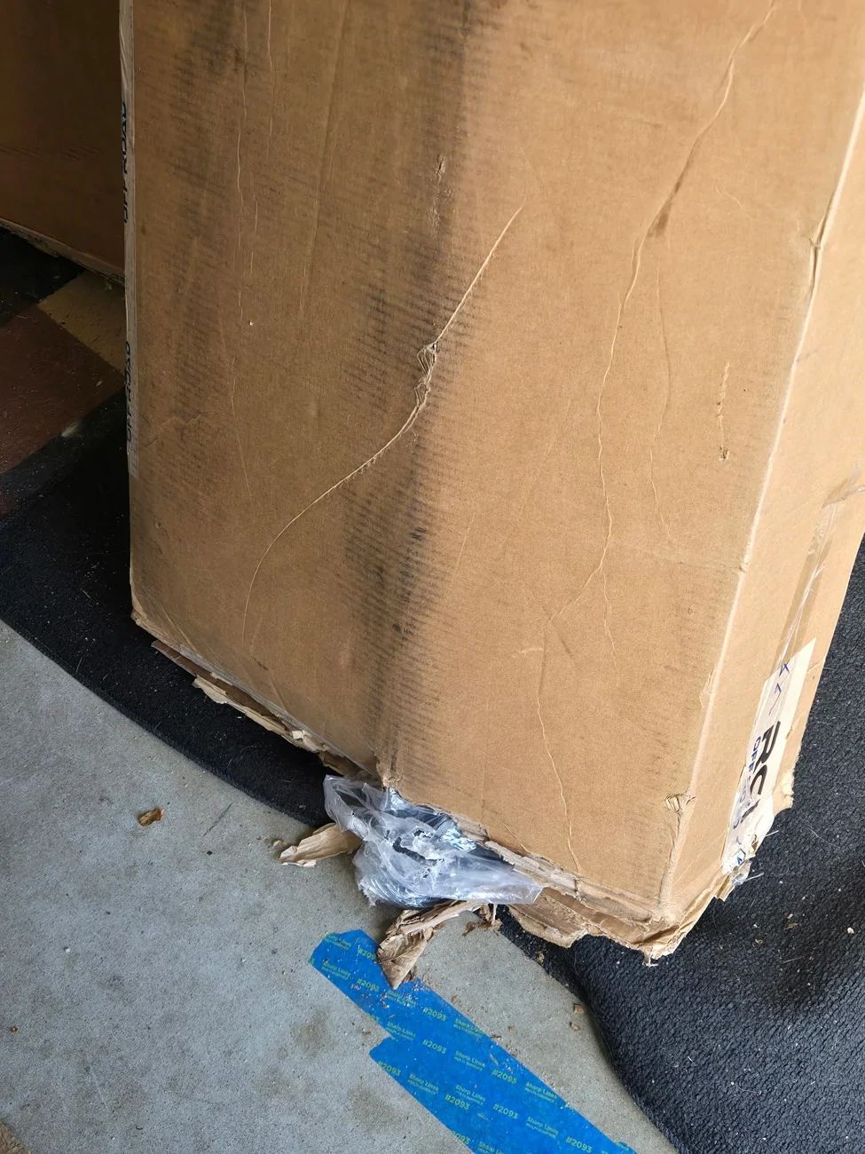

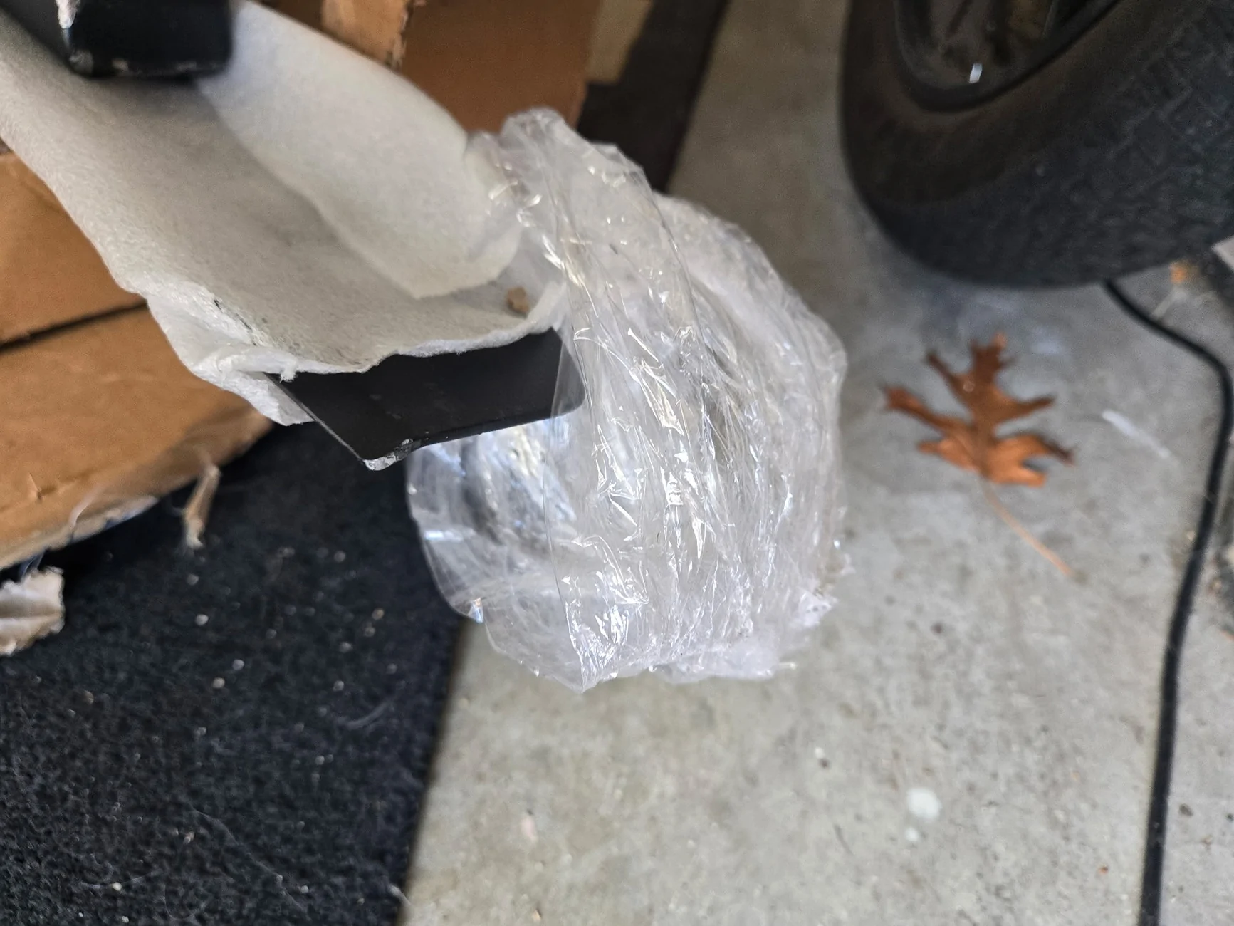

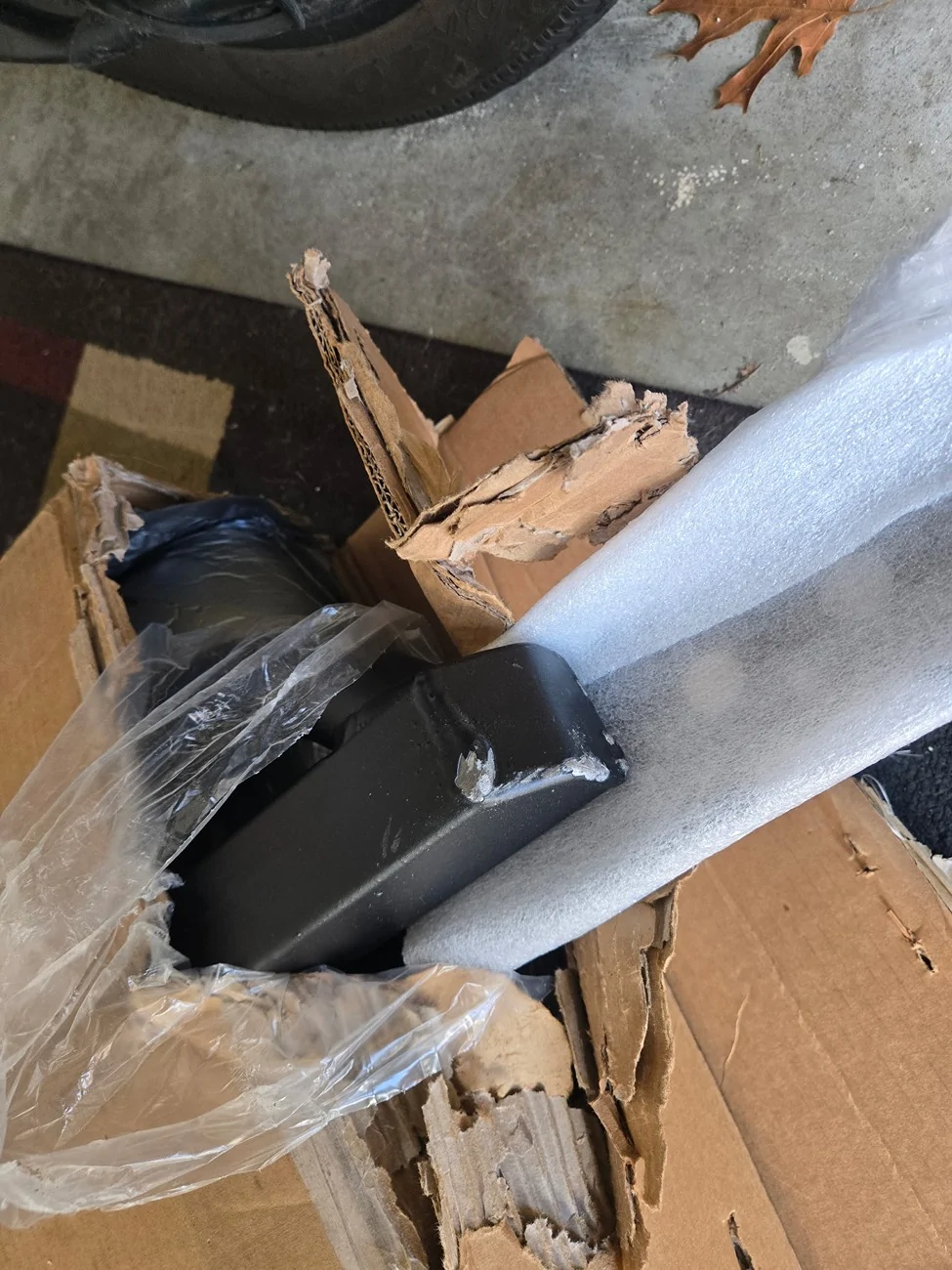

After my week and a half wait for fedex to finally deliver mine….because they obviously had beat the piss out of the boxes,and had the one with the hardware in it come open,mine showed up.One showed up on one day,then 2 days later they delivered the second one.(thought for sure the second one was going to be a no show…..)
Luckily my sliders were beat up on the ends,so nothing a little paint won’t take care of,and all of my hardware was there….

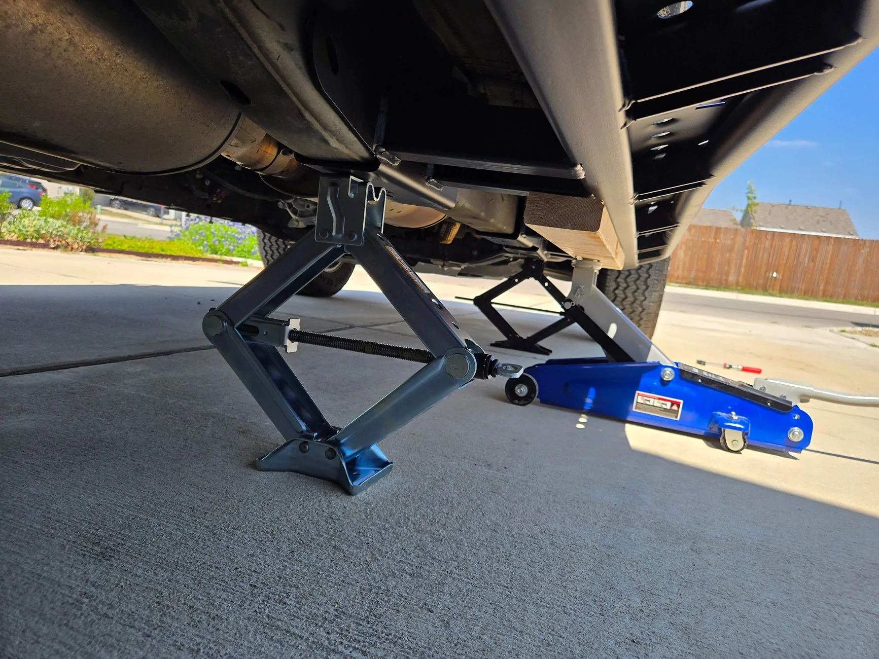

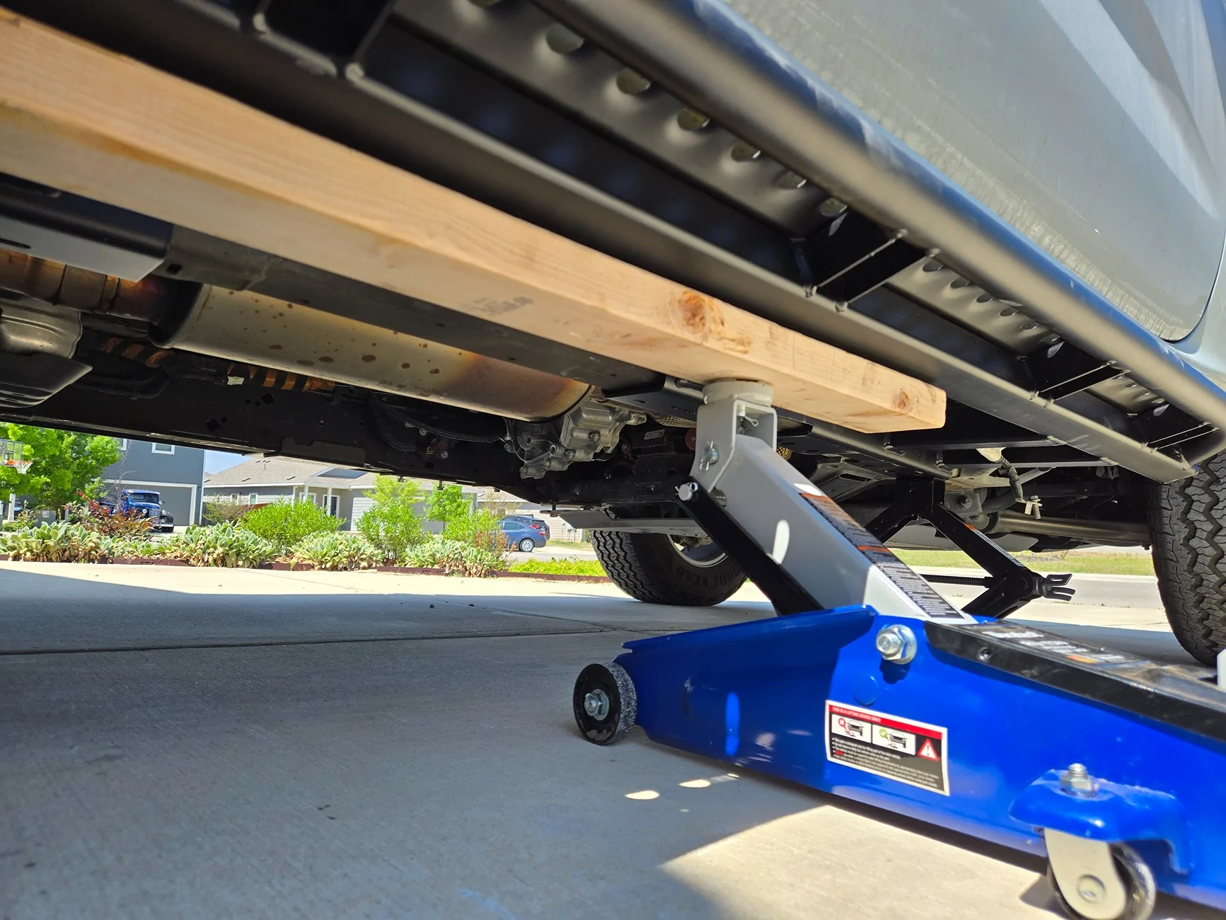

I installed them yesterday,and it took about 3 hours flying solo.
Jack stands and the factory scissor jack were perfect to get them up and in place.
I’ll get more photos later lol
My old ass was worn out lol

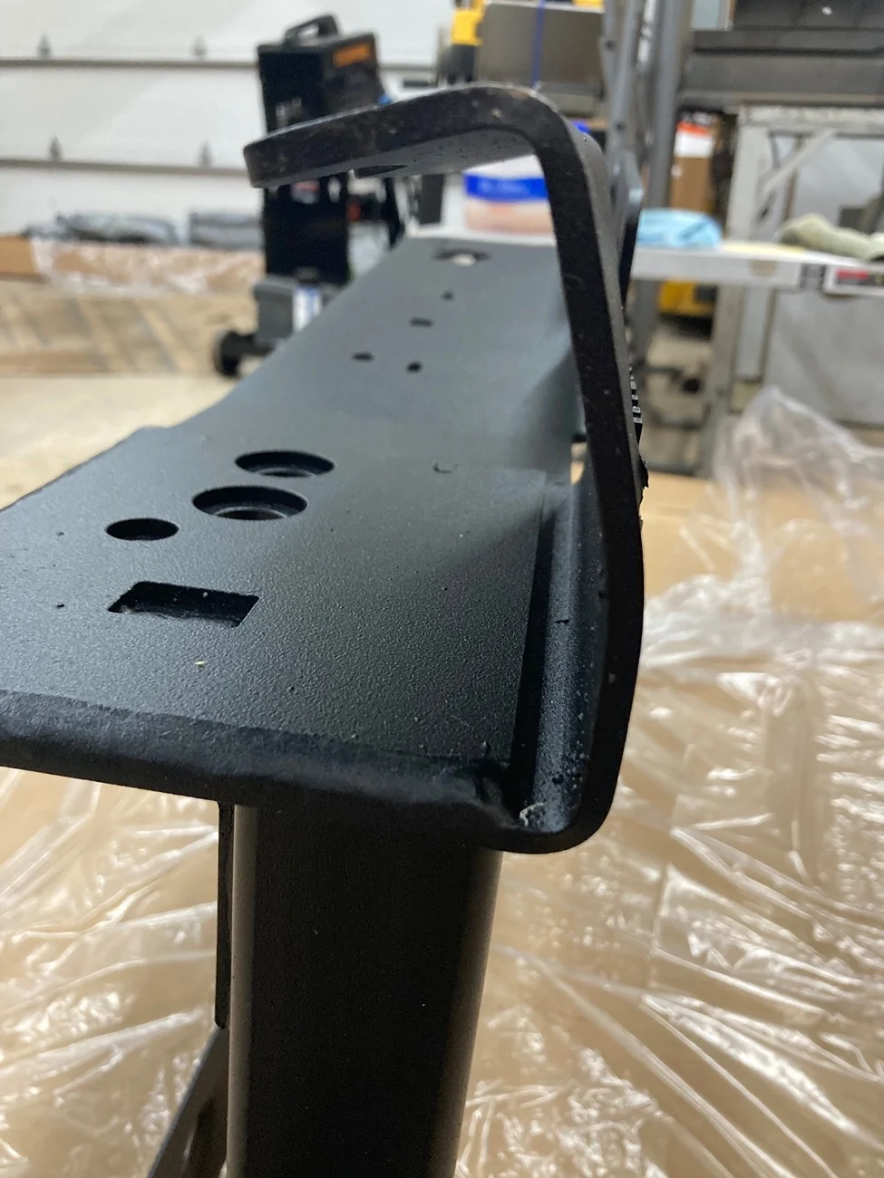

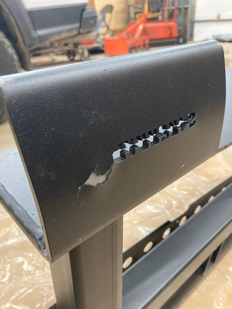

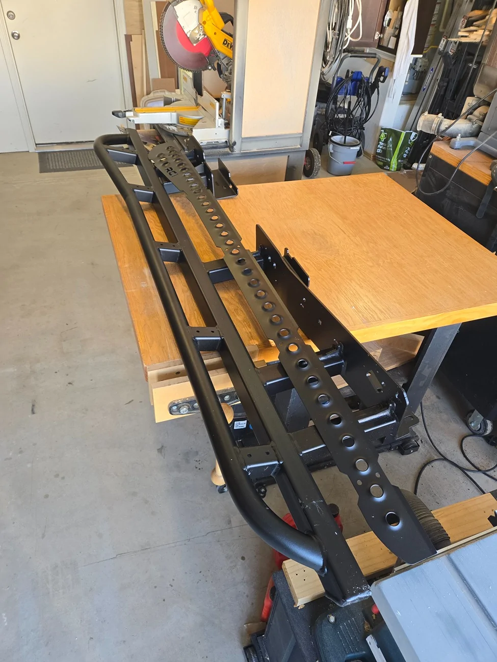

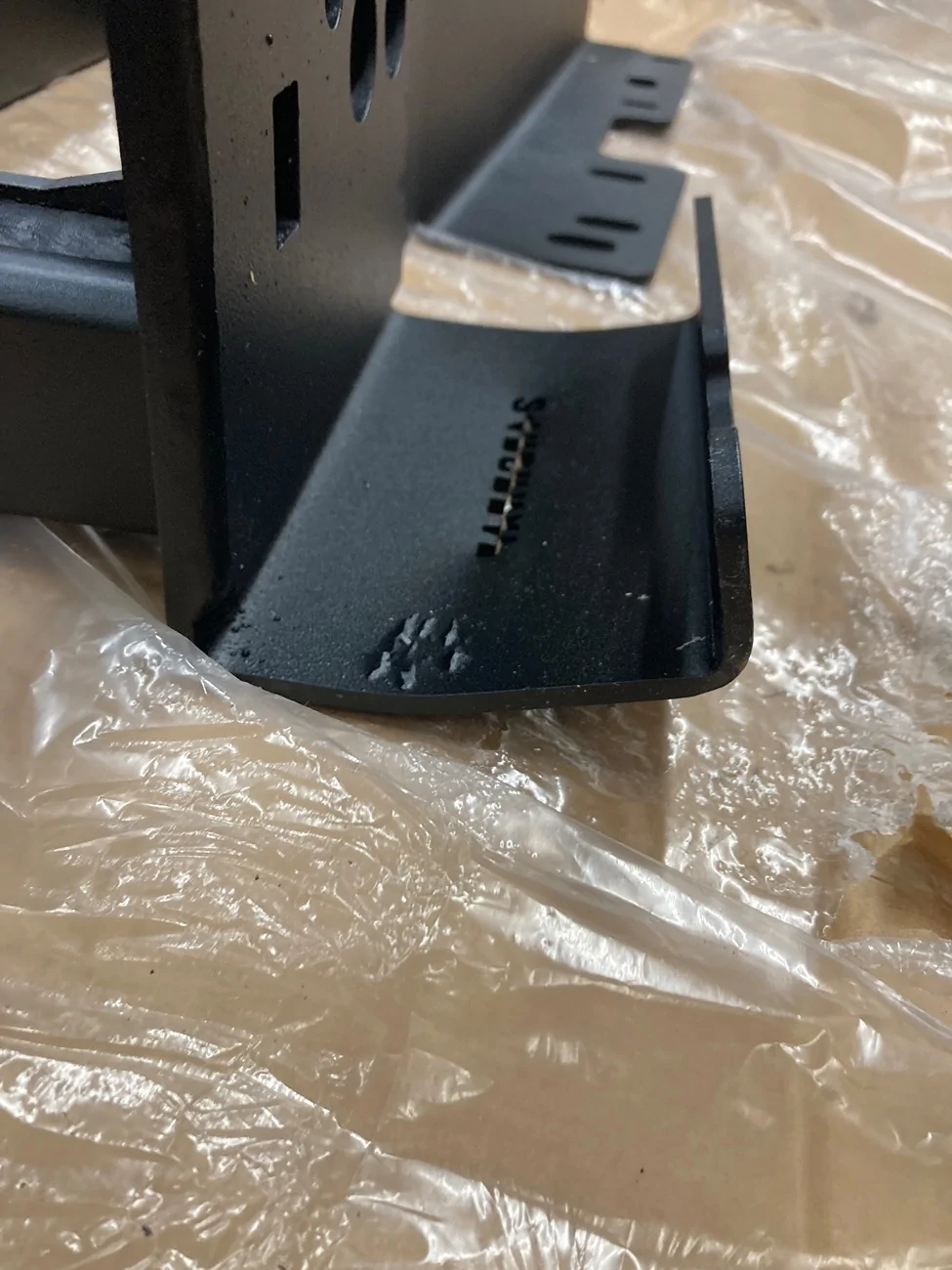

Mine came bent at the part that wraps around the bottom of the frame. I just took a sledgehammer and a block of wood to bend it back. Probably wouldn’t have happened had they not cut branding words out of the metal right there. It was definitely the weak point because that is right where the bend occurred.

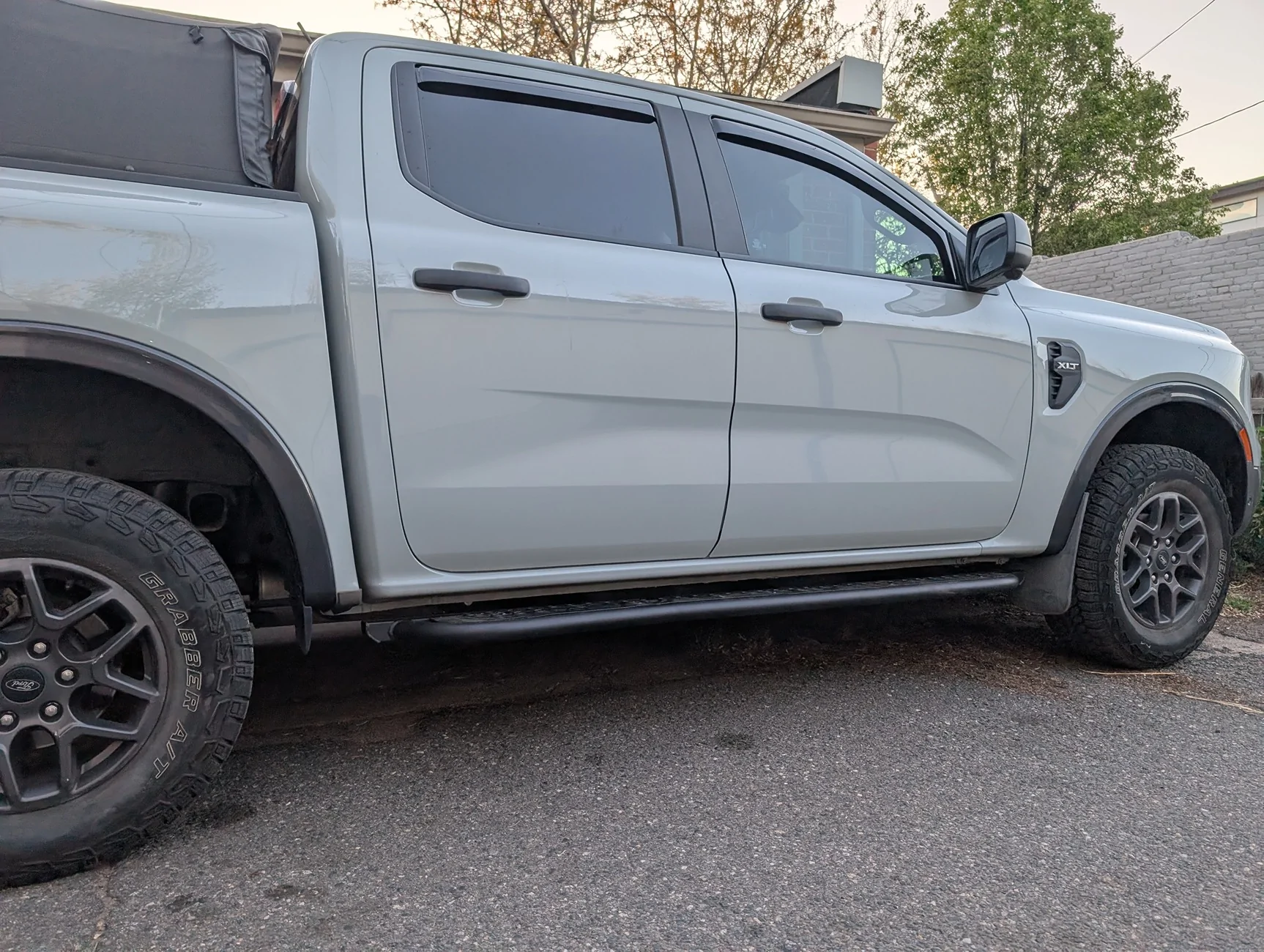

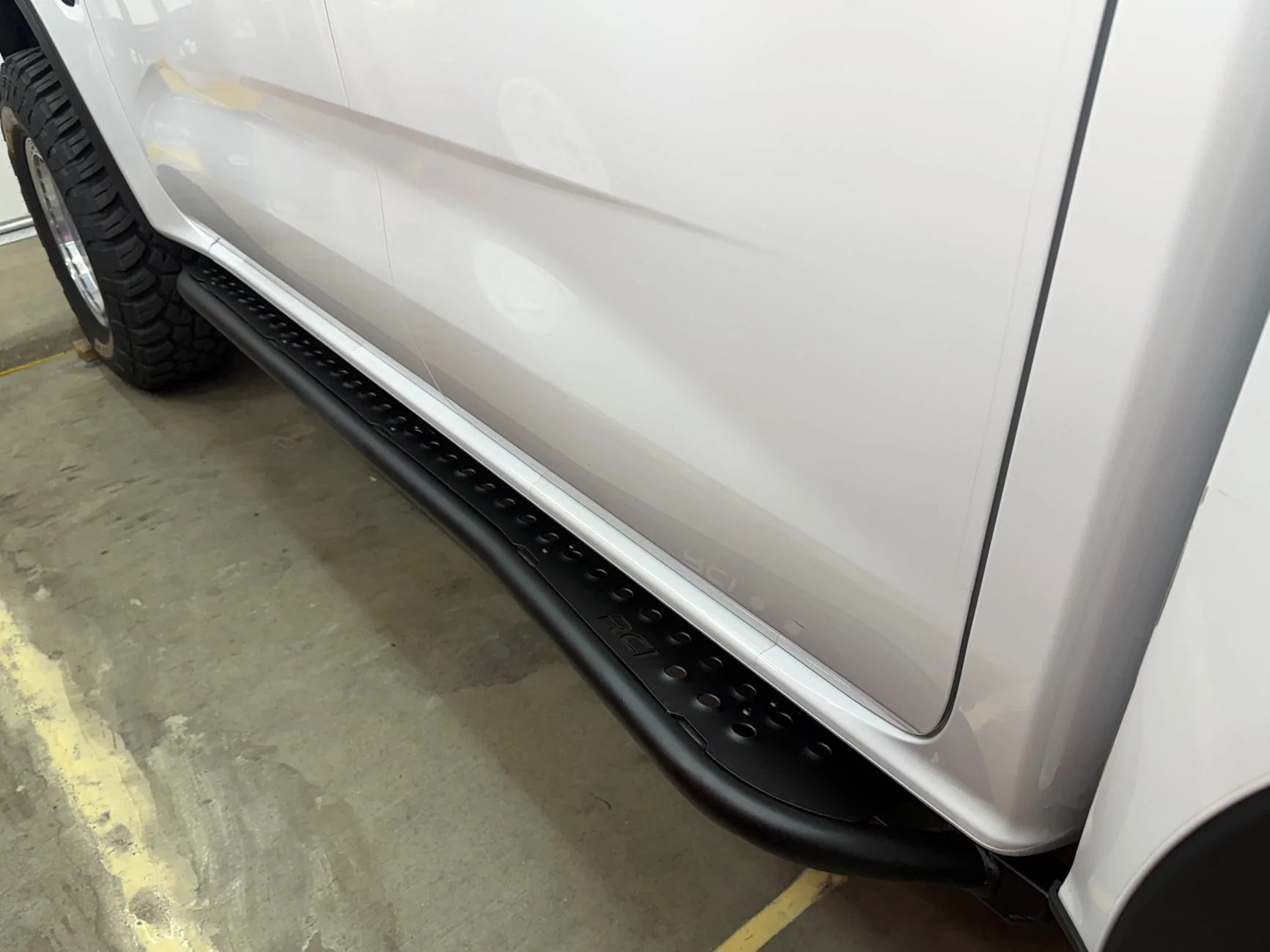

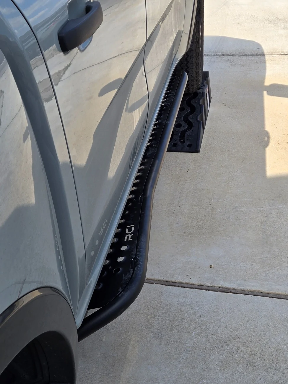

Finished up my slider install earlier this evening. 20 degree with tread plates.
For anyone installing these, I highly recommend running your bolts through the MP2 brackets before dropping them in your frame. One of mine had a little burr on the thread that felt like it was cross threading.
Looking forward to installing the full RCI skid package in a few weeks when I do my engine, differential, and transfer case fluids.
