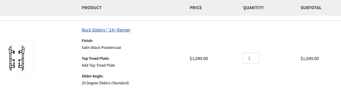

Sliders are live on the RCI site! Was not expecting the shipping to be as much as it is but will more than likely still order.
There's a Halloween sale right now if you click the link on their page. $250 off for the Raptor sliders
However living in Canada makes getting parts like this almost impossible due to shipping

Yeah my shipping wasnt much less than yours....$410 from Colarado to Seattle. Checked a competitors shipping rate for frame mounted sliders and it was 2xx someting. Might call them and see if they can pallet freight it for less than they want to send it with FedEx. I have a dock i can get access to.

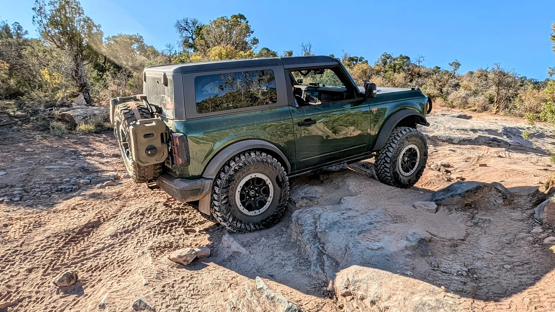

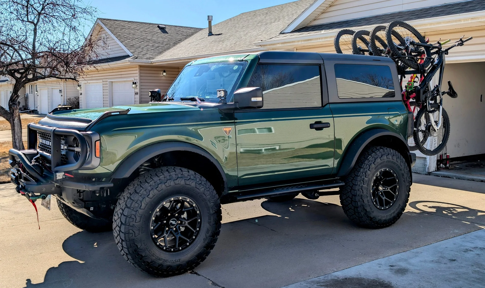

My Bronco bl sas came with body mounted rock rails. Gm come with body mounted. I believe jeep do too. I had oem rails on my Bronco at first. Now I have Turn off-road that are body mounted too.
