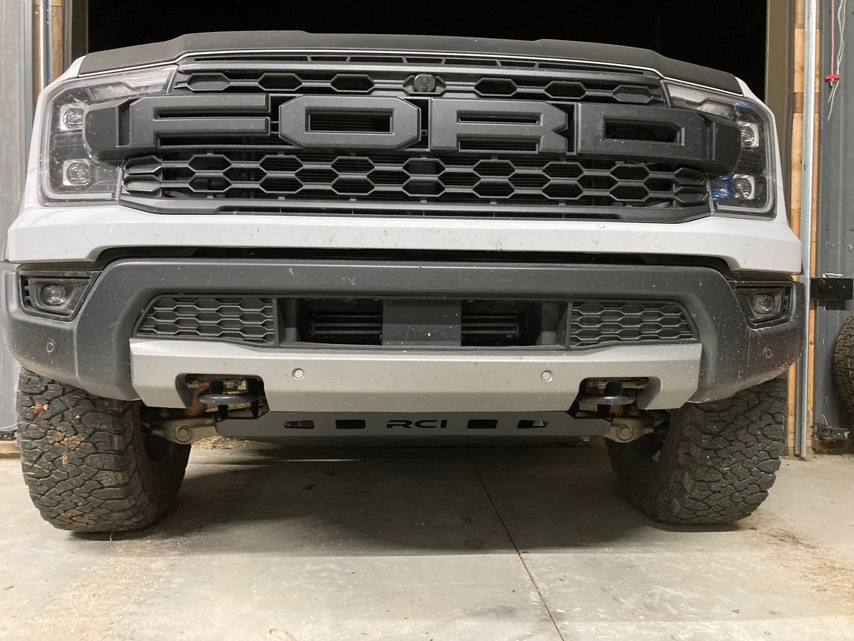

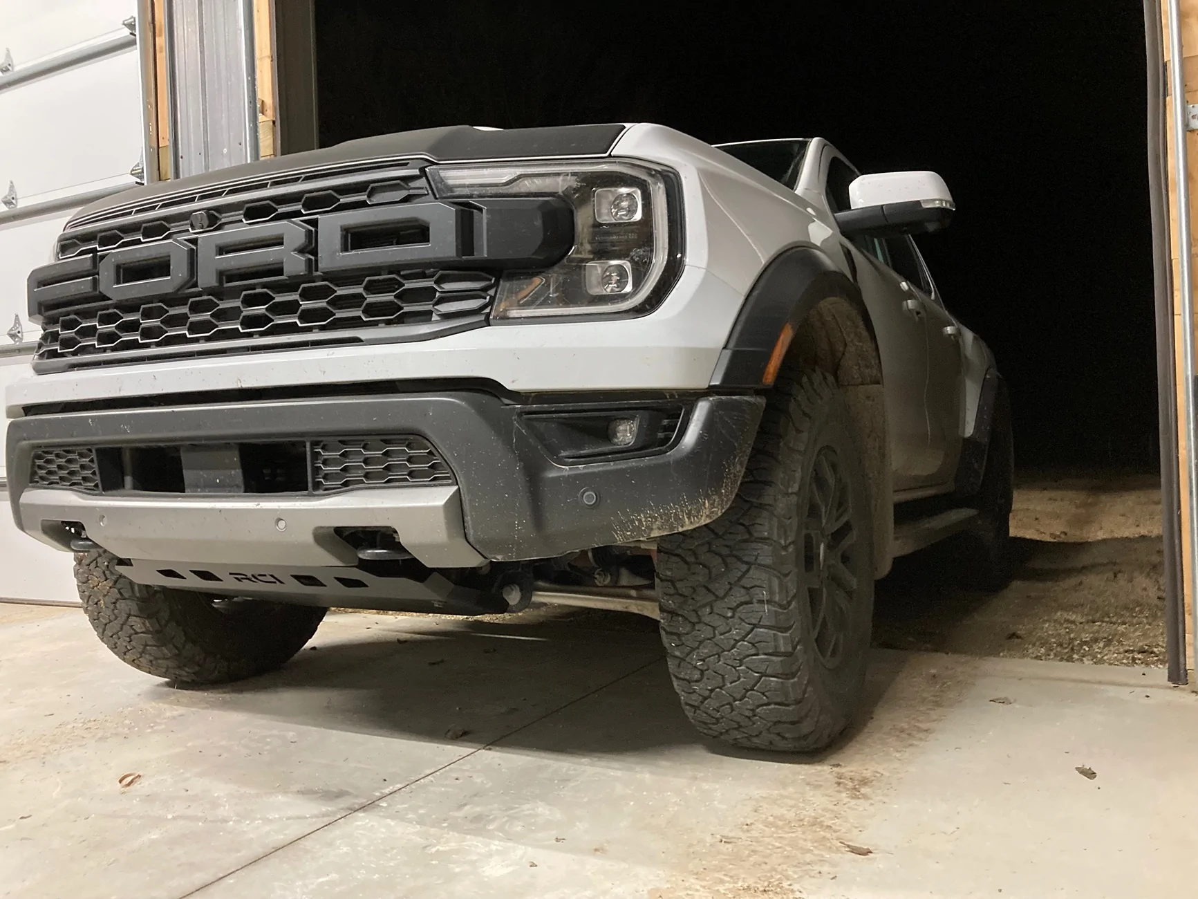

This is the correct one they are sending me next week👍🏻

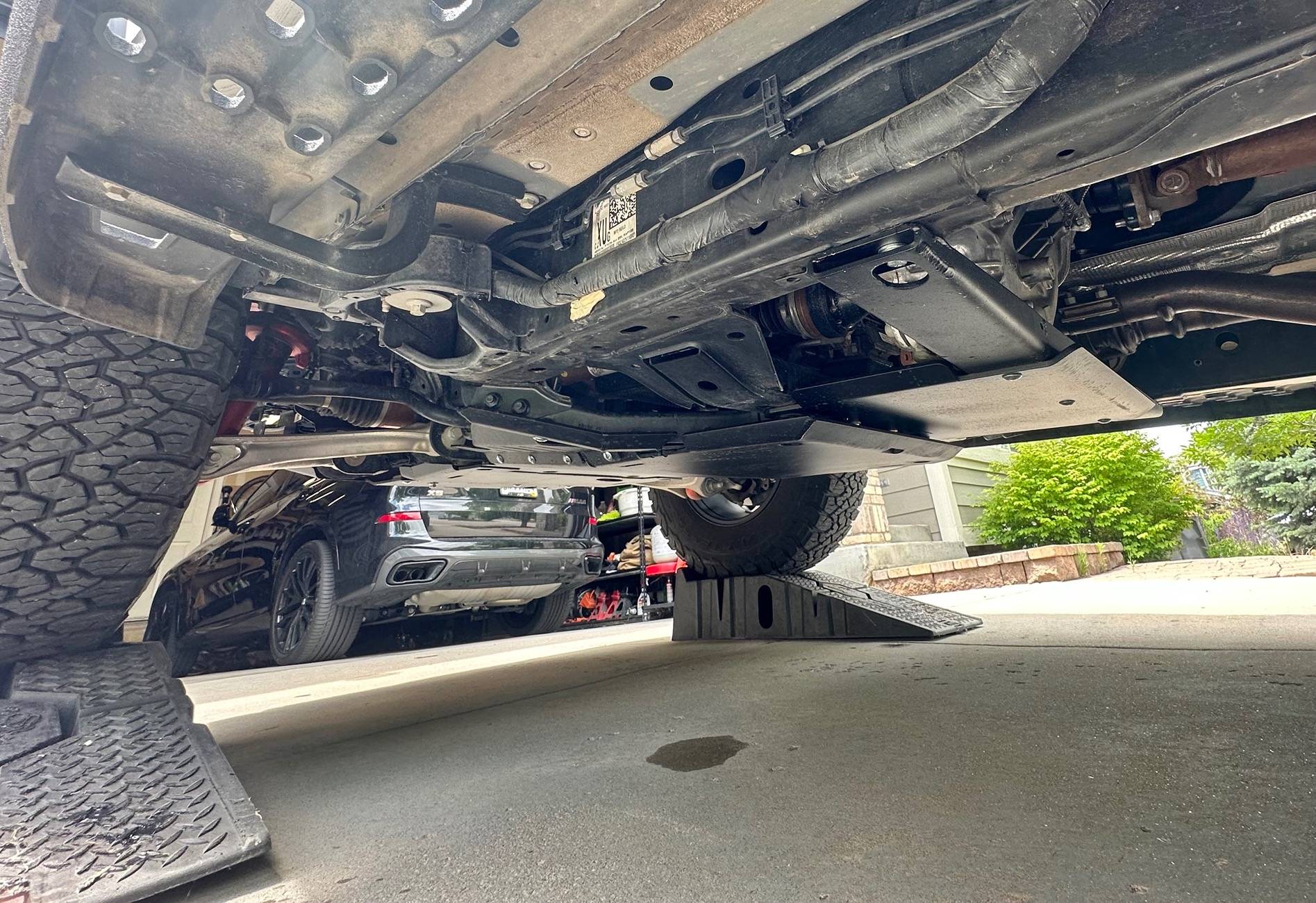

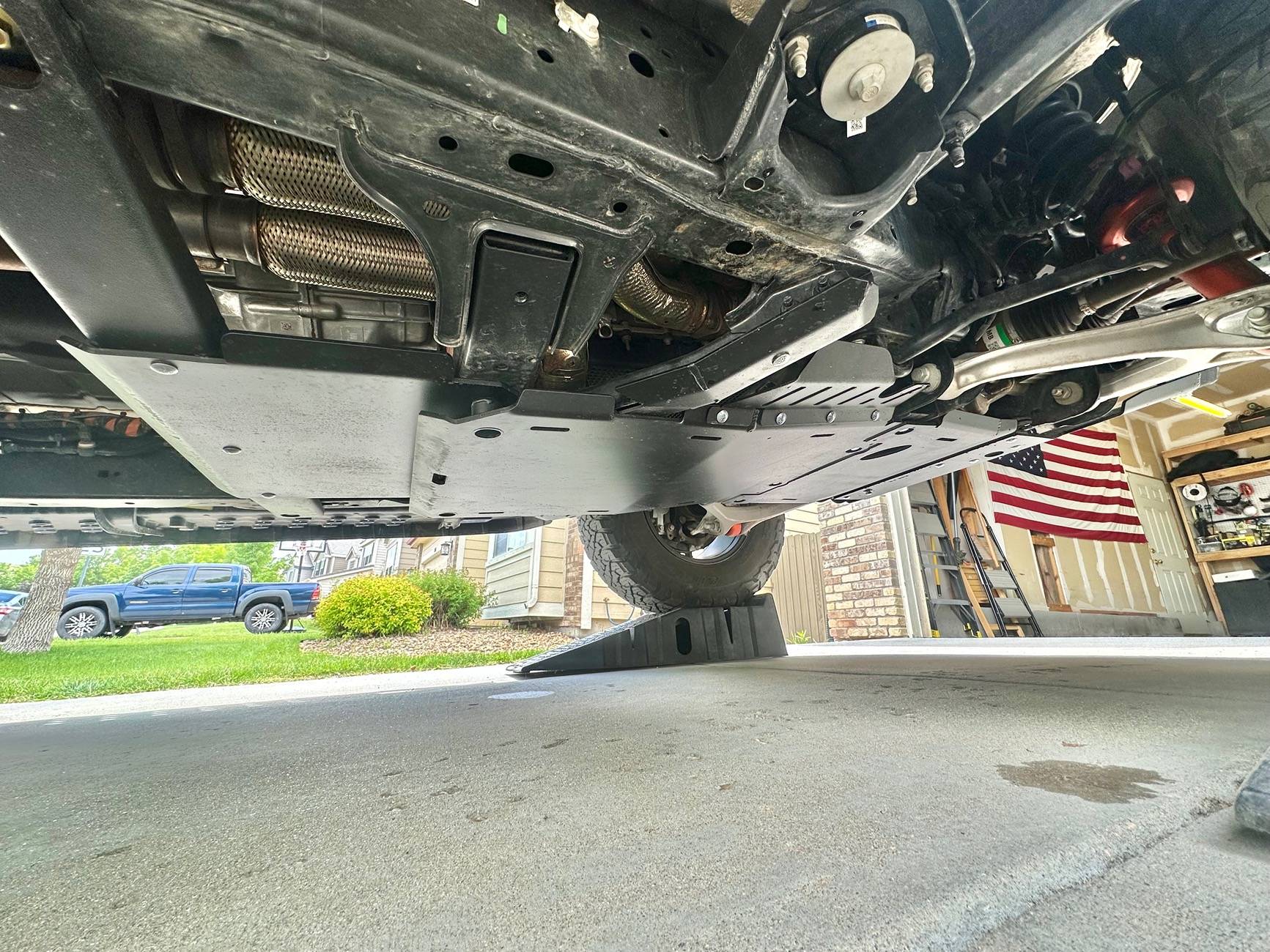

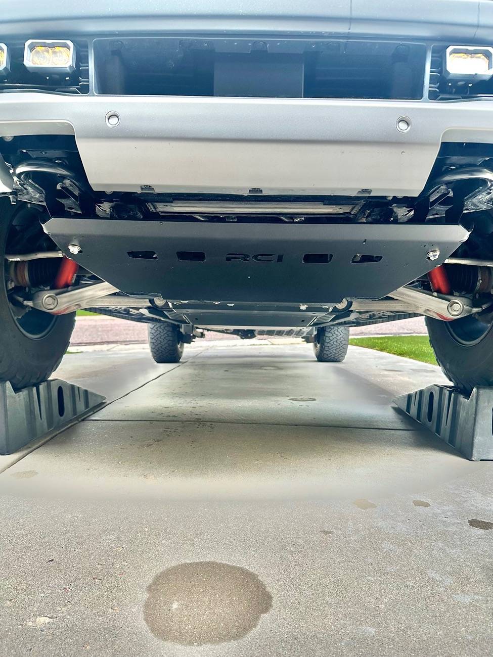

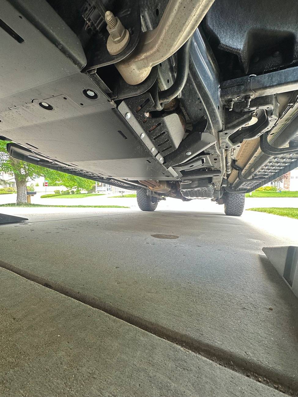

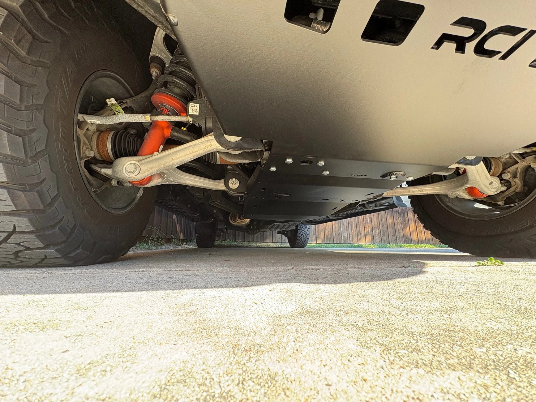

They now have a proper front skid for the RR. I’ve run both. They both have held up great from minor impacts. You will be less prone to bending the skids with steel, but obviously, there is a weight penalty. I also think the raw aluminum looks killer in person.

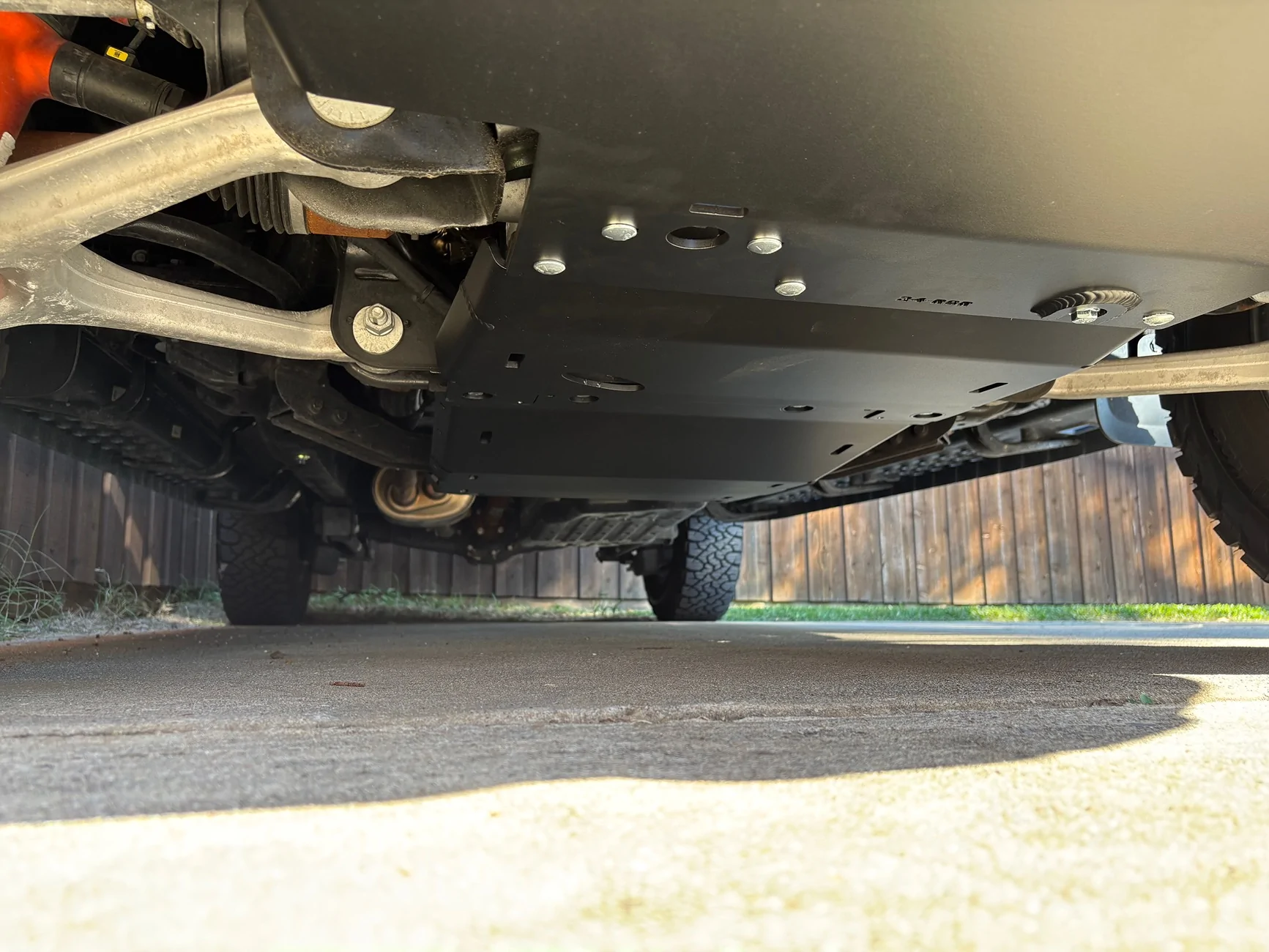

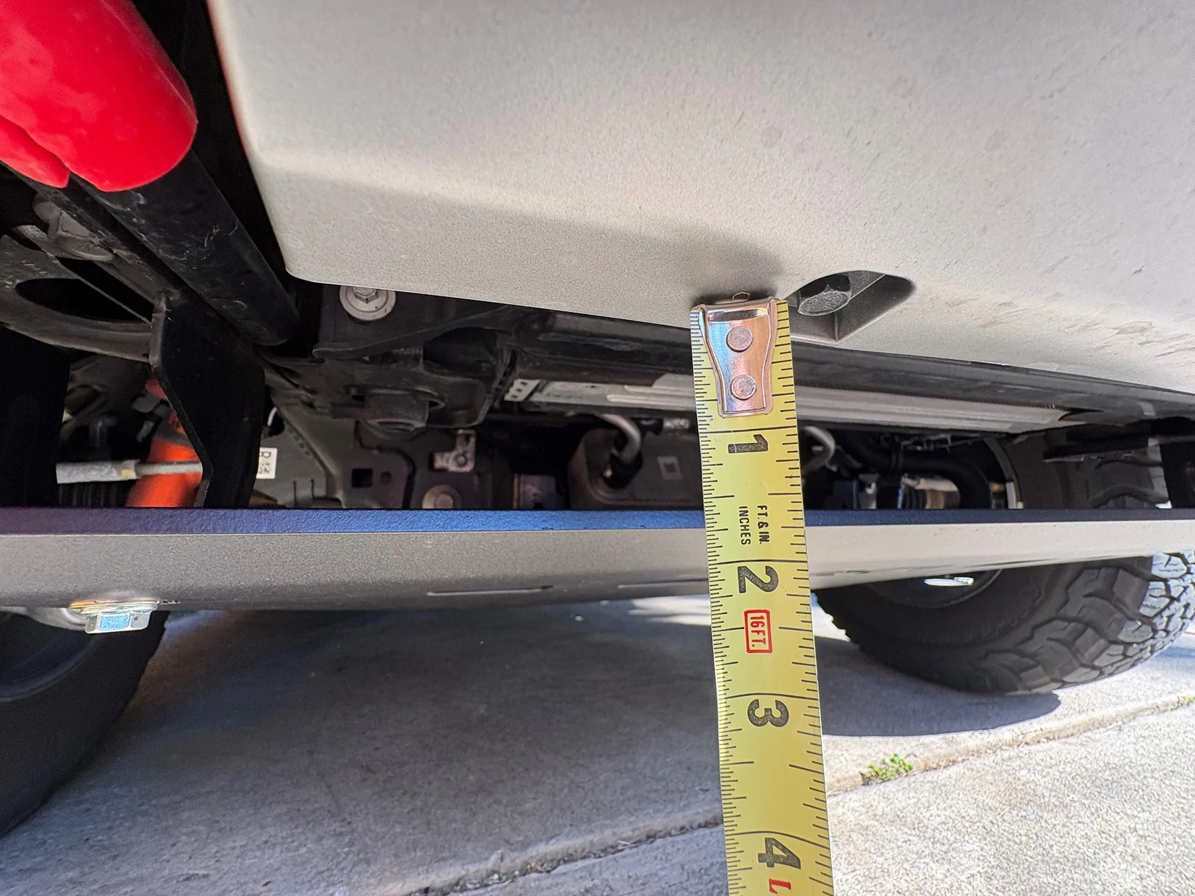

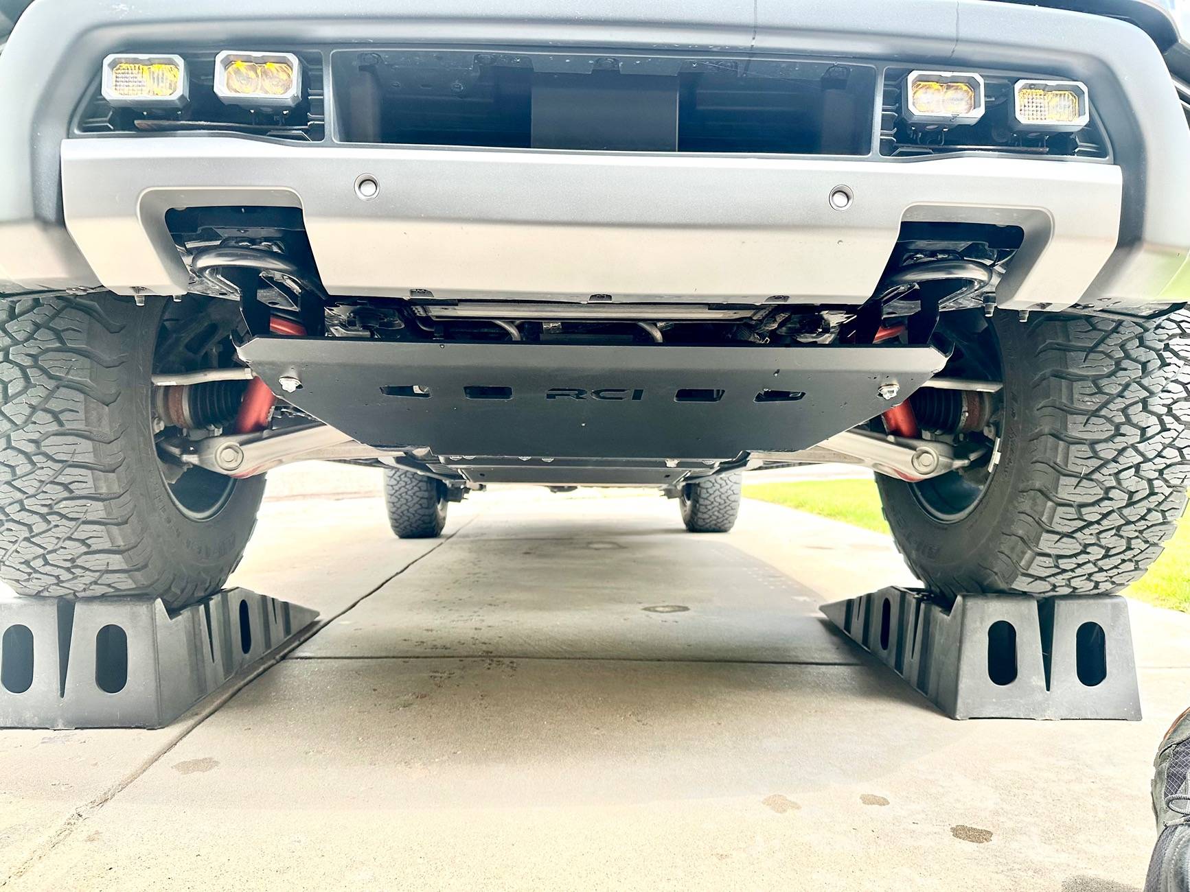

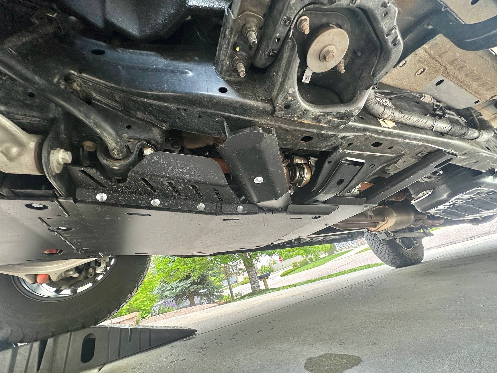

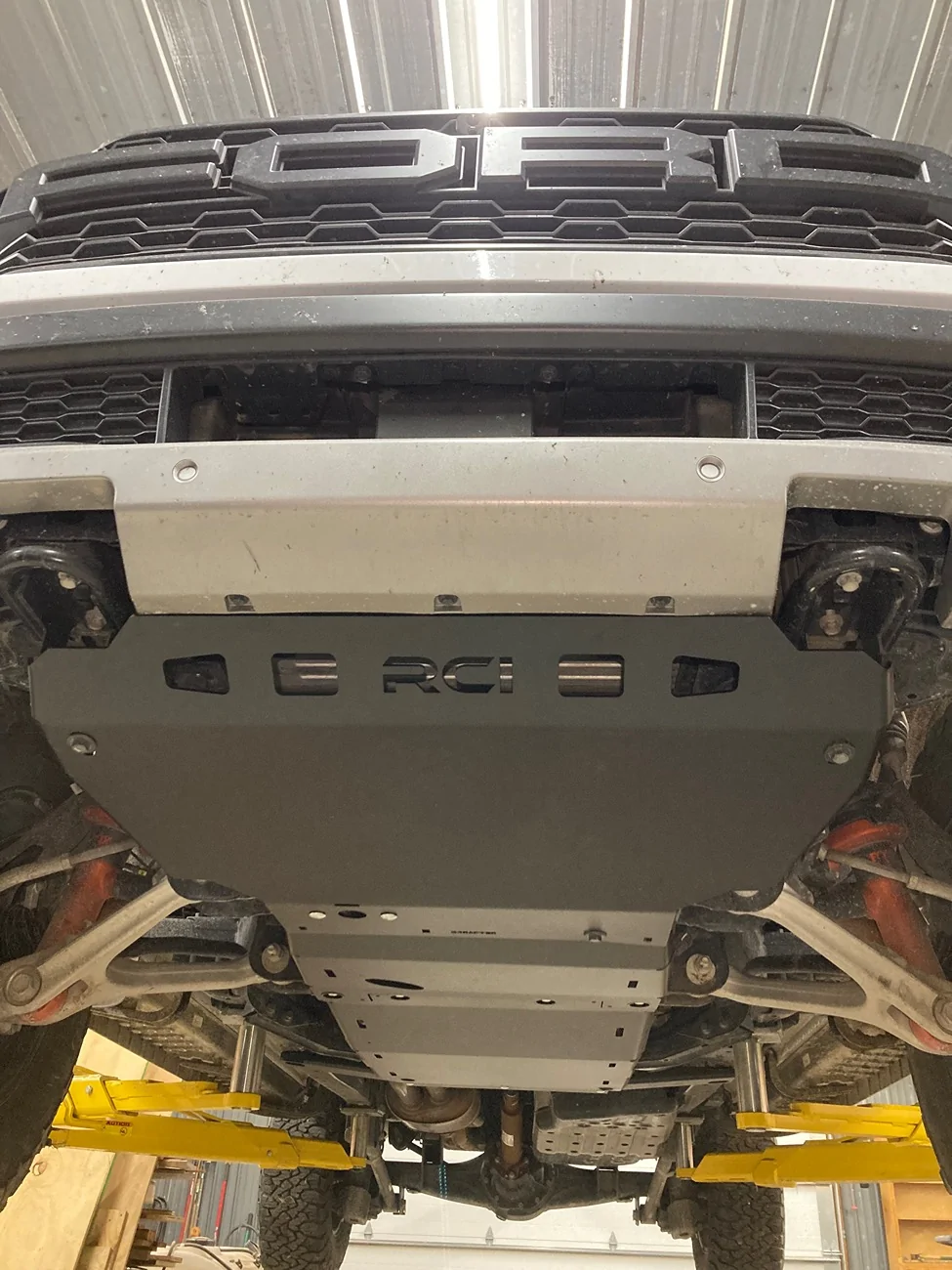

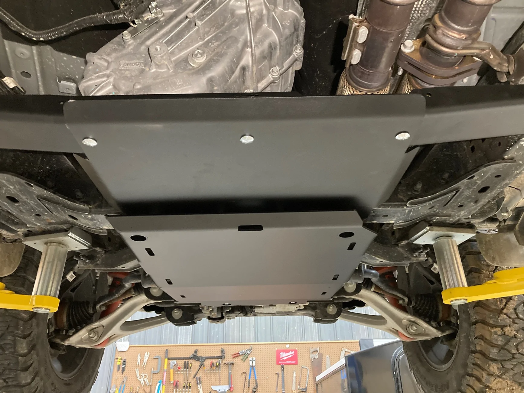

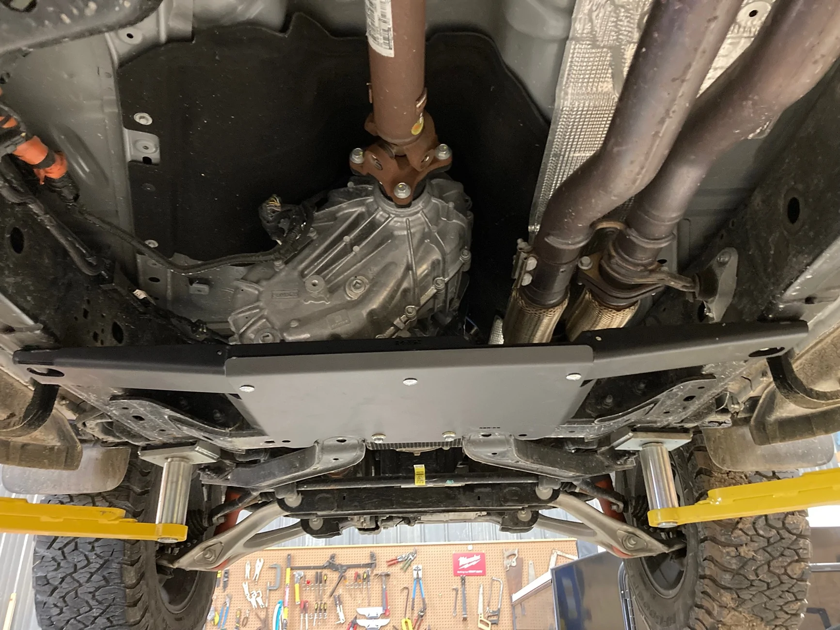

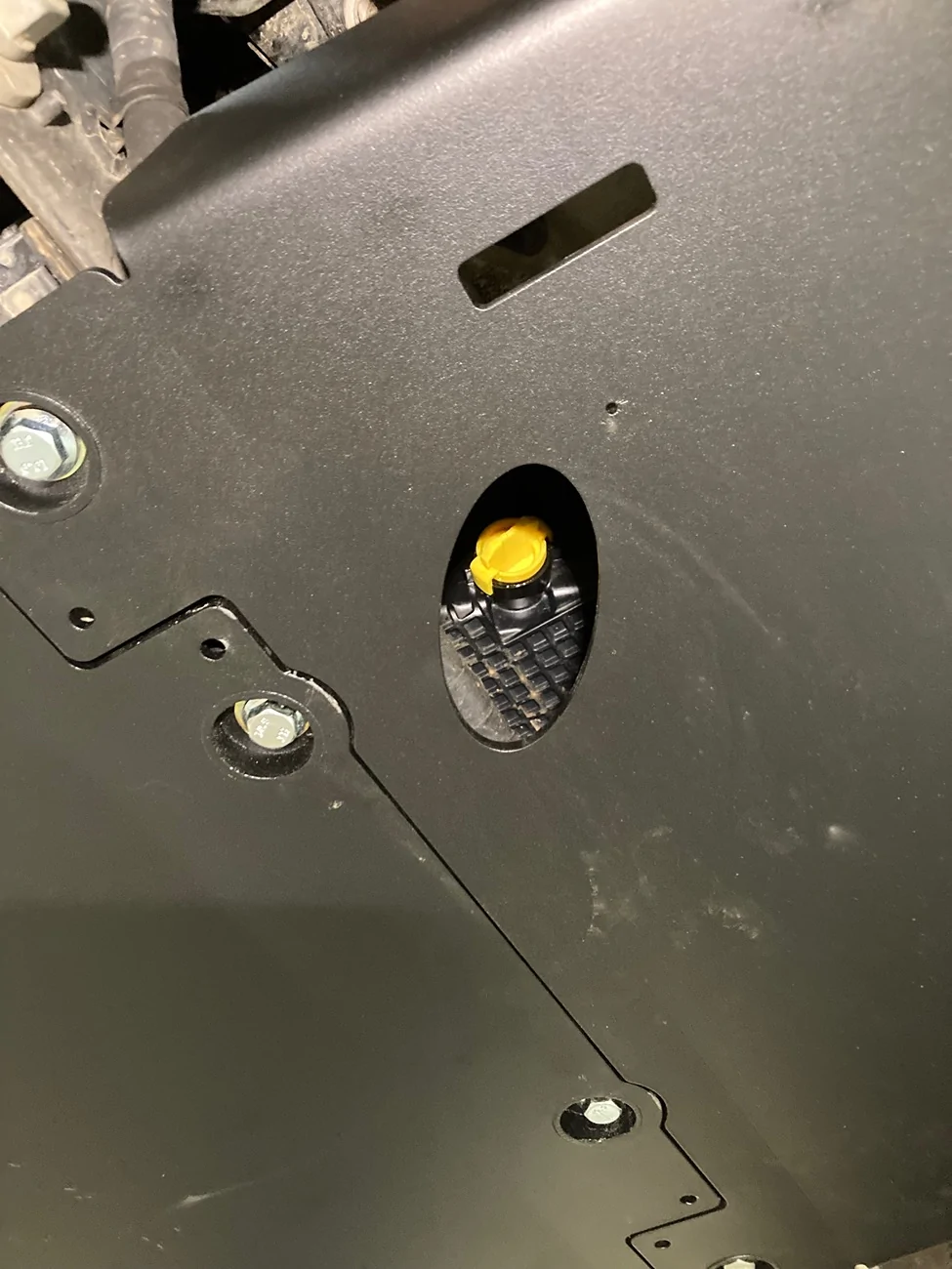

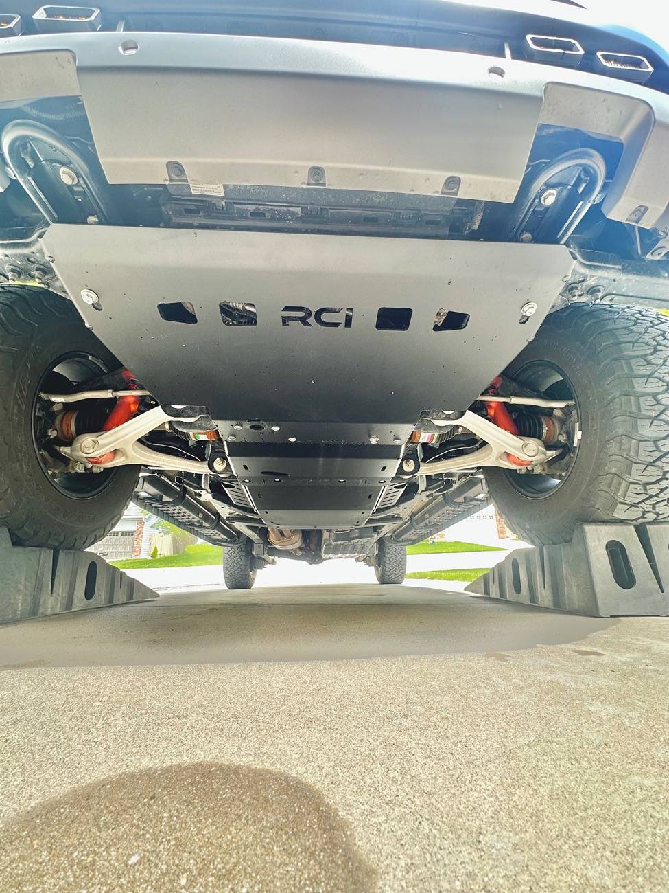

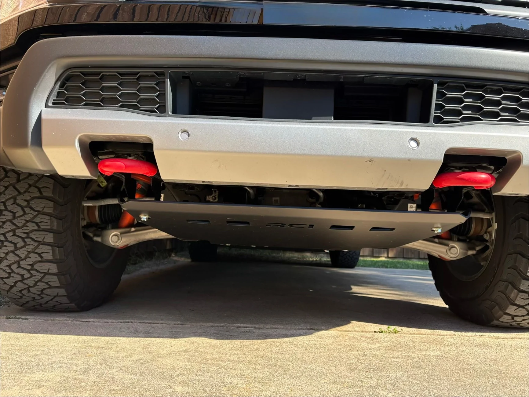

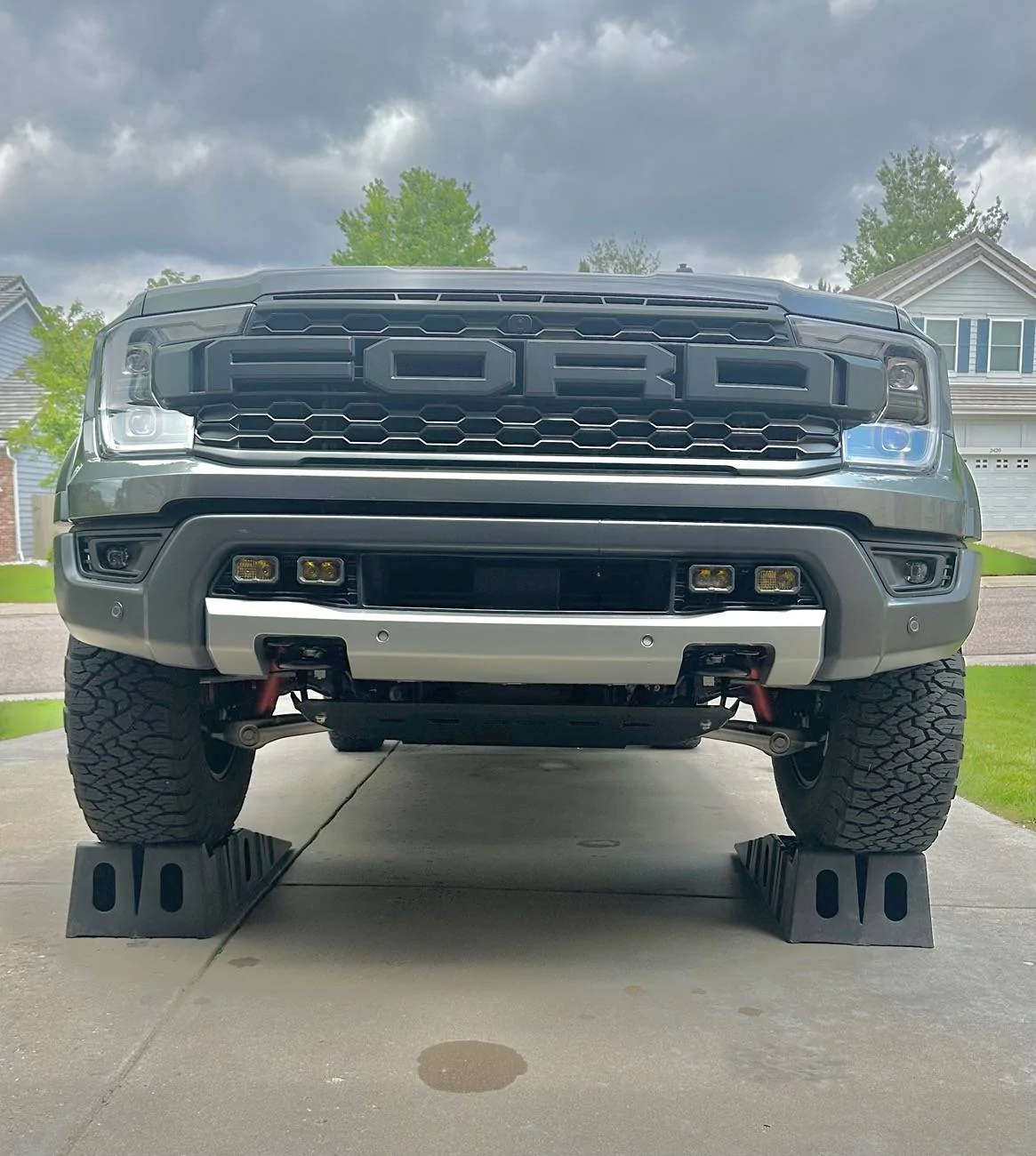

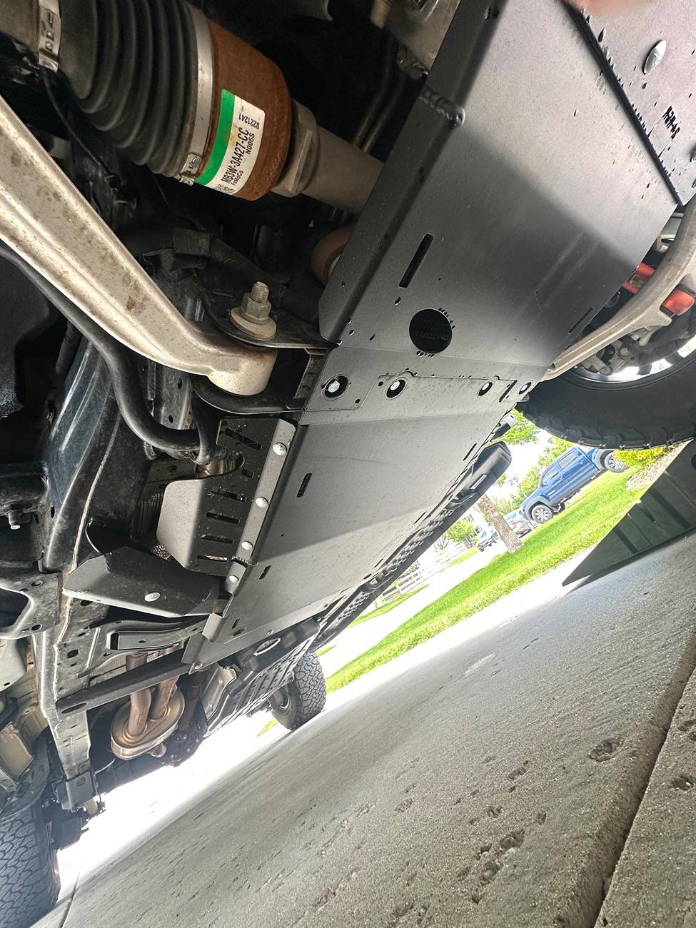

Just installed 3/16 inch steel RCI skid plates on my RR. I have the engine skid, transmission skid, and the t-case skid. I weighed the parts I removed vs the new skids I installed and I am now 87lbs heavier overall. The t-case skid is 21.6 lbs heavier. The engine skid is 27.8 lbs heavier, and the new transmission skid weighed 37.8 lbs.
I measured my height in the front and back before and after installing the skids. I put the truck on a lift then lowered and jumped on the side steps before my measurements both times. I saw 1/4” drop in the front and no drop in the back. I then drove it around and parked it and measured again and it dropped a bit more but I don’t know what the stock measurement should be normally. If anyone knows what your stock height measurement is from the ground to the center highest point of the wheel fender is I would be interested.

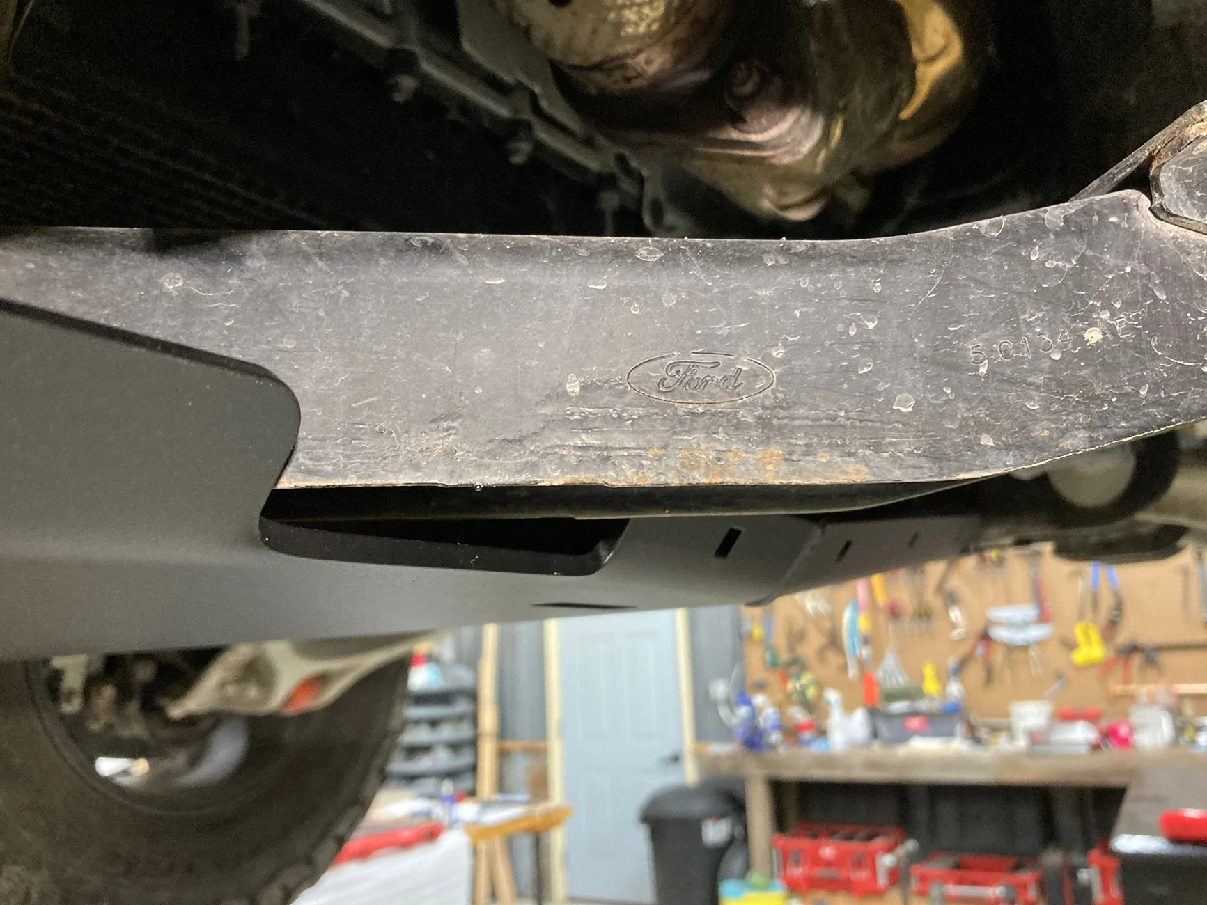

If anyone is interested, you can install these with one person. I did, but it was a little difficult due to their weight. Also I measured the lowest point on the skids and it is about 1/2” lower than the cross bars on the truck, so you lose about 1/2” of ground clearance. I don’t think that’s a big deal.

For those interested in going with this steel skid plate setup, I think I lost 1/2” of lift due to the weight of these skids. I also plan to add rock sliders in the future so I am guessing adding heavier springs in the front is in my future as well.
