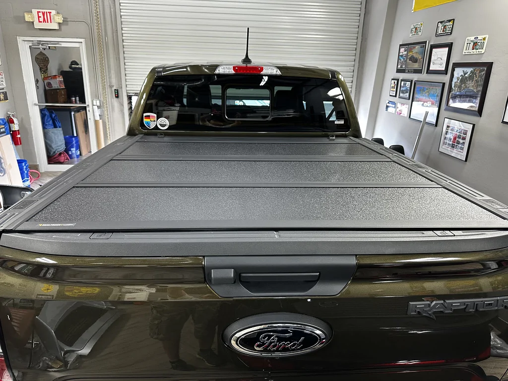

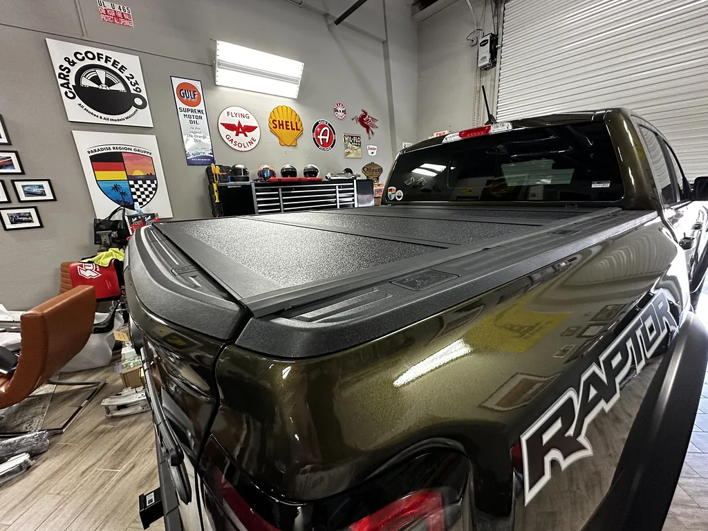

Ordered one of these covers for my truck. Received it and have been having issues with it not latching/locking properly on 2 panels on the passenger side.
After numerous emails to them, including pictures and videos of my install and the issues I am having, and being told that it is due to improper installation, I am waiting on some shims to see if this will correct the fitment and get this thing to work.
I've installed and then uninstalled it 3 times now, documenting and emailing them, so far, to no avail. (except the shipping of some bed rail shims that I will install/try to see if this rectifies the issue)
Getting super frustrated and may be sending it back for a refund and sourcing another cover/company if not satisfied with how the shims are or the operation thereafter.

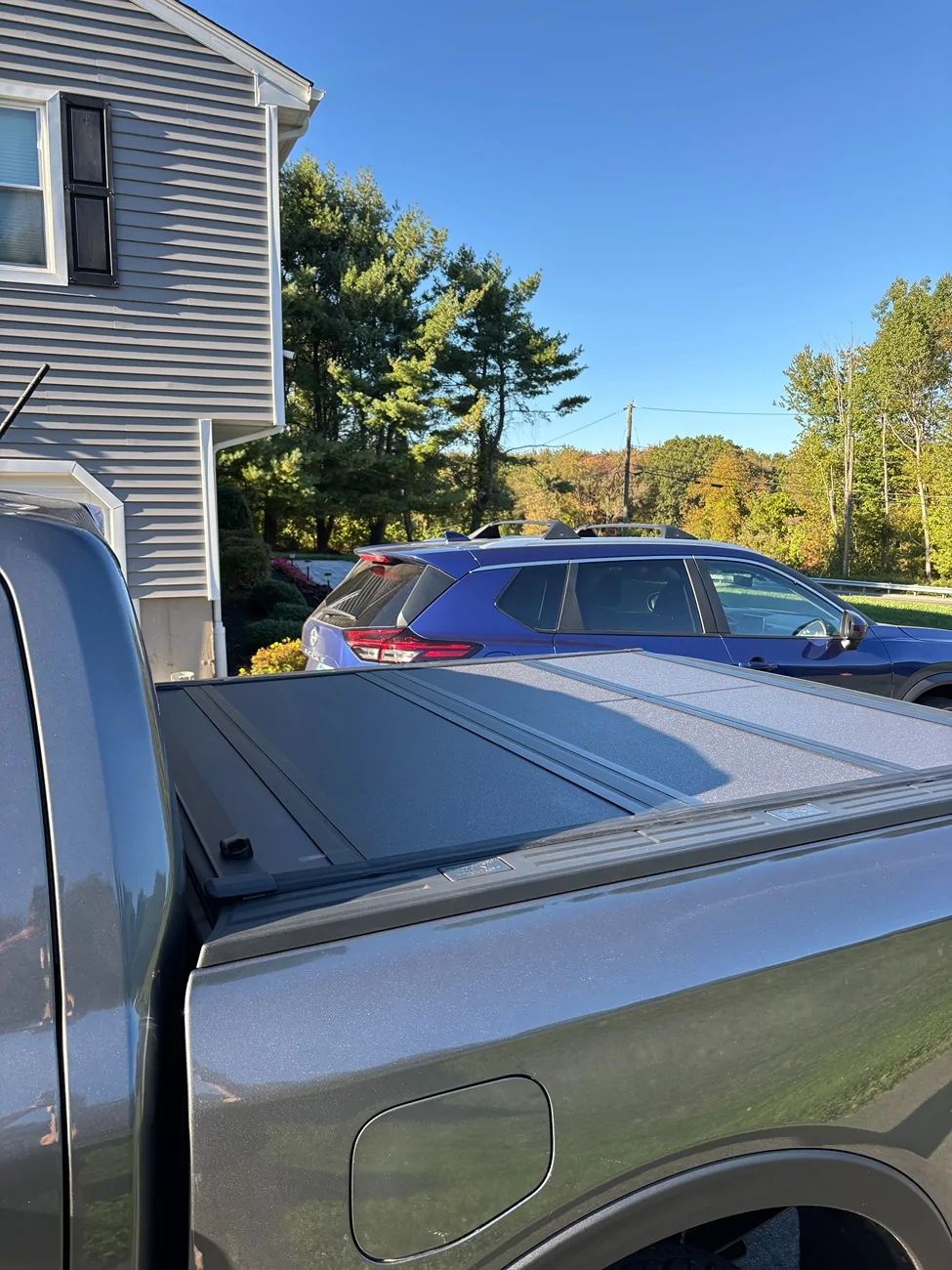

2024 Ranger XL
