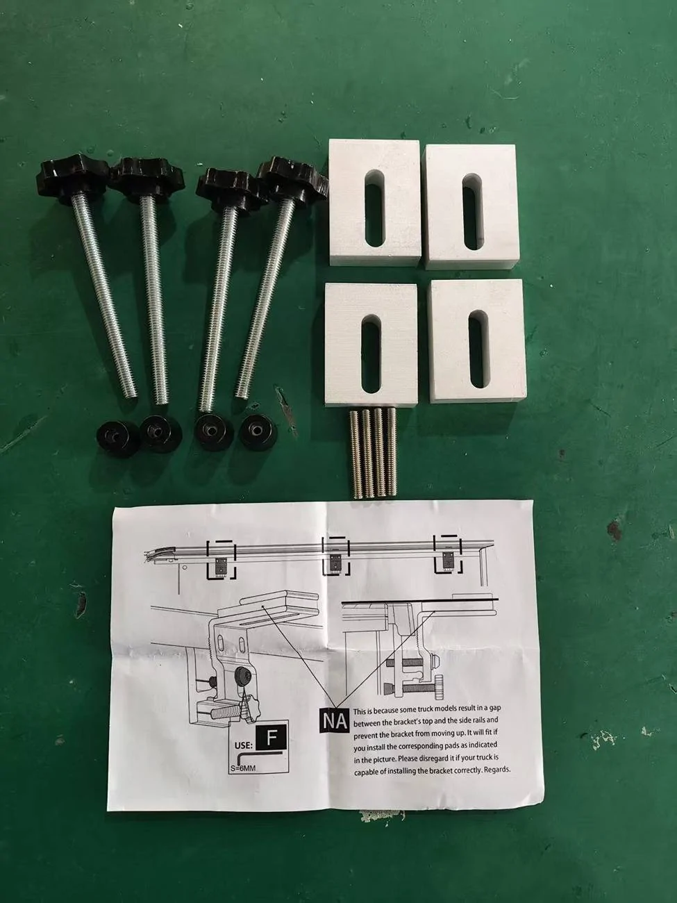

I reached out to them, they replied the next day and said they will send me "updated bracket" and attached a picture. It looks like it's just a set of spacers and longers screws for the existing brackets, which should solve the warping and binding problem (hopefully).

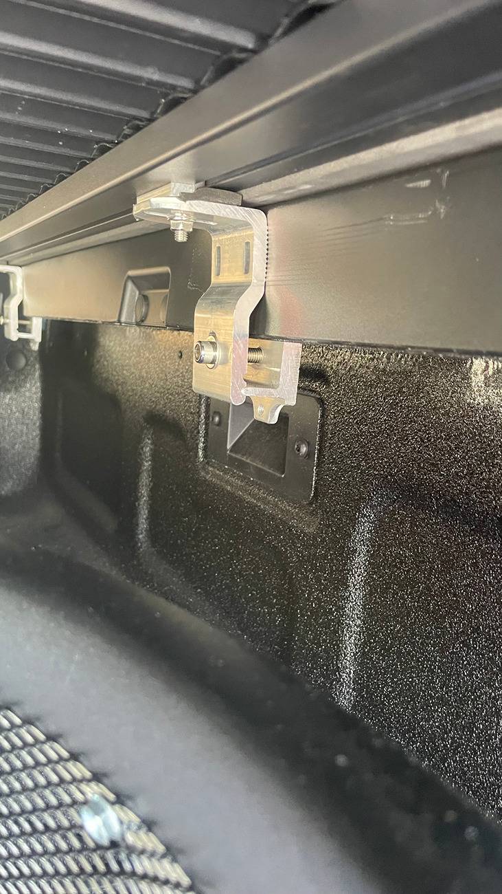

They have a better bracket- see the pick. I still eneded up having to use a small spacer to keep things flat. I could eliminate the the small block, but i'd have to trim the foam on the cover, not needed right now. If i were you, I'd push for a free set of the extended brackets, also with the spacers, and then I'd buy a second set for a total of 8, 4 per side. that should handle the load? Hope you have your Bed J-brackets done if your truck needs them.

Hm, if I’m interpreting the instructions correctly (they're rather poorly translated), that small metal block in your picture is meant to go between the bed rail and the plastic cover—right where the bracket clamps onto the bed. It helps fill the gap between the metal bed rail and the plastic piece to ensure the brackets clamp securely and don’t slide.

yes, i'm miss using them, but the instructions were trash, i felt a hands on approach would work better. I would't accept the spacers as a fix, get the deeper correct brackets if you're able. My install is very stable, but four more brackets might be in order if I was gonna buy anything on top of the cover.

This is the correct clamp i got from another member on here. I used a spacer, but I could of cut the seal on the bottom of the cover and flushed the bottom of the correct clamp to the cover.

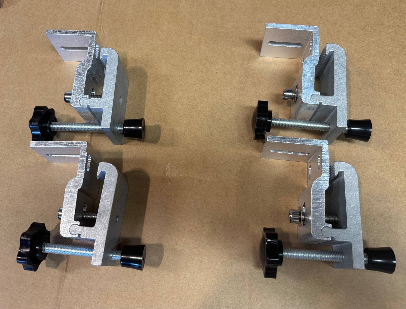

Do these brackets look right?
Edit: After attaching these to the bracket bolts that are in the t-track on the underside, it's clear that the bolts with the knobs and feet on them are nowhere near long enough to reach the inside sides of the bed. The brackets don't seem to fit very well.
