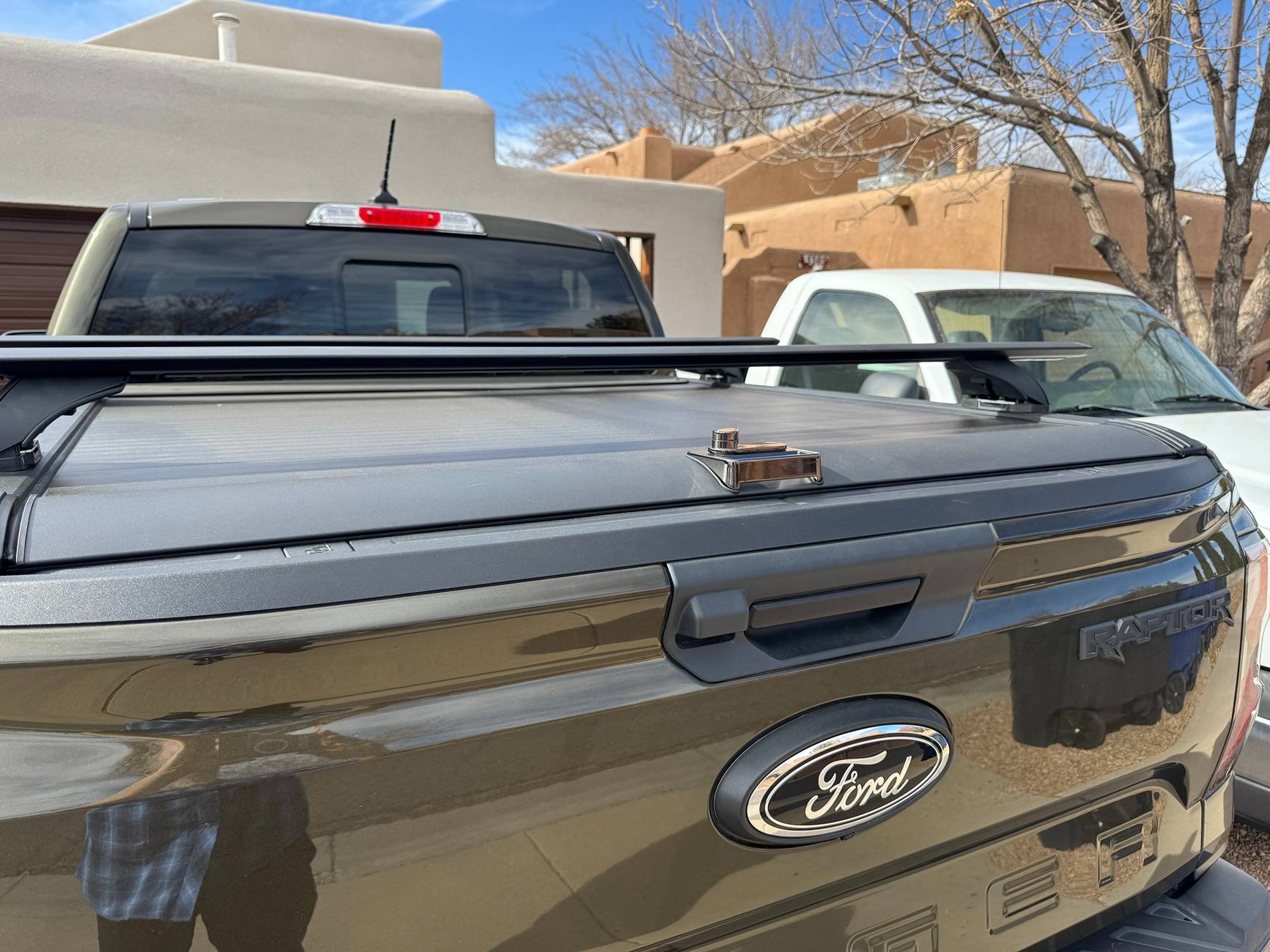

I like:
-the price
-that it covers the plastic caps on the side
-the price
-that it has rails for a bed rack
-oh, and the price. Ha!
I'm hesitant that it's retractable, hoping the mechanism doesn't jam up. Also hoping it doesn't freeze in the winter, but where I'm at in NM it doesn't get too crazy cold (except recently...). If the tonneau lasts until I can save up for the topper and decked system I want, that's enough for me.

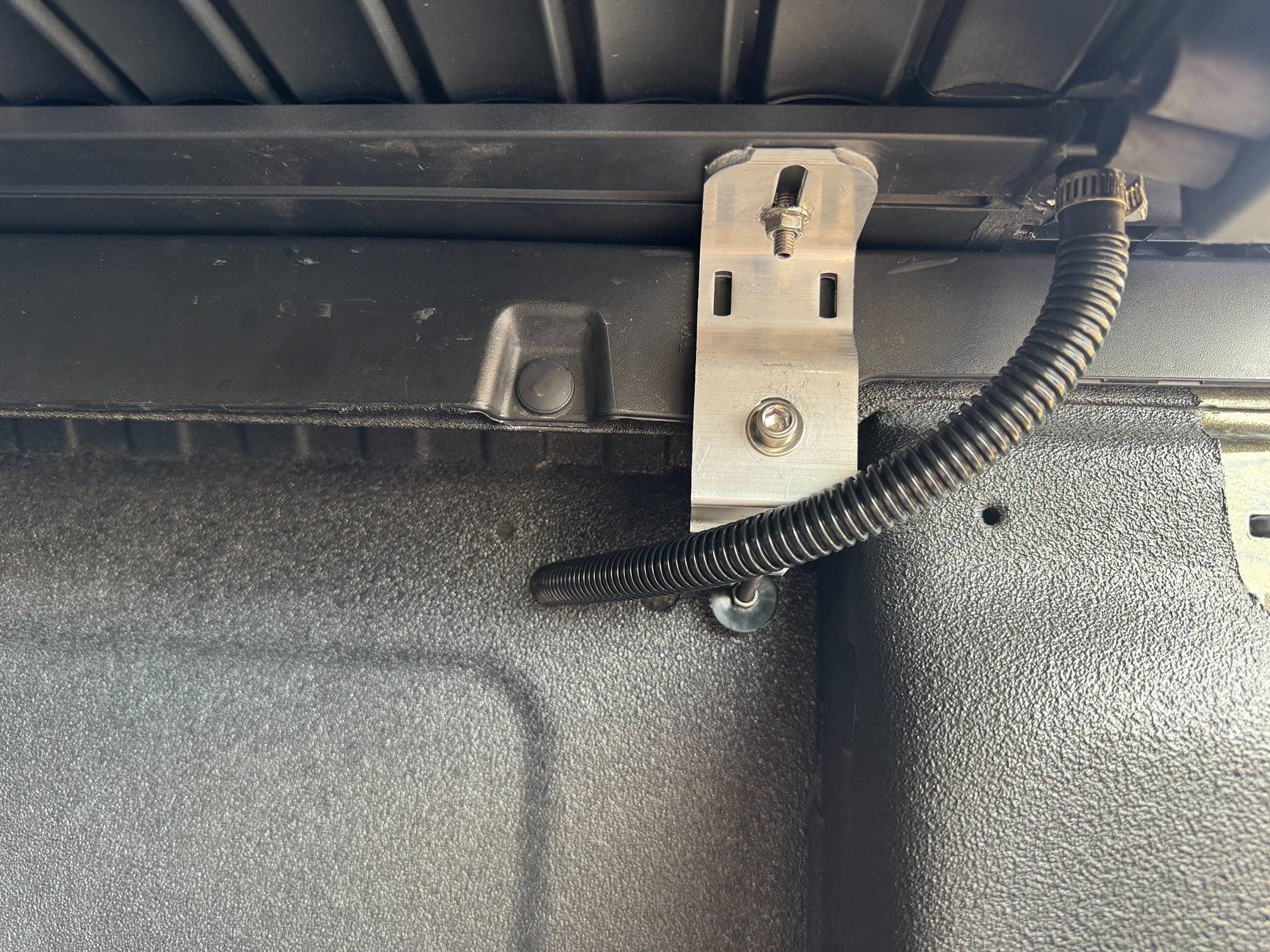

I bought this same cover and have just about completed the installation. The only issue I’m running into is determining where to put the drain holes at the rear of the bed near the tailgate. There are some pre drilled holes near the rear of the bed but they are too small for the drain pipes. The pre drilled holes near the front of the bed are larger and worked great for the two front drain locations.
What did you do for your rear drain pipes? Any photos you could possibly share?

Hey there - the hoses that came with mine (Willmoso) barely fit into the small pre-drilled ones you are referring to (no grommets) . I kinda had to "thread" them into there. I trimmed them at a bit of an angle before I put them in. I reamed out the Line X with a razor knife.

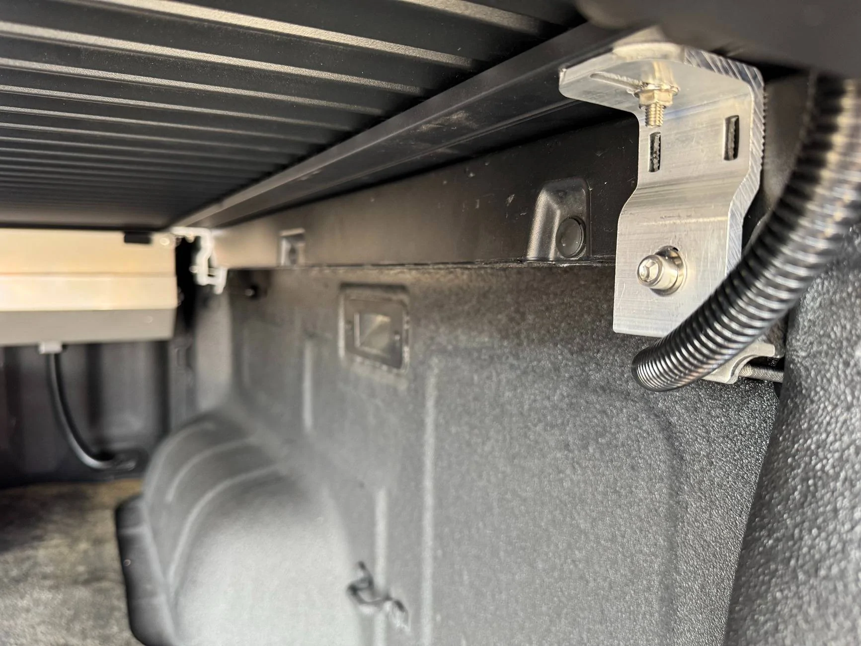

Installed. Well made and install did require some readjustments to the clamps, it does seem to be about 1" too short. It fits and sould seal, but it's on the edge. Still very happy with it. The fit and finish are excellant, as good as any at 3x + the price. Operates smoothly, but you have to use the spacers under the clamps. I think I'm gonna make some spacer blocks to better keep the clamps from pullling the cover out of flat. Small detail to save $1500 bucks.
Did you figure out the spacers? What did you use? I am running into the same issues, the hand screws are too short to reach the sides of the bed.

D Sampson above complained to Flowkottu and got the right brackets, he had an extra set when I bought off of him. I just put them on last week and they fit perfect..
