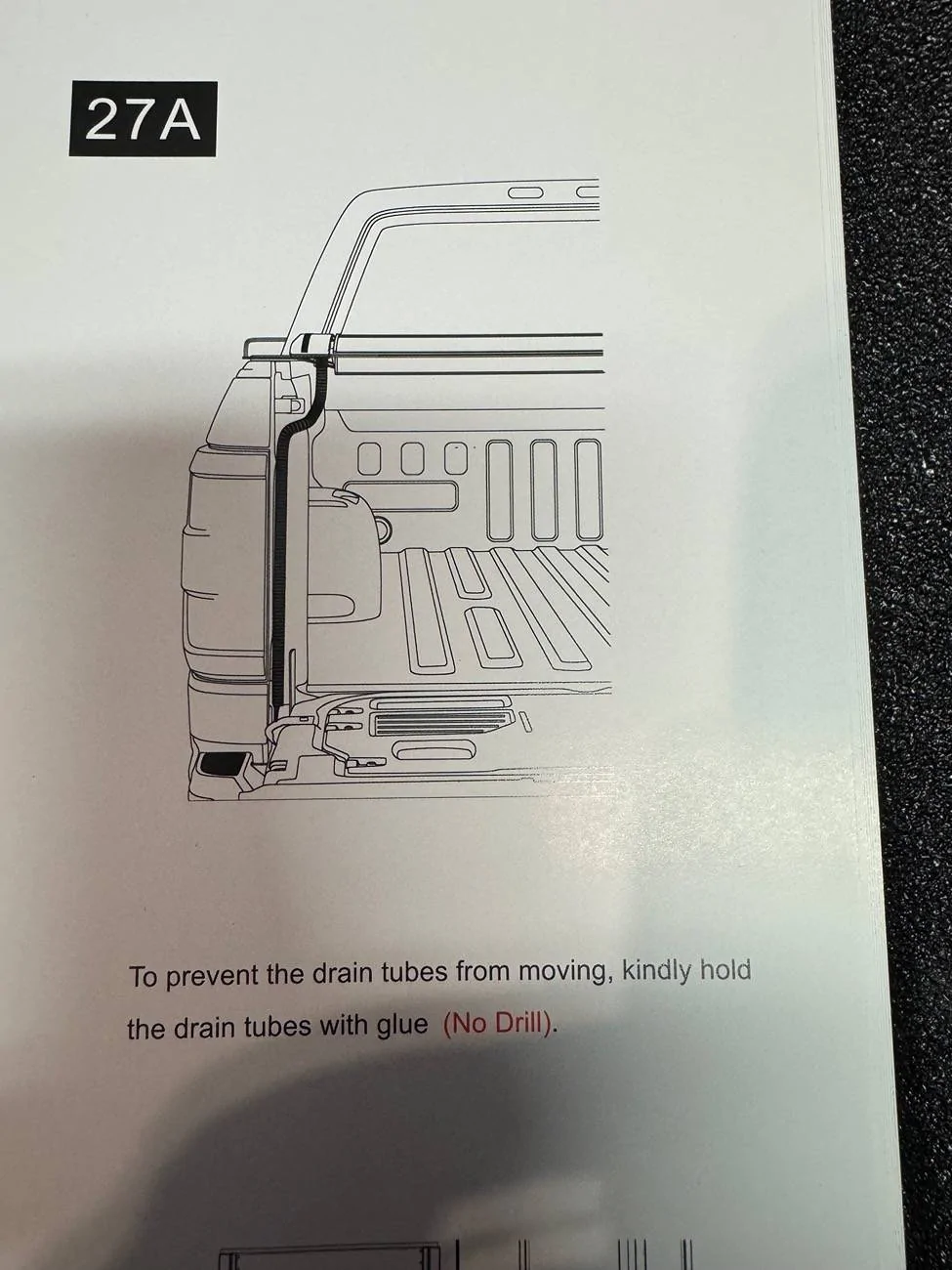

I’ve got it positioned and clamped down, but I’m having a lot of difficulty getting the drain tubes to fit into the holes in the bed walls. Wondering if I should look for some replacement tubing.
Upon more RTFM, it appears that you can route the rear drain tubes along the edge of the tailgate and hold them in place with the RTV silicone. See below. However, the passenger side looks like it will interfere with the tailgate dampener.
