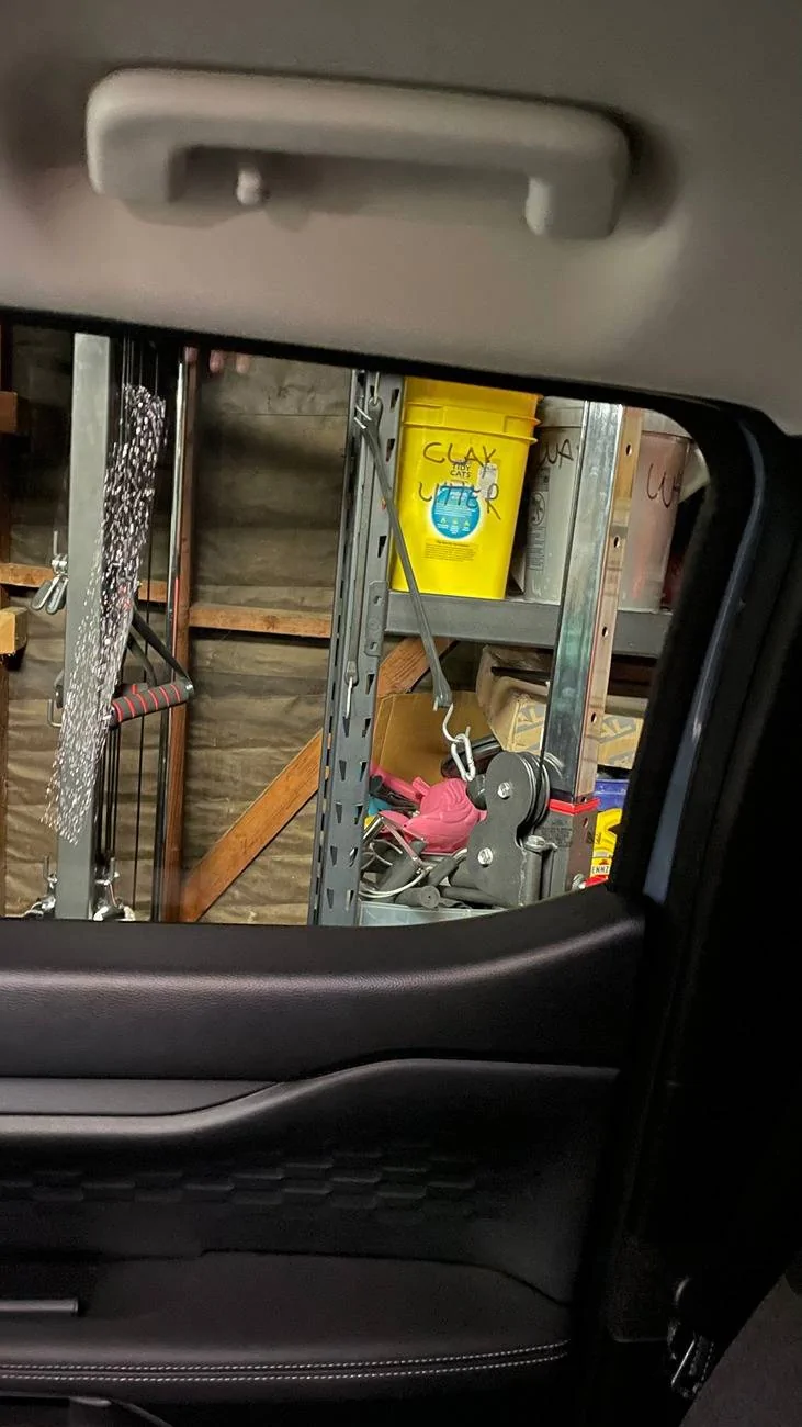

There's a Hook just inside the rear fold up handle for a coat hanger. Inside. If your doesn't have it, order a current handle. Mine was built 3/24.
That is what I had hoped!!mine does not have, can you send me a pic and/or a PN ref to order it??what color is your handle?not that I would care too much if it does not match mine as long as I can get that hook!

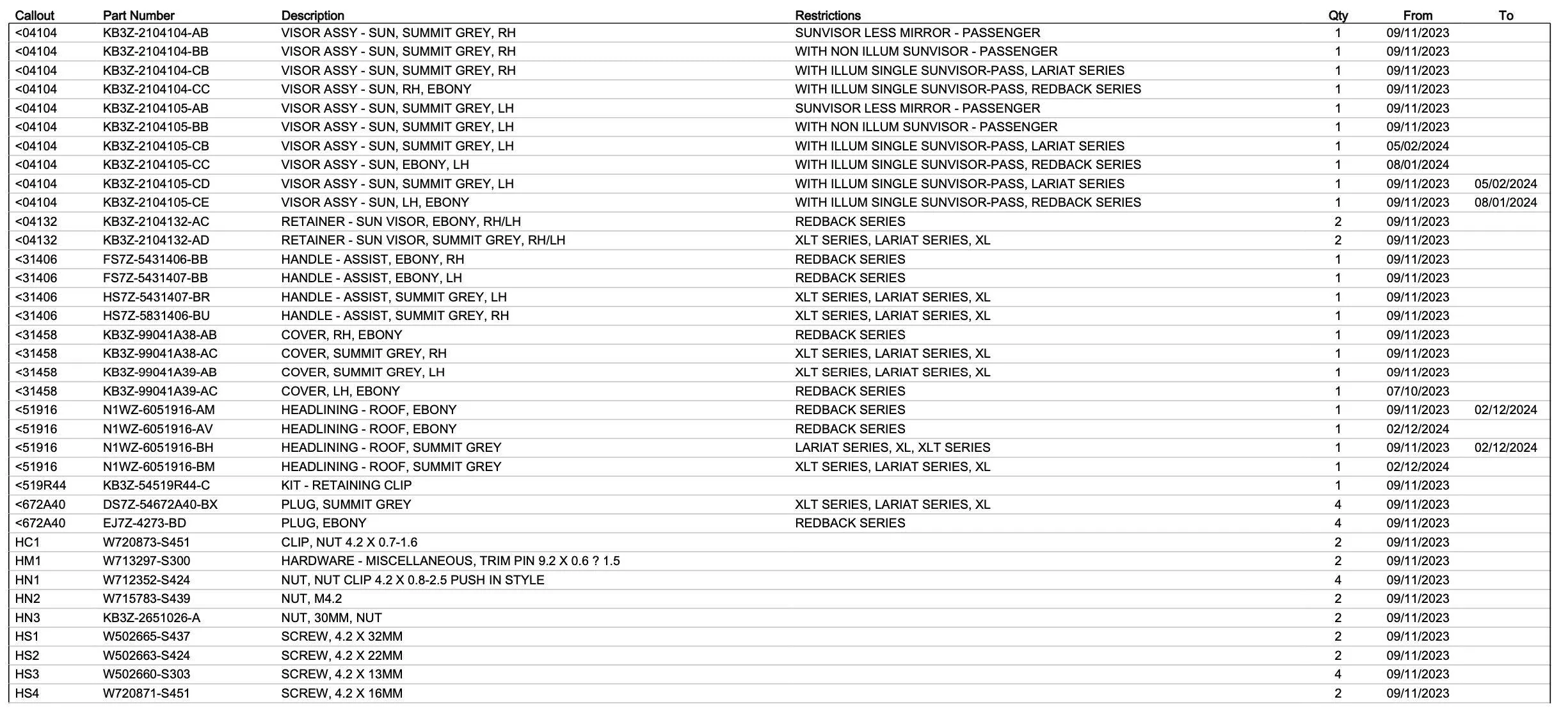

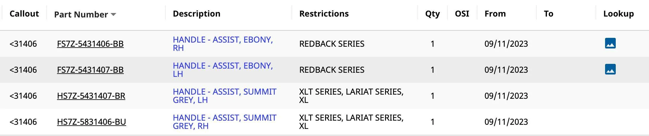

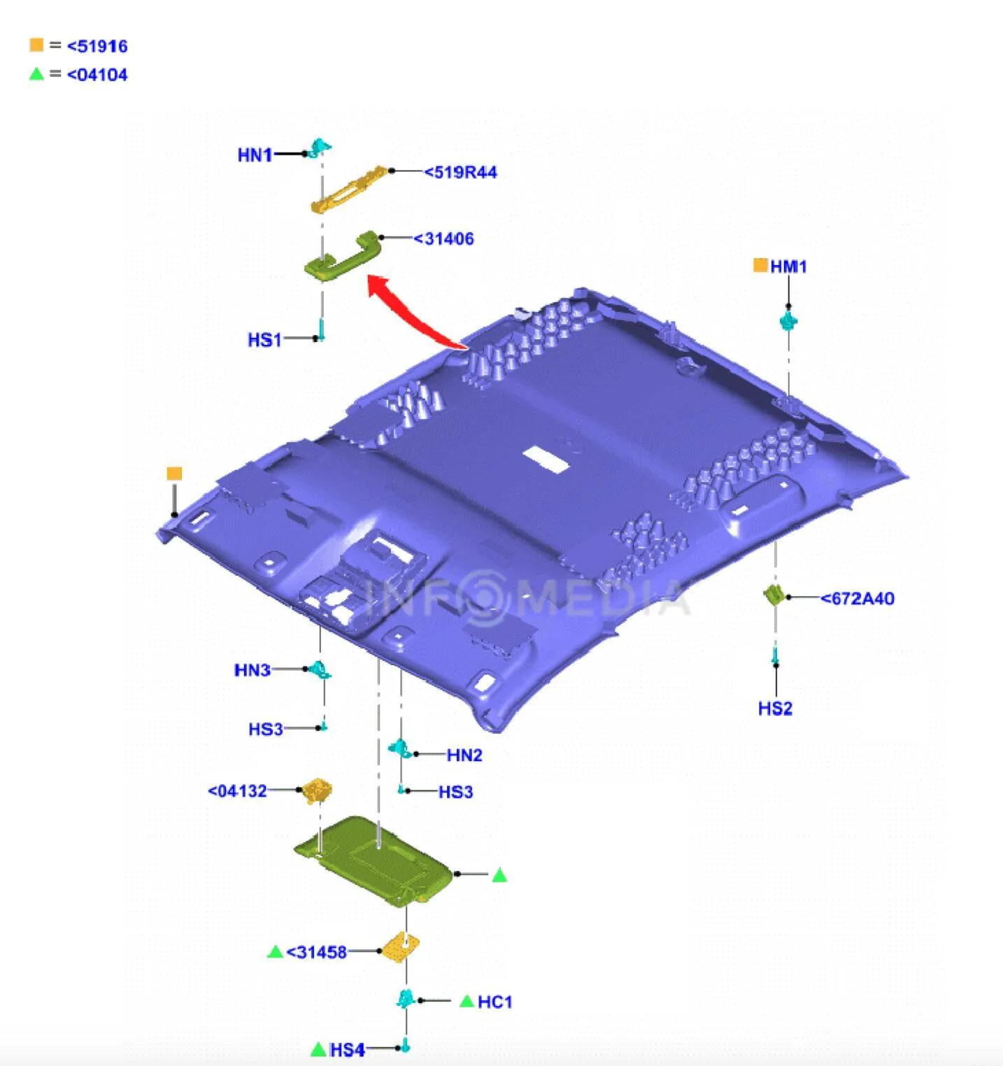

That looks exactly what I was looking for!and it matches my color too..
Now need to find it
