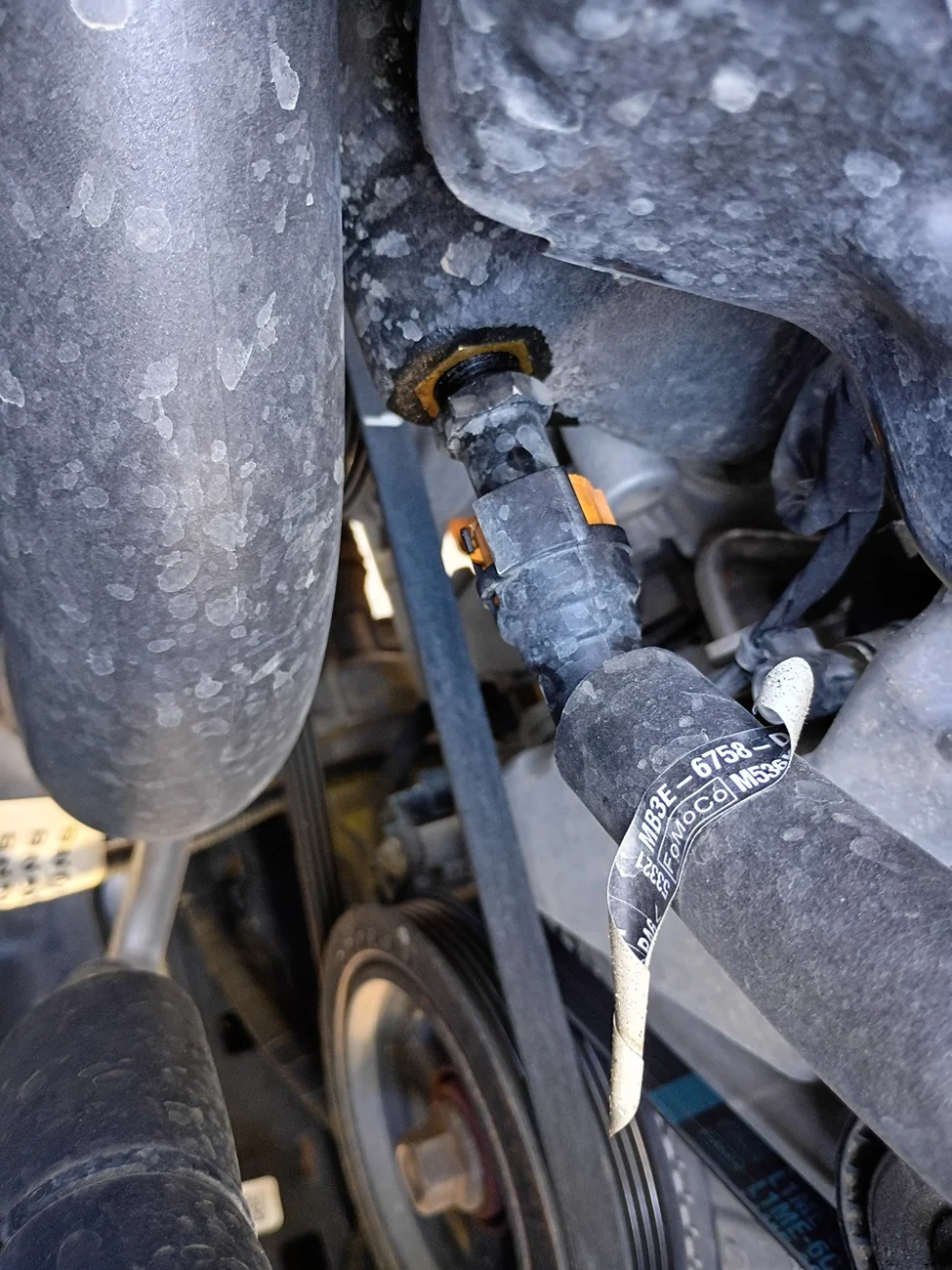

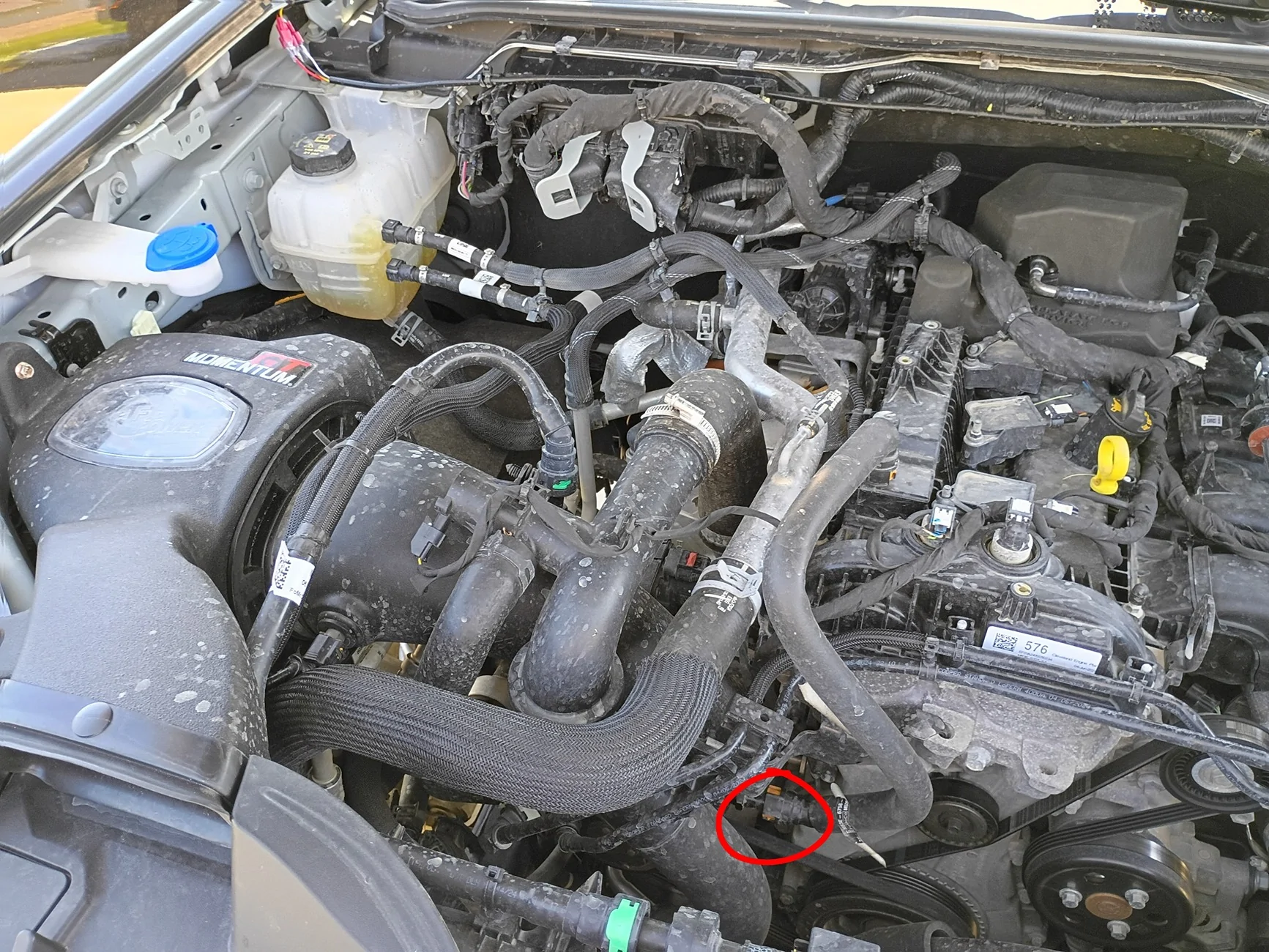

Hi all, I was looking under my hood today and noticed an oily residue near the area where the PCV/crankcase breather tube connects to the AFE Momentum CAI. I was just wondering if this is a normal occurrence, or if there is potentially a more significant issue. I have been on the fence about reinstalling the stock intake either way. I've attached some pictures, please forgive the dirty engine bay.

Looks like the nipple needs some thread sealant. Personally I would tie in a catch can between there to keep the oil from even making it that far.

Thanks for your input, catch can is next up on the list for sure. If some amount of seepage is normal in that spot, would sealing it more completely have any negative effects anywhere else in the system?
It's not normal for seepage anywhere. It has that because it looks like the threads need sealant.. the stock setup isn't threaded so you don't see any seepage. The negative is it's not fully sealed and you've got oil seeping and creating a bit of a mess.
Understood. I was going to take a look at the stock parts I took off to see if the seepage was present there as well but good to know it wouldn't matter. Hopefully I'll have some time to get it apart, clean it all up tomorrow and apply some thread sealant and then monitor the situation from there.
