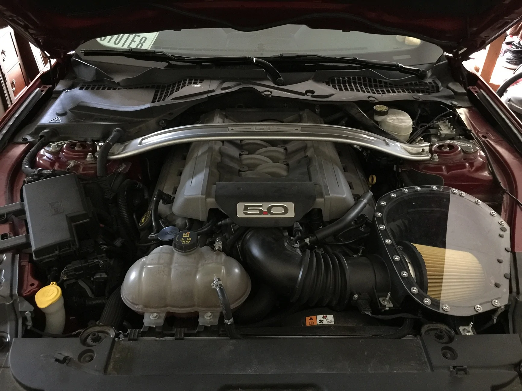

Hence for Ford Performance uses conical paper filters in the GT350 and Stage 2 Power Pack I had on my 2016 Mustang GT which used the GT350 throttle body and air induction system:
Ford Ranger To CAI or Not to CAI, Everyone's Question IMG_0074
Note that I fabricated a custom lexan cover and riveted it on since the original GT350 intake was designed for the GT350 hood profile and didn't' seal the best against my standard GT hood, then I did some ducting up front on that to make it a ram cold air intake.
