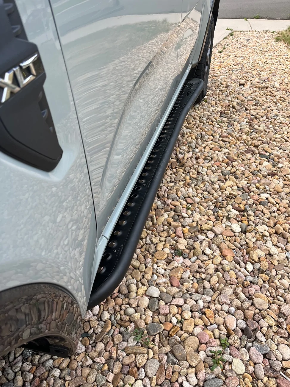

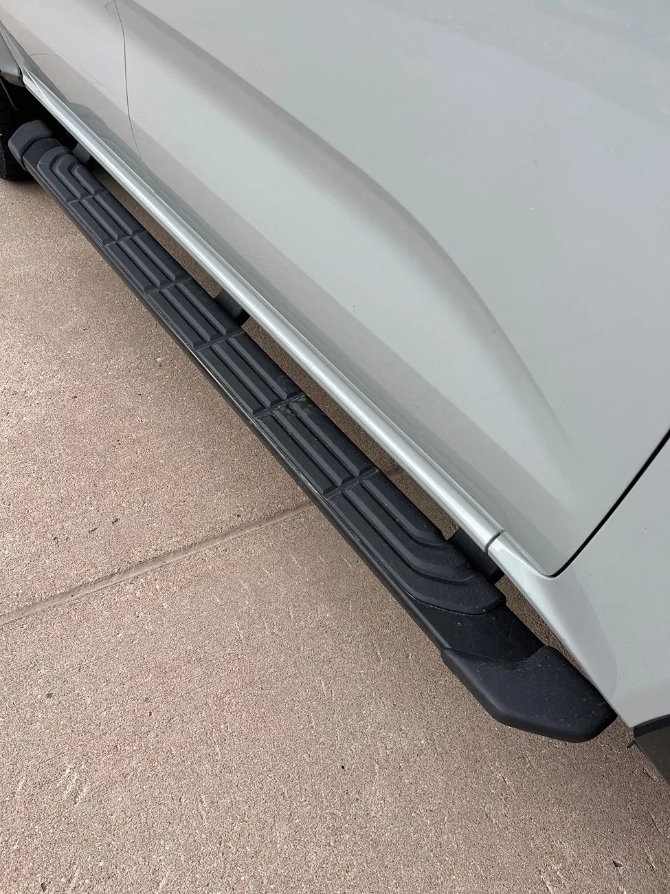

Here are pics showing one slider and the old running board on the other side.

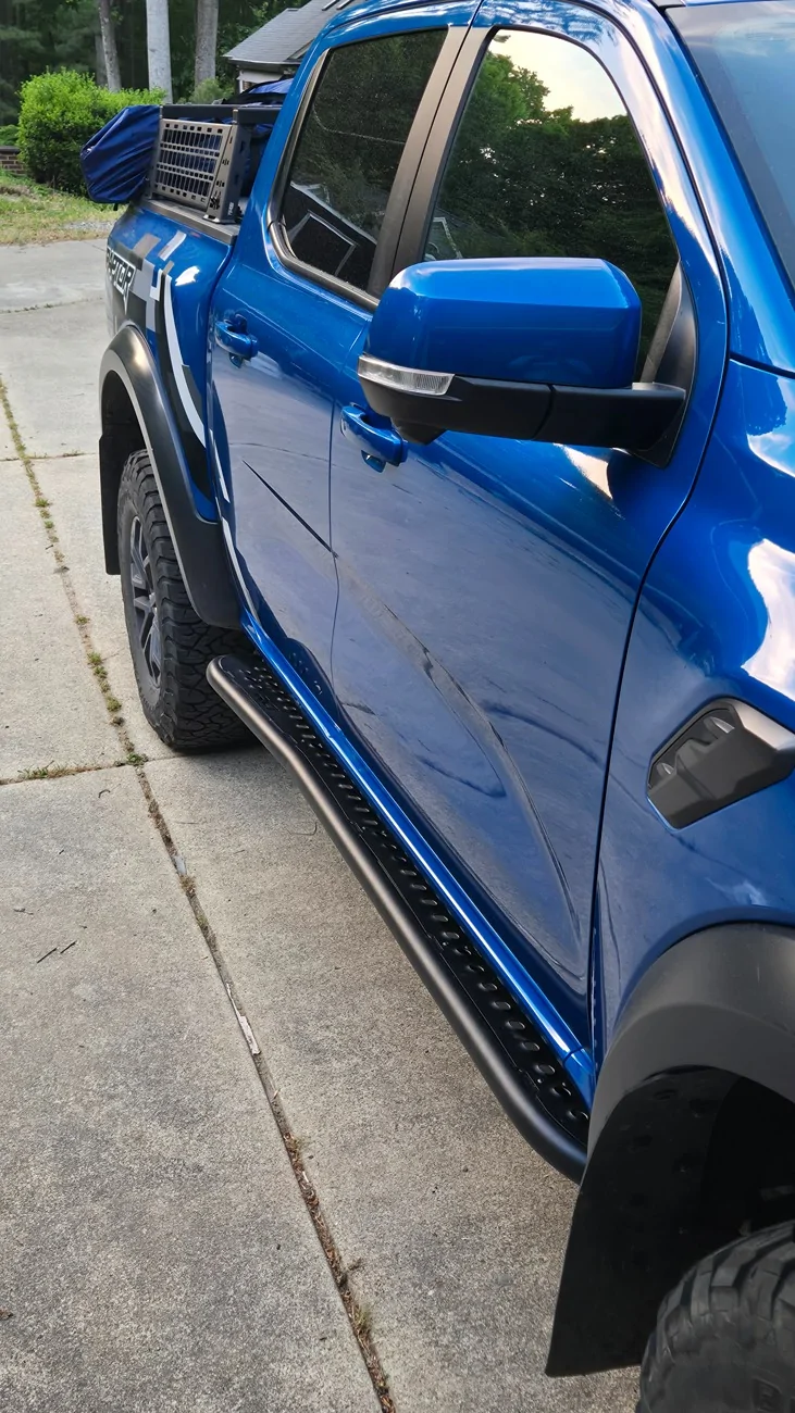

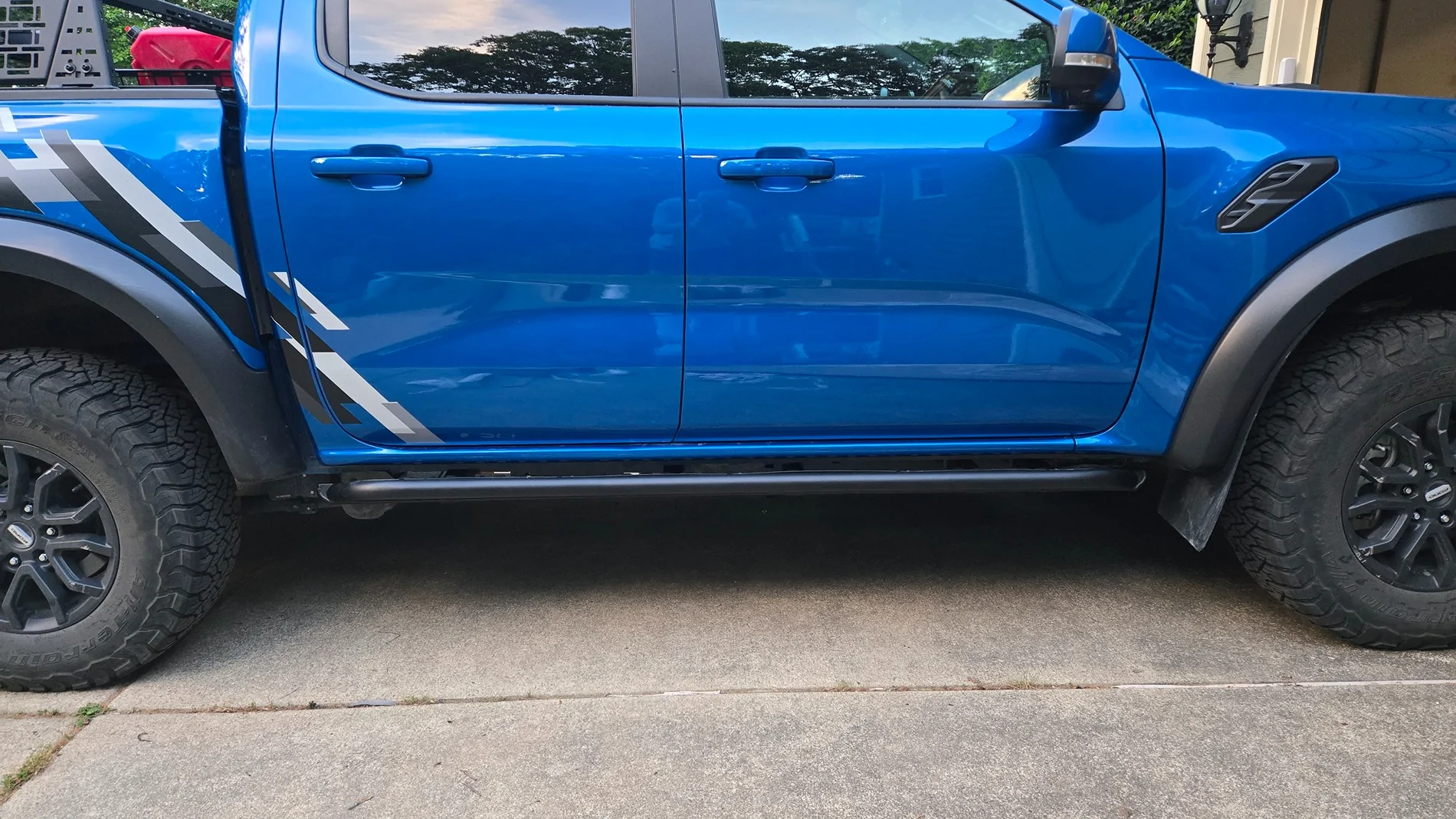

Mine arrived with the packing boxes totally destroyed and damage on sliders.
Called them and spoke to customer service manager and he was a totally nice guy. Had a new set made in 3 days and with my help on what the boxes need to be stronger they packed them much better and they arrived great. Install was not bad.
Ford Ranger Review - RCI Rock Sliders for XLT (2024) 20260417_194512
Ford Ranger Review - RCI Rock Sliders for XLT (2024) 20260417_194623

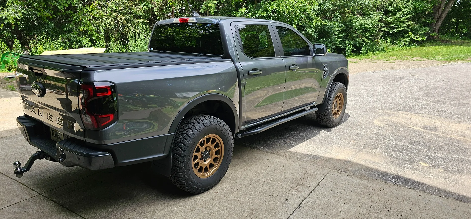

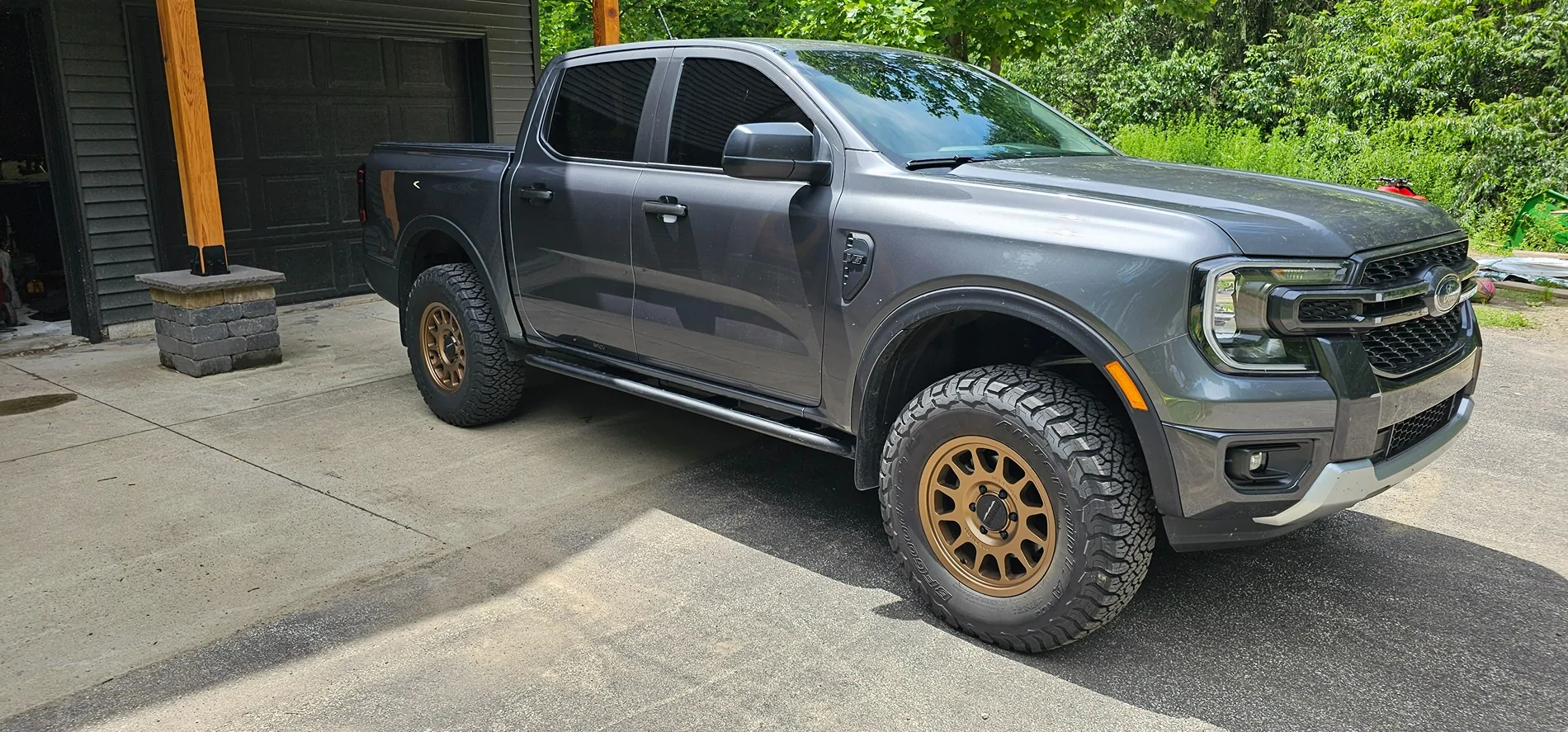

I also just installed the RCI sliders. They were an absolute pain, well I should say one of the threaded tabs on both sides was a pain. I was also missing hardware, specifically the 2 carriage bolt brackets. They shipped out new ones but they haven't come in yet. I also had chips in the finish and areas around the tread plate screws are starting to show rust. But they look good and seam heavy duty enough. I will say that I think all of the rock sliders available for the ranger are severely overpriced.
Ford Ranger Review - RCI Rock Sliders for XLT (2024) 20260615_143944
Ford Ranger Review - RCI Rock Sliders for XLT (2024) 20260615_143929
