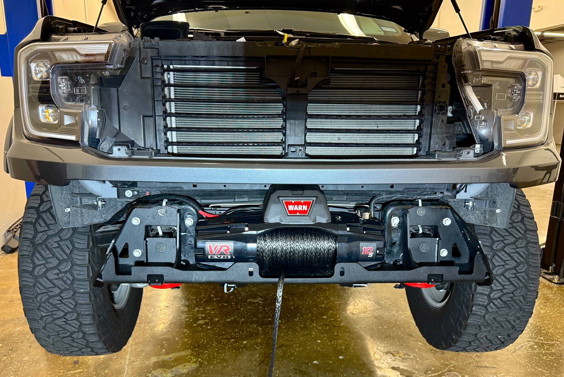

How did you solve the issue with the lower active grilles? Did you manage to keep them when installing the winch? Thanks.

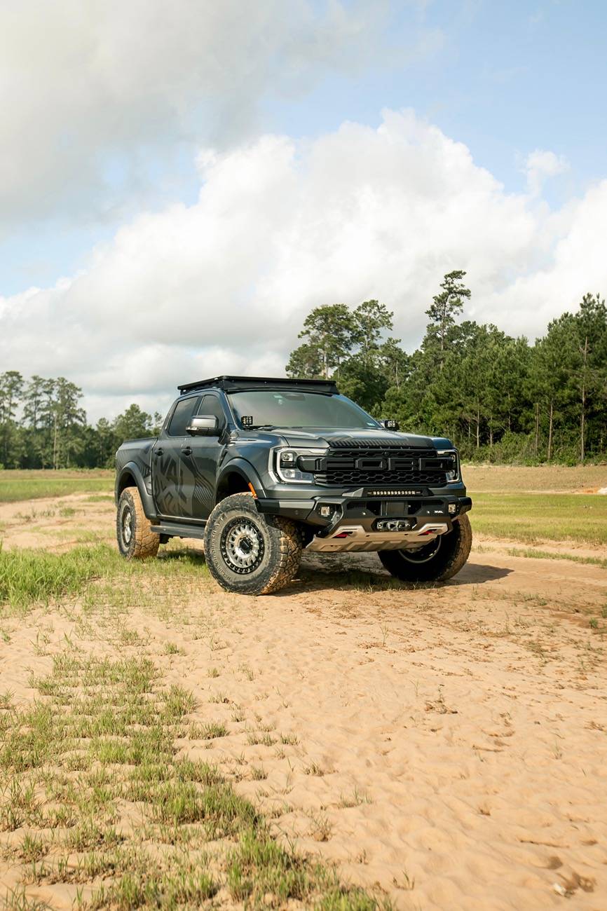

That picture is a bit deceptive. We made the bumper as low profile as possible while not having to cut/modify the active shutters and still fit a winch. There is very little room in front or behind the winch once the bumper skin is installed.

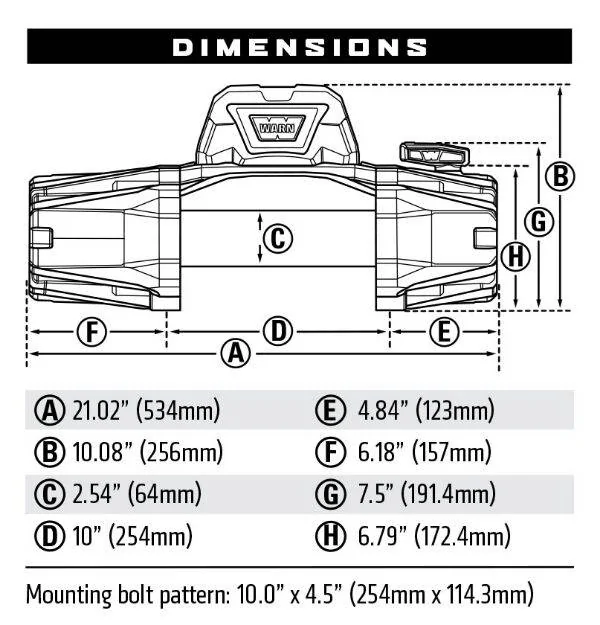

We have the warn VR-EVO 10S installed. If your winch of choice fits the dimensions below it should fit in our bumper.

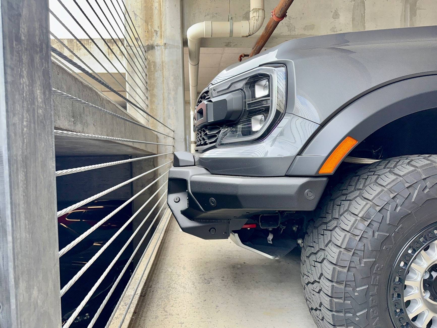

Thanks for sharing. Did you keep the lower active grilles in place or did you remove them? It seems that many solutions require removal of the active grilles (on 3.0 V6 european Ranger Raptors) which might cause faults. Thank you.

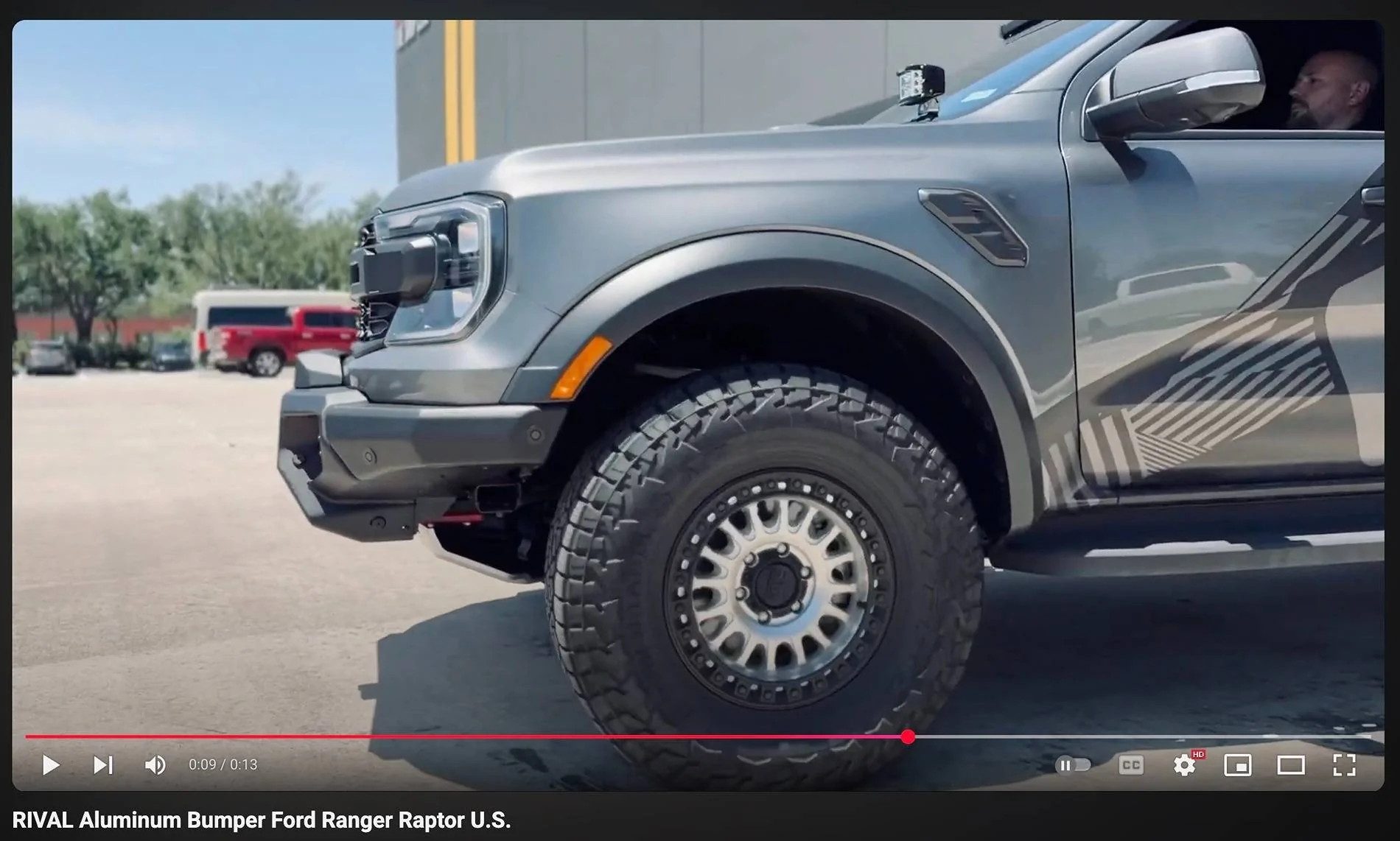

Our bumpers do not require removal of the active shutters; we only remove a rubber shroud, at least here in the USA. Here’s our detailed installation video.
