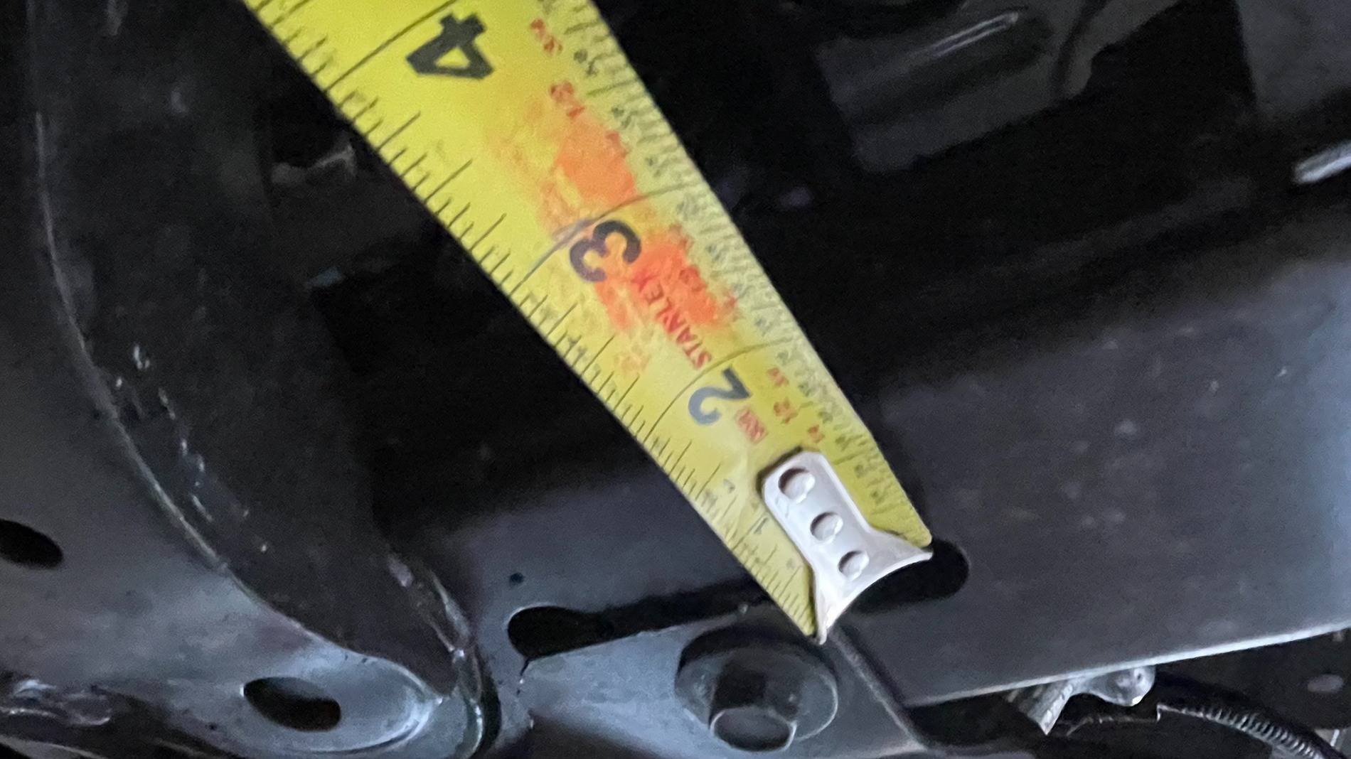

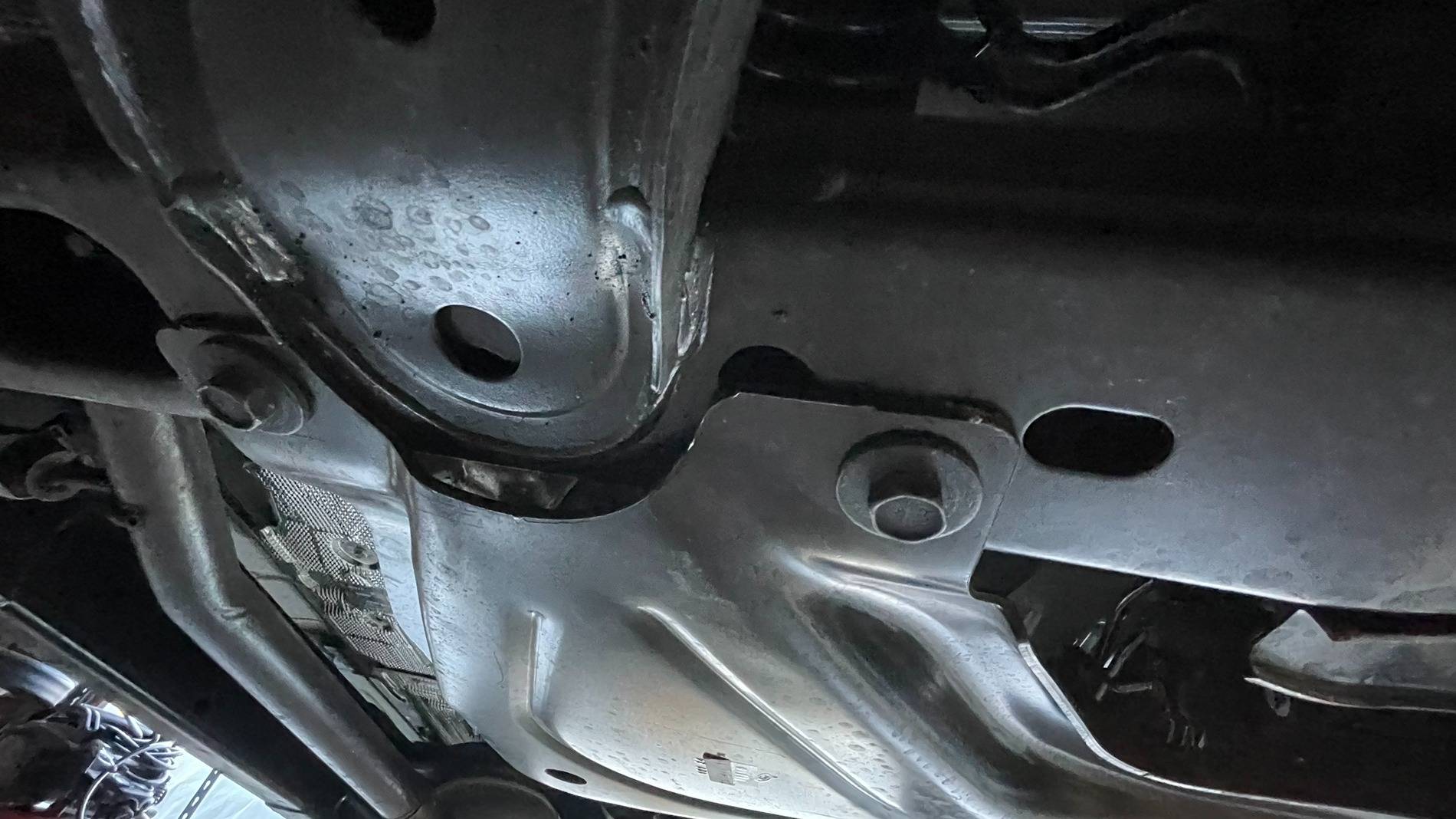

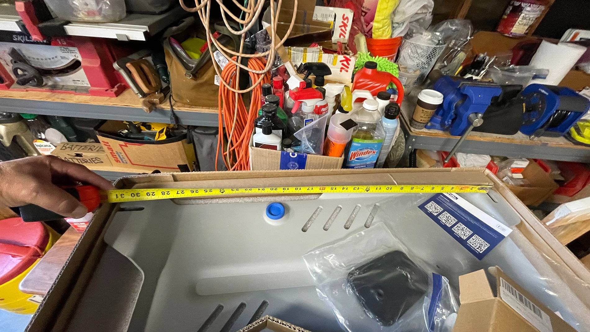

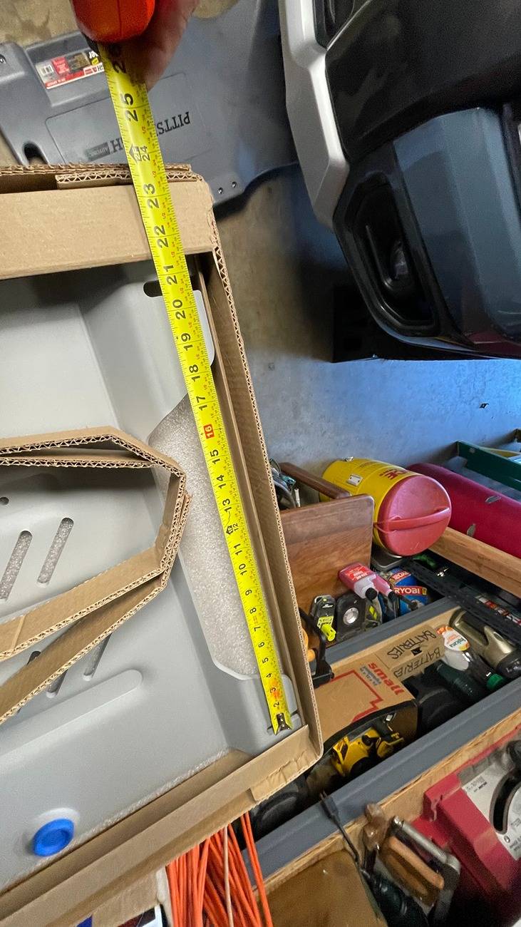

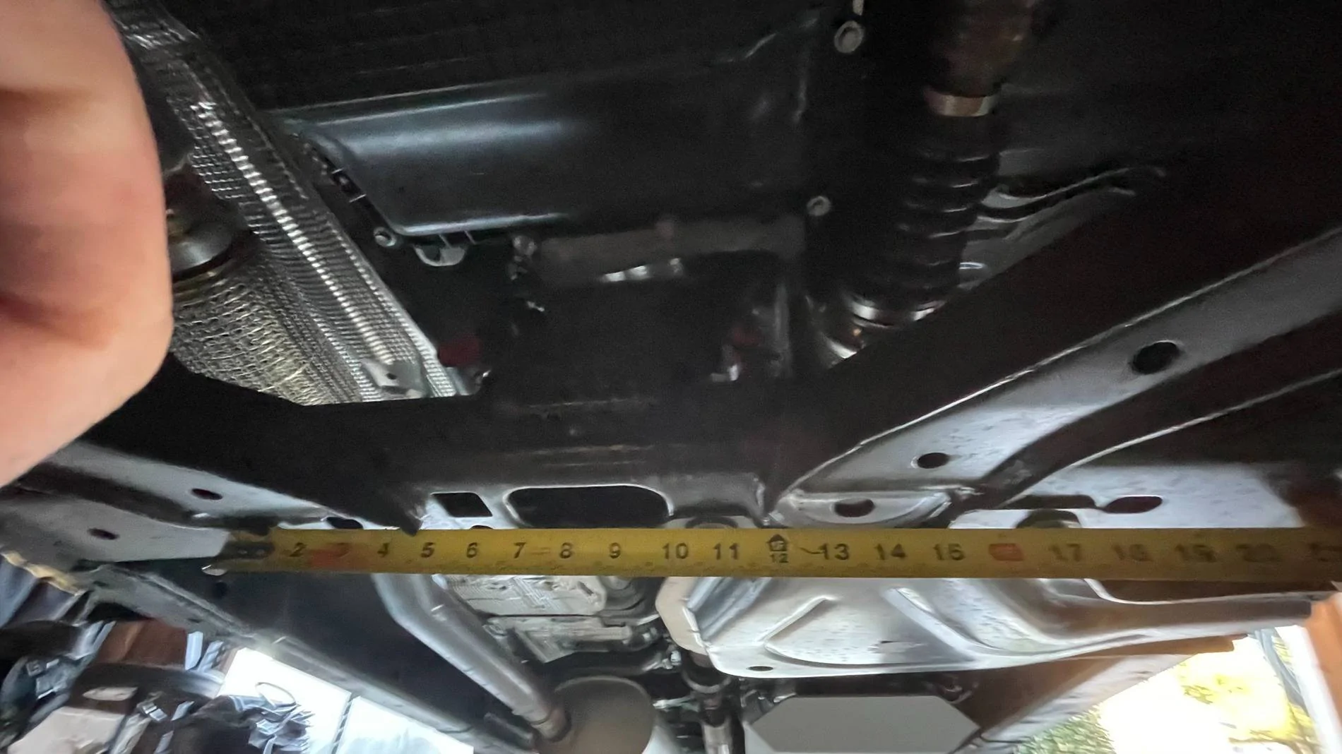

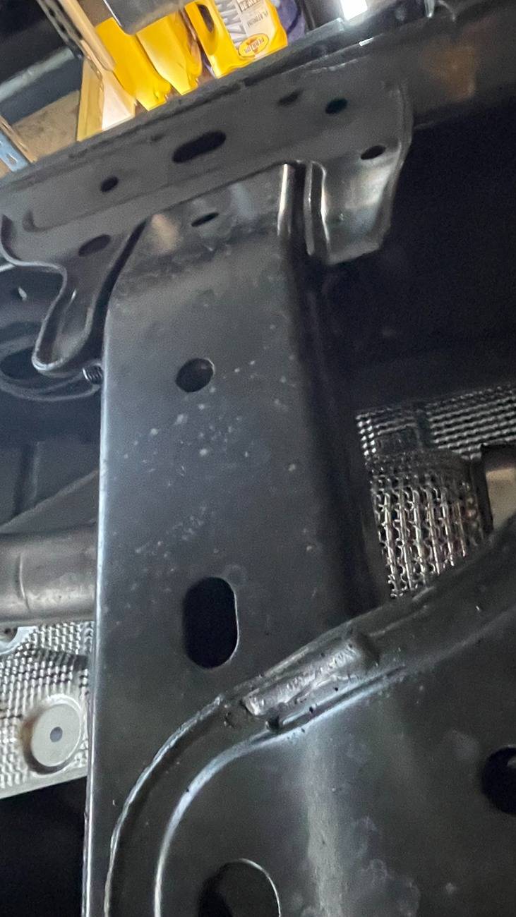

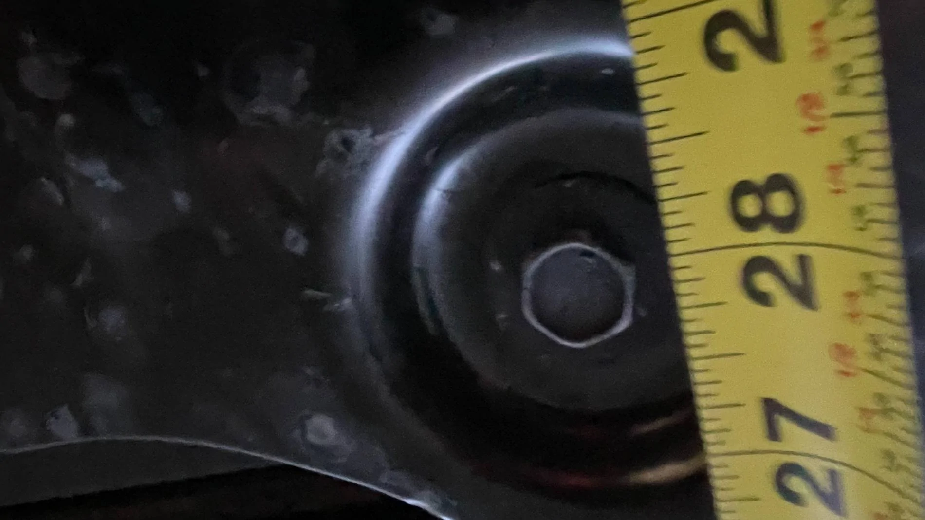

Note. the Plate i got does not fit my 2024 XLT 4x4 non FX4.
The holes accross are 20.5" on the plate, and the Ranger holes are 18.5"
Longwise, the plate is 30" and the Ranger is 28"
Customer service also told me that this plate will not work with the Stock Ford Transfer case plate, that it must be removed, and that their trandfer case plate must be used instead. -
Me- "I recieved a Rival transmission skid plate for my 2024 Ranger. My Ranger has a stock Ford transfer case skid plate. Does the Rival Trans plate fit with the stock transfer case skid plate?"
Rival- Hello,
RIVAL aluminum skid plate replaces factory steel cover.
Me- "The question was does the Rival Transmission plate fit with the Ford Transfer case cover? It's a Yes or No question. The description makes no mention of it being an issue."
Rival- "Most unlikely, as they use same mounting locations.
Thank you,
Regards,
RIVAL USA"
FYI.
See Pics.
Rival- Hello,
Thank you,
Regards,
RIVAL USA"
FYI.
See Pics.
