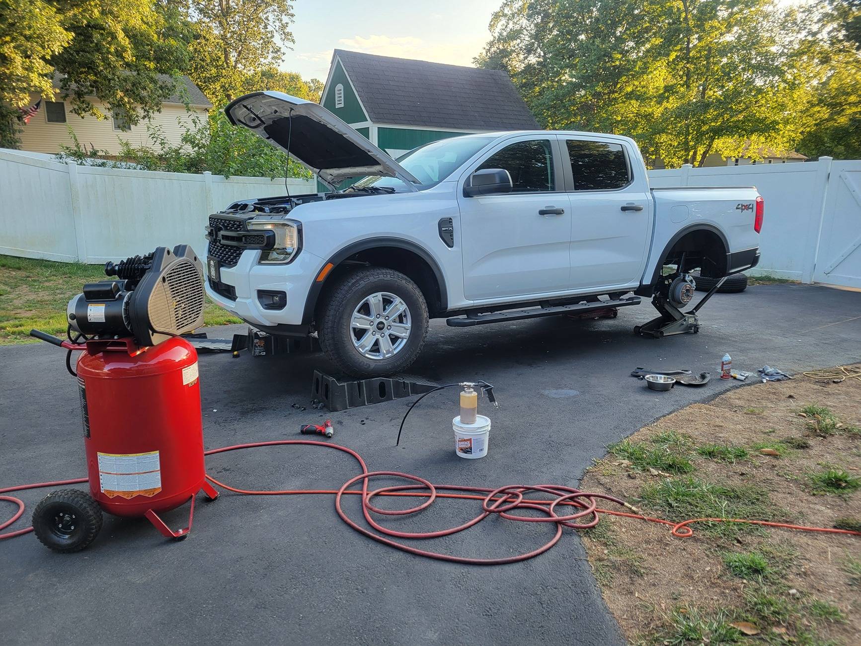

Worst case, I will return them if they do not fit. I noticed these holes also last week when I was underneath fluid filming it and douched those holes pretty good with the film just in case.

That’s how I found mine … I used the wools wax this time supposed to be thicker than the fluid film. I couldn’t tell much difference

Truth be told, I actually used Blaster Surface Shield. Been using it the last couple of years. WoolWax is pretty good also and a step over Fluid Film.

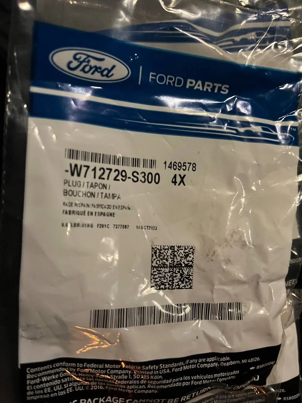

These are the plugs that Ford gave me. I haven’t tried them yet

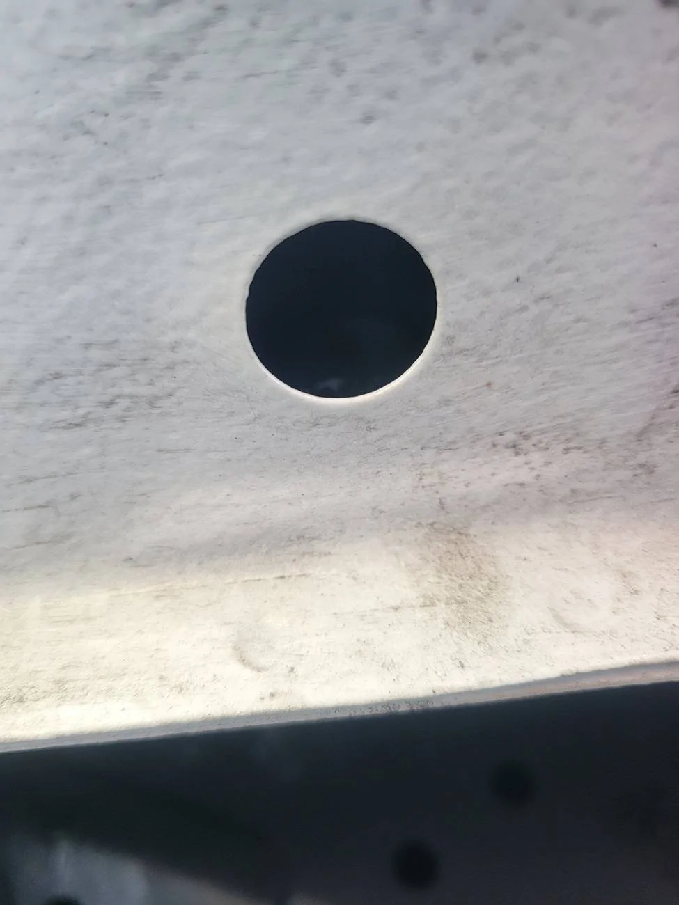

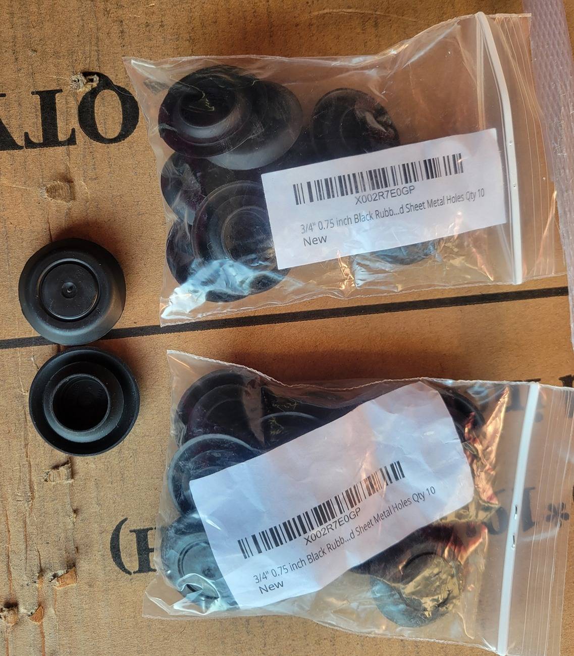

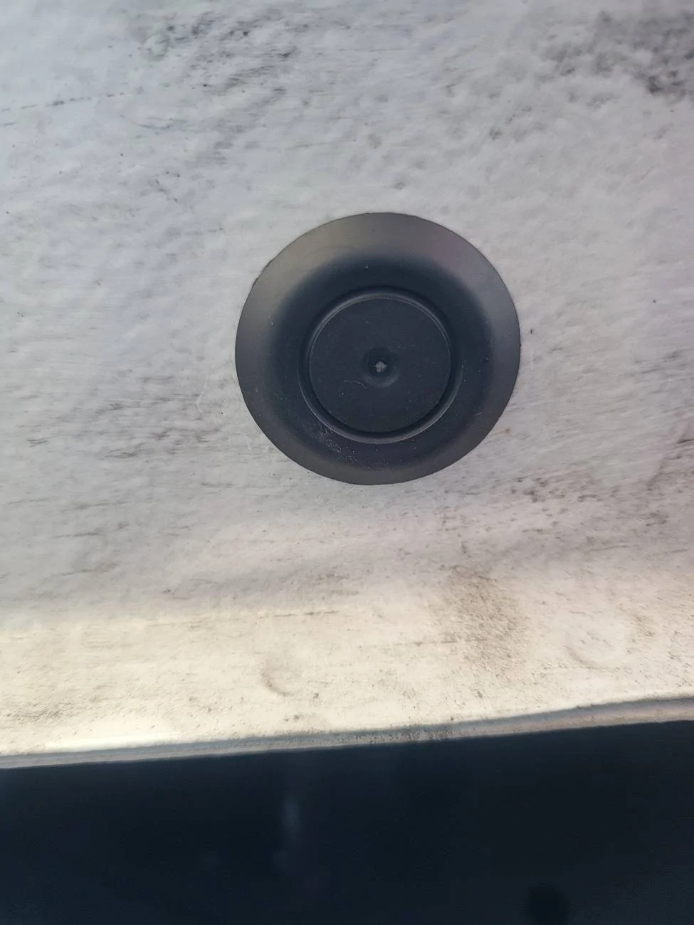

Got the plugs from Amazon mentioned in my previous post. They installed with no issue and fit great. I do not think these holes are meant to be left open for any drainage as there is drain opening at the bottom of the pinch welds below these holes. Think this is just another quality escapement from Ford once again.

I haven’t installed the ones from ford . They gave me 10 instead of 20. I guess they thought the truck only had I rocker panel. lol

Do not.
Fixed my post.
