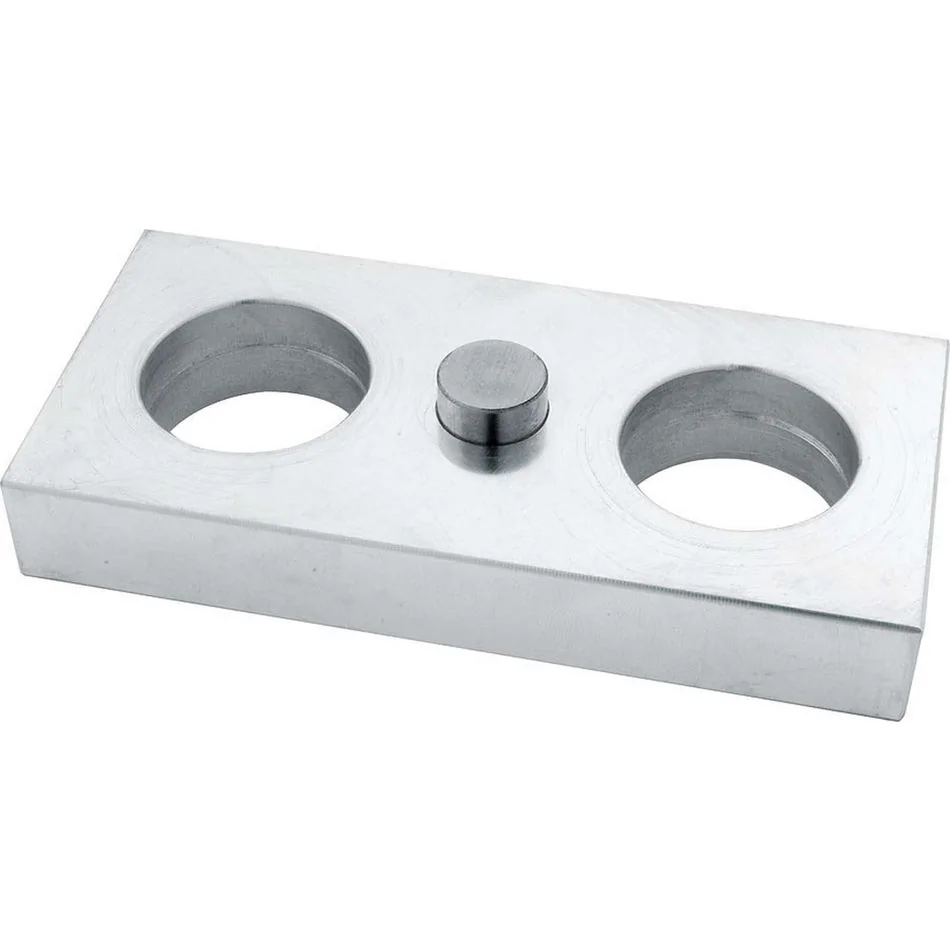

Yes! That would be extremely helpful if you could provide me with those measurements. I ordered the blocks from Real Truck, and the pins on these are 1/2 inch.

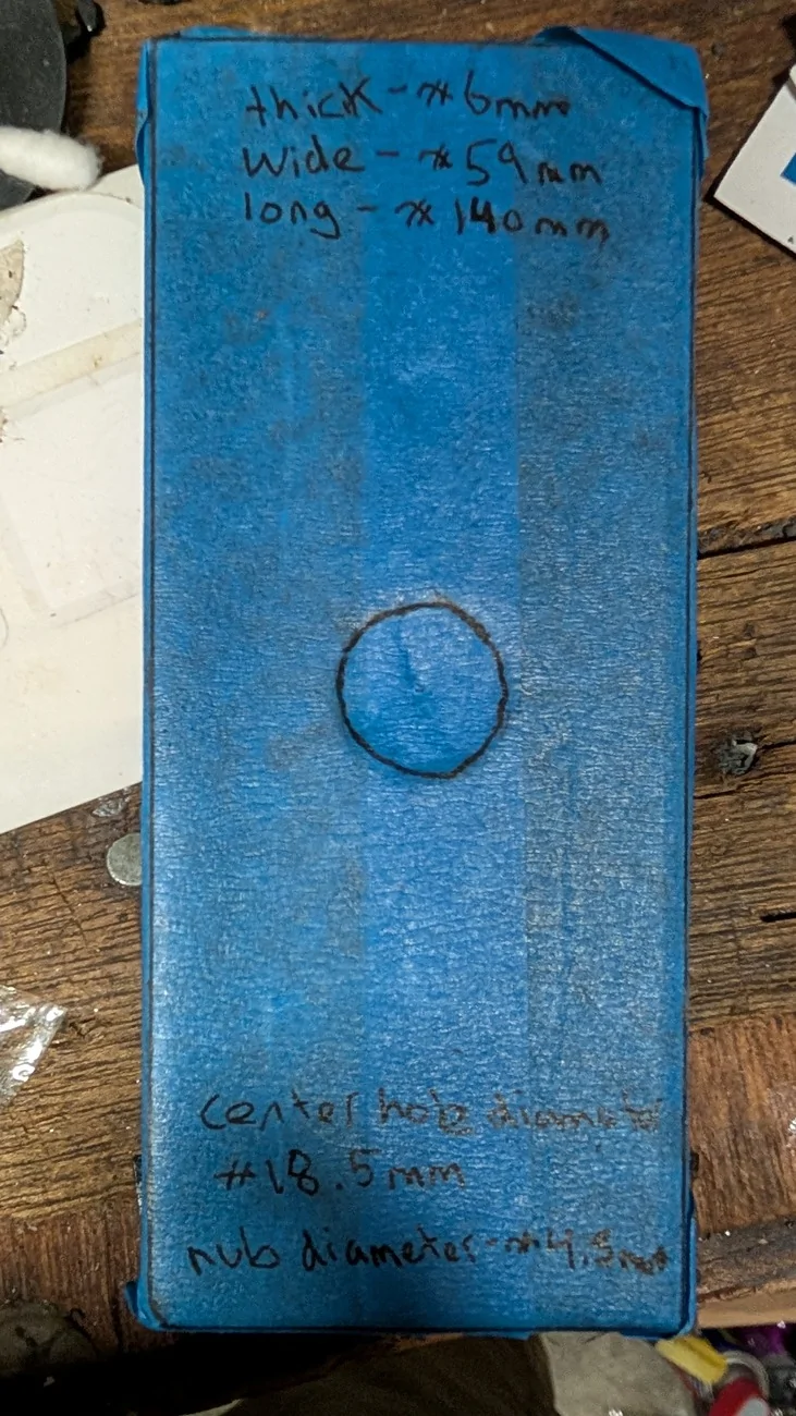

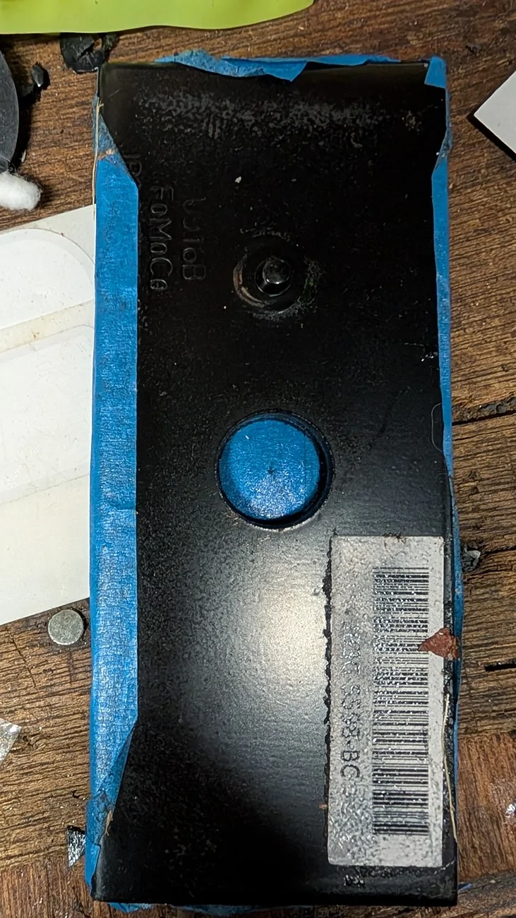

Yes I think your ok the All Star performance blocks I fitted were claimed as 9/16" and 5/8" pin diameter and I definitely needed to machine them down to fit based on either claims, I don't remember which was accurate for the AS blocks. I would say 3/4" is maximum for OEM hardware. The aftermarket block I used and OEM driver block with dimensions are pictured for reference. I think I was going to make or have made blocks based on the measurements at one point but it would have been a lot for one pair. The center hole diameter on shown OEM block is ~3/4" diameter and features a locating nub as well shown
