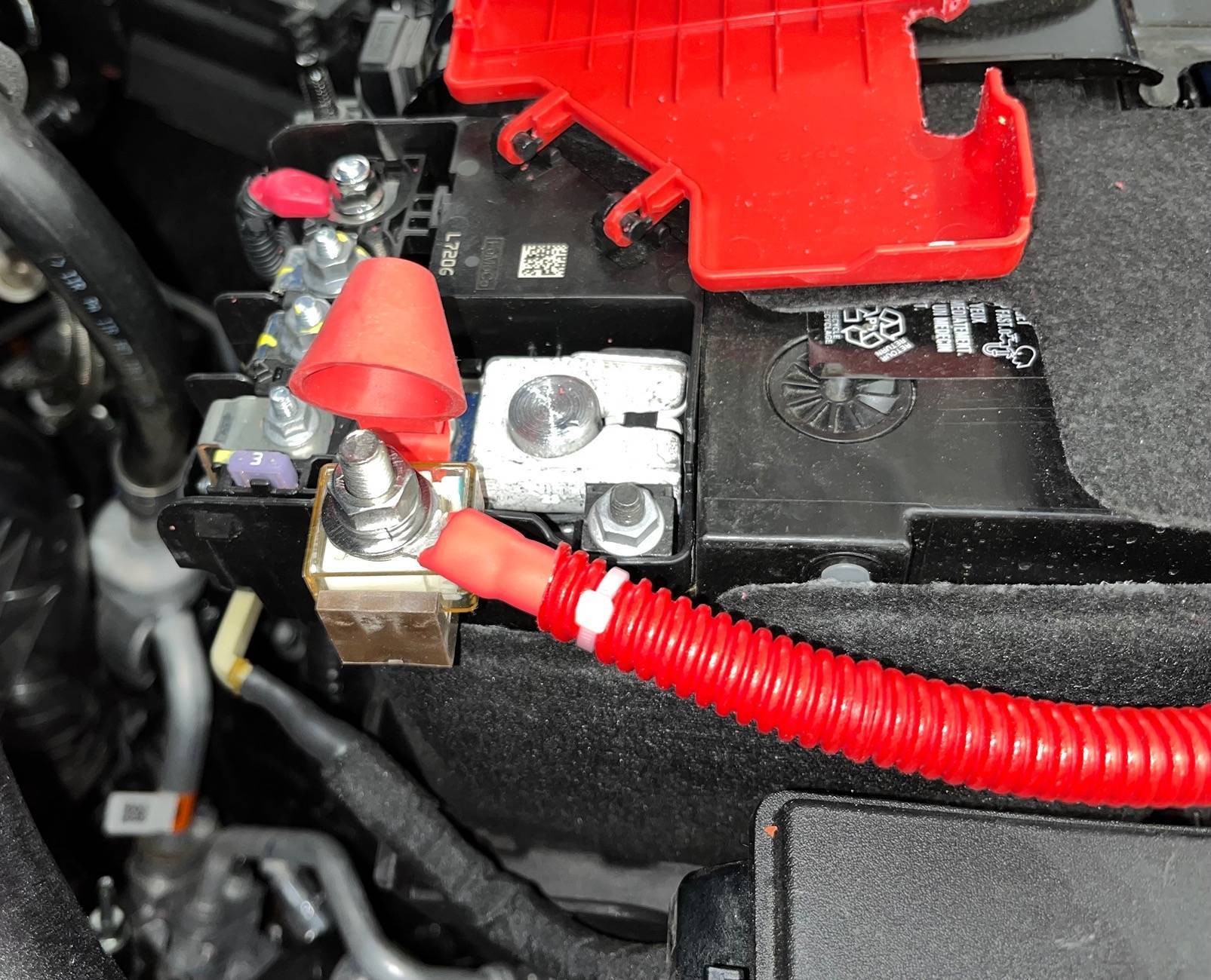

Be sure to add a fuse right at the battery connection, either inline or on the terminal itself, and also run the ground wire to the battery, don’t rely on a chassis ground, that is problematic and is considered to be poor practice.

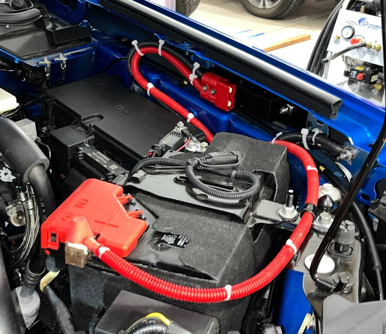

John Davies
Spokane WA USA
Ford Ranger Shielding longer exterior power runs IMG_8128
Ford Ranger Shielding longer exterior power runs IMG_8127

That's clean.
It's a very practical, elegant job.
