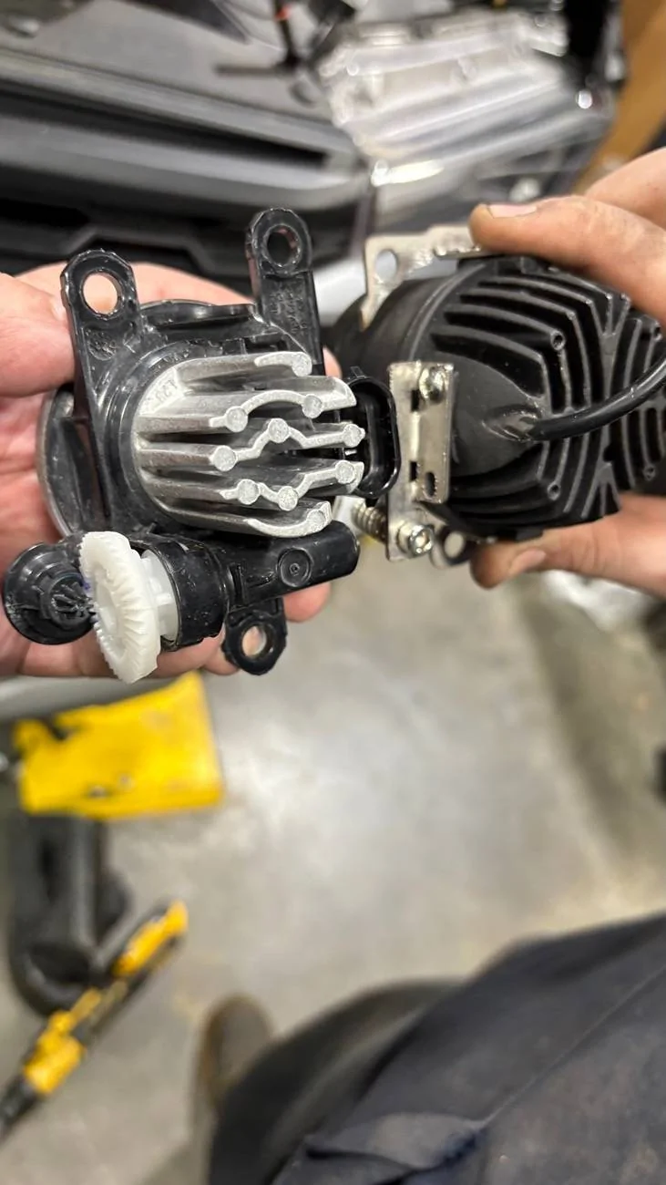

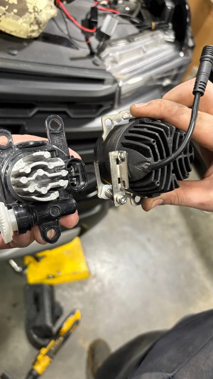

has anyone installed the signature lux direct replacement fog light On their RR? I purchased them and went install and was not impressed with the fit - do gave up for the time being. as I see it you would need to take a lot more off the inner fender as well as the tire. And still the light will be well receded behind the opening. Advice, help?

The best thing to do is have a shop install them because you have to cut-off
a part of bracket to make fit except spot. It does not tell u were to cut in there instruction manual. Other then that they work great .The long beam is great on country road, bought xmas bundle with front 3 white lites ,awaiting for S&B Air Filter kit to install lites with cleaner since the front end needs to be removed for better look my opinion . my one complaint was shipping slower then snail with a story every time you asked about hoped that's change , Im Fedex retired Enjoy.
