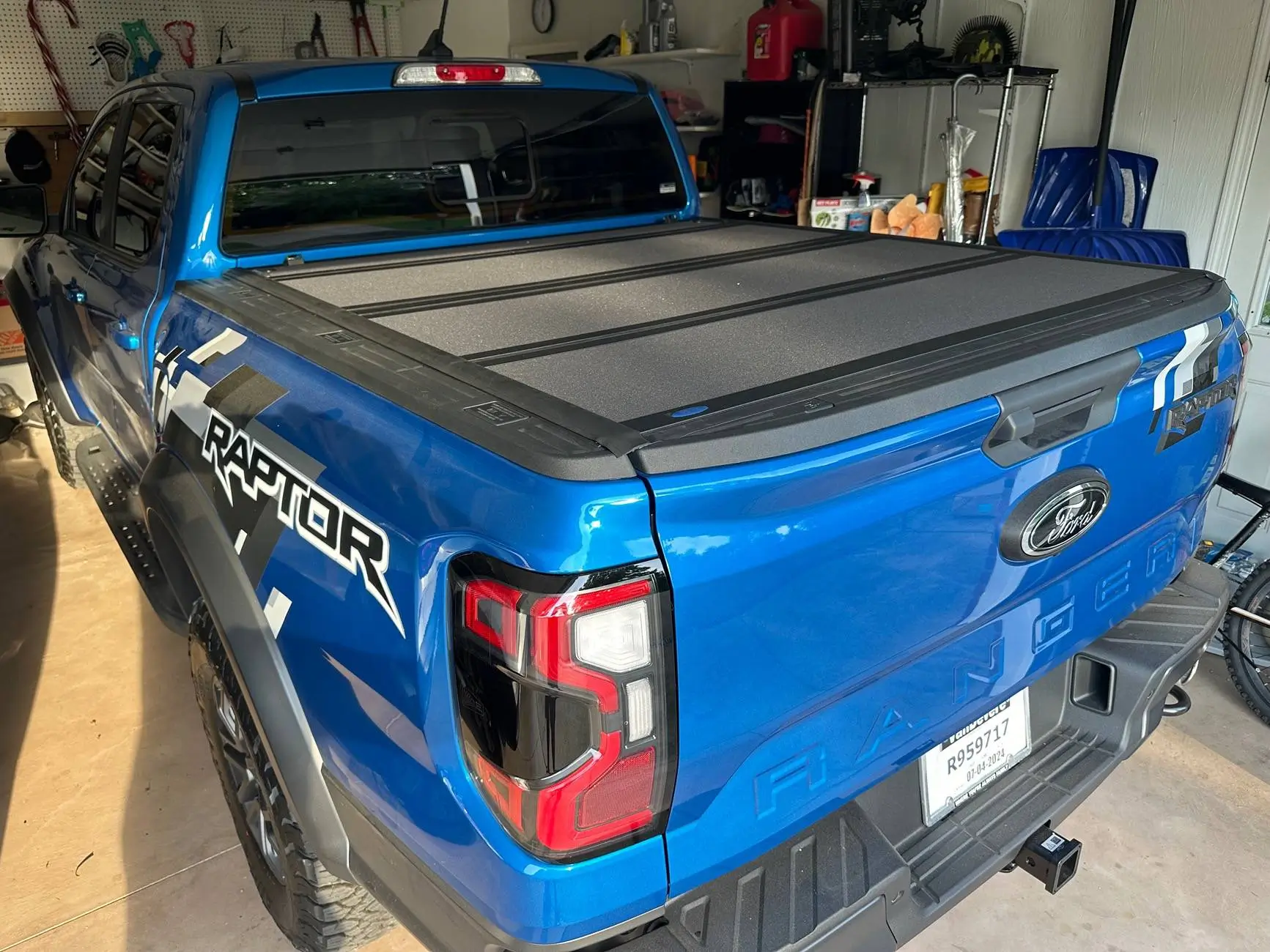

Here's a photo of a Bakflip MX4 I found from @Mitch65 here on the forum for reference. I'm also curious how you would like to incorporate the BRAPs here, or if I misunderstood your question about that as well.
