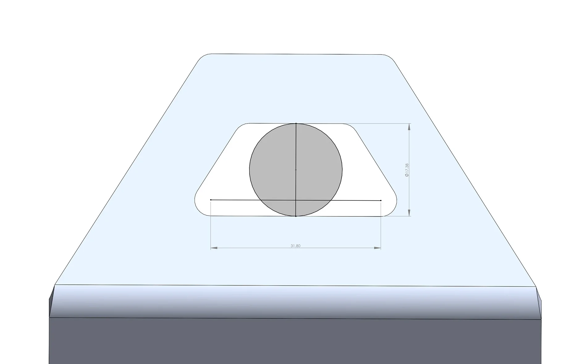

How big is the hole on the tie down pieces, hard to get a scale of how big a rope or whatever will fit through that?
A quick-release system is cool, but outside of the scope of this product. It may be possible to attach that directly to the spacer stack, though and not need the light bracket.
Dimensions attached.

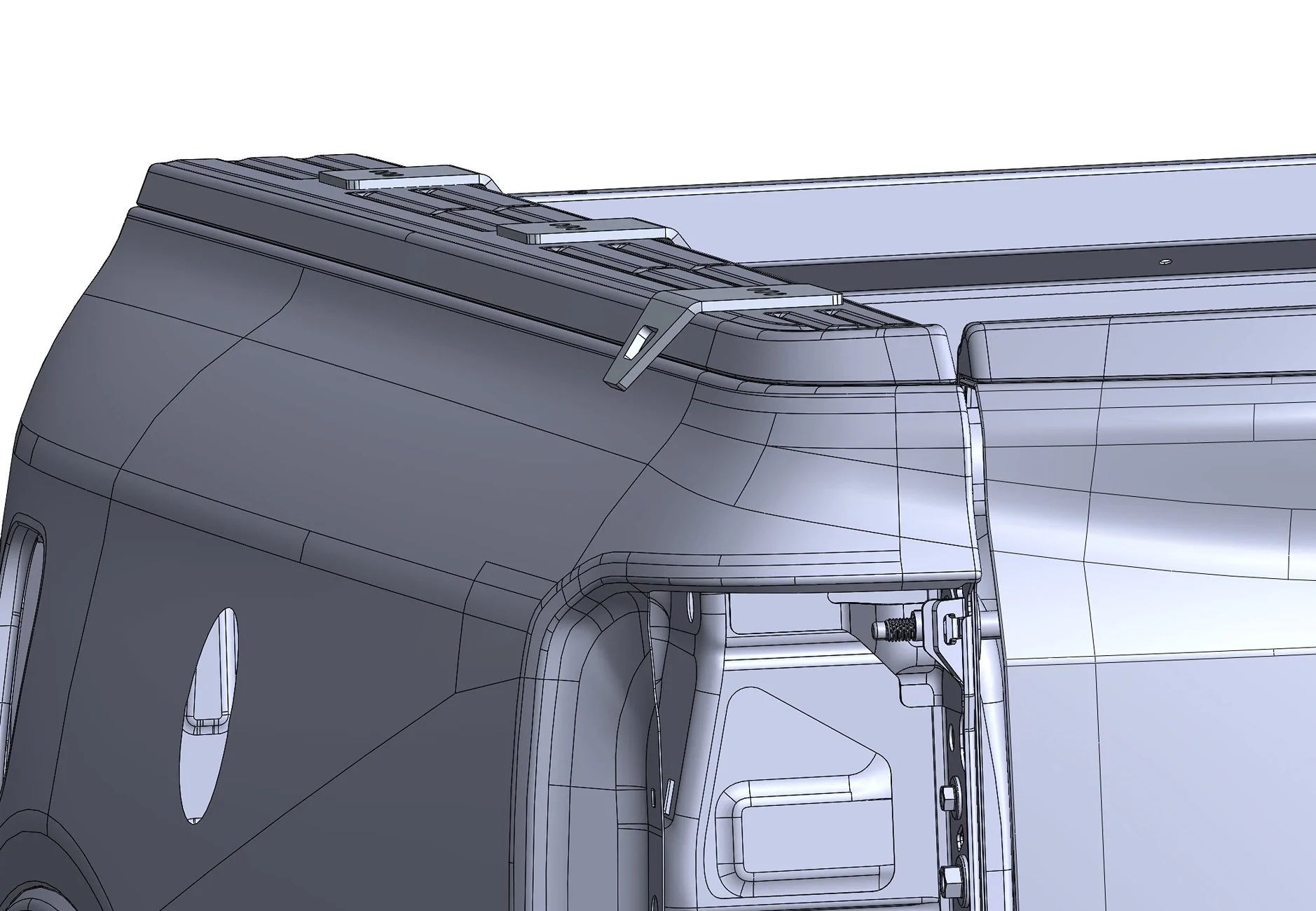

I think you would have to turn the bracket around to use with a cover.
@AdventureLab
my comment in general is that design consideration should be made for accommodating covers for items that attach to the rails.
and while I think the brap de-sign is quite clever
Where I would use a bed rail attachment point is probably going to being pulling some thing down and by moving the attachment point clip on point away from the center of the rail you have increased the moment that will be created on the rail and the bracket.

Could the mounting D ring be made to fit under the bed rail cap (is the cap needs to be trimmed, so be it), with the spacer block above to sit flush with the bed rail?
Can they be turned used externally like the ones on the old Explorer sport trac? I love the idea, but want to know how flexible the mounting options are. I can see using something like this in a lot of ways.
AdventureLab
AdventureLab
Brit
Mar 14, 2025
53
900
1,296
St George, UT
'24 RR
If you didn't mind trimming the rails, they could definitely work that way.
As for mounting them outboard, if you turned them upward, they would work, but if you want them turned down, only the rear one is going to work due to the shape of the bed rails.
