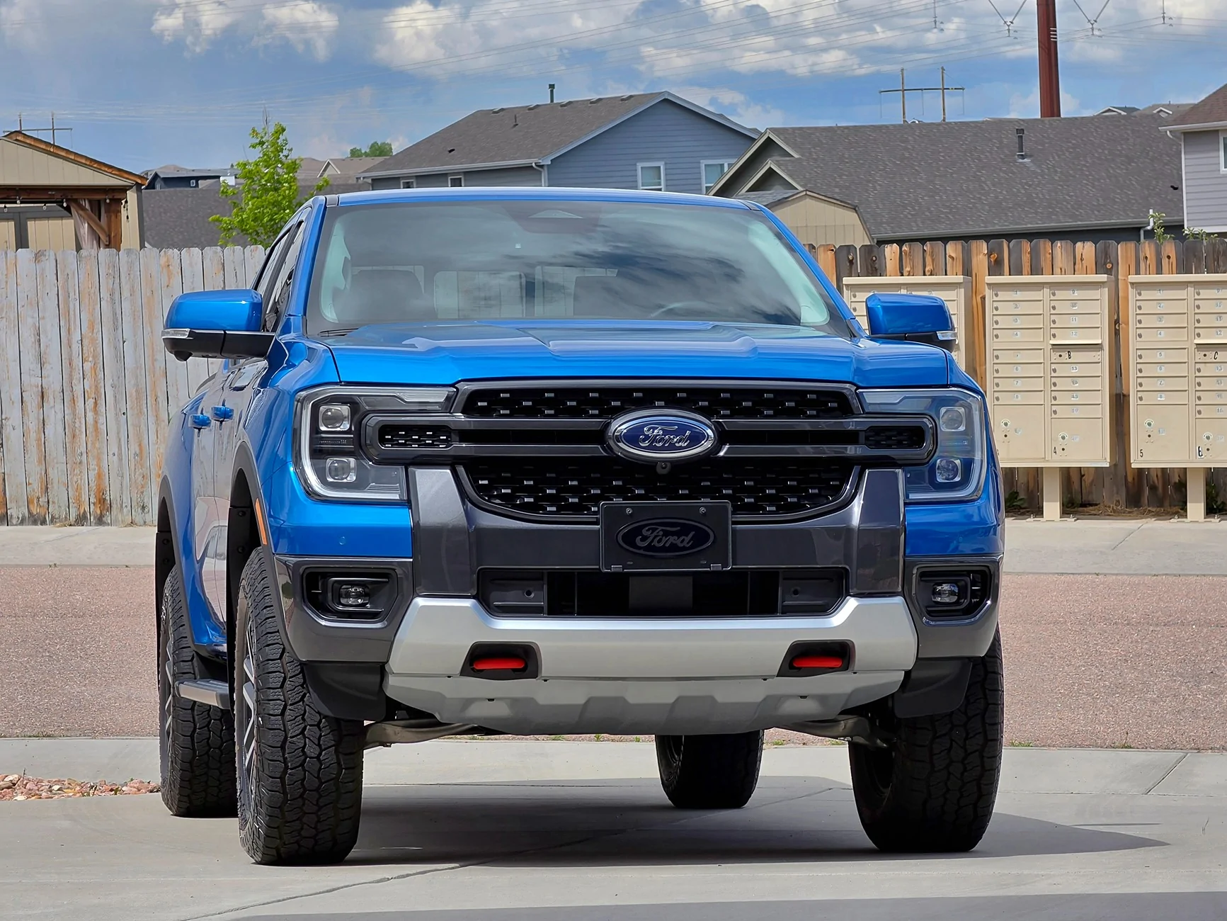

For reference, this is what my 2025 Ranger Lariat FX4 looks like with 265/70R18 Vredestein Pinza AT tires on the stock rims and a 2-inch lift, no crash bar modifications or wheel spacers required.

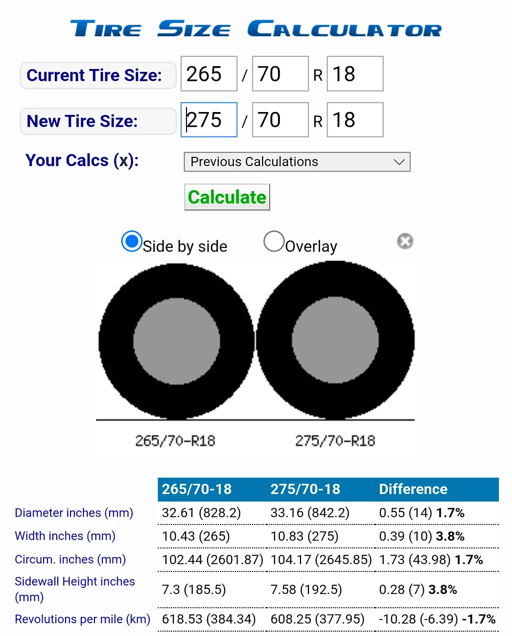

265/70R18 is slightly shorter and slightly narrower than 275/70R18. It’s not a huge visual difference, but it gives you better clearance and also provides more options for standard load-rated tires.
The tires I run for example, the Vredestein Pinza AT, are available in a standard load rating at 265/70R18 (44 lbs), but are only available in an LT load rating at 275/70R18. The reason I really like these tires, and have run them on multiple vehicles over the years, is that they’re reasonably priced (I believe even less expensive than something like the Nitto Terra Grappler), quieter on pavement than even the stock Goodyear tires, and maintain that quietness over their entire tread life (unlike the Goodyears). They also have excellent on-road performance, good off-road performance, and very good severe winter weather performance despite being an all-season all-terrain tire.
Winter weather performance is particularly important for me since I live in Colorado, and it may also be important to you since you live in Canada.
Just for reference, I would have bought those particular tires even if they were much more expensive than they are. I spent over $5,000 on upgraded shocks alone, so I had the budget to buy any tire I wanted, but I specifically chose those because of how good I think they are.

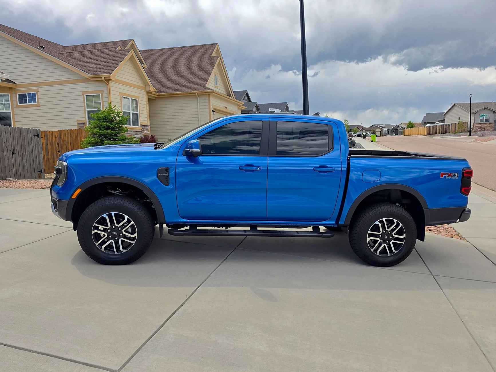

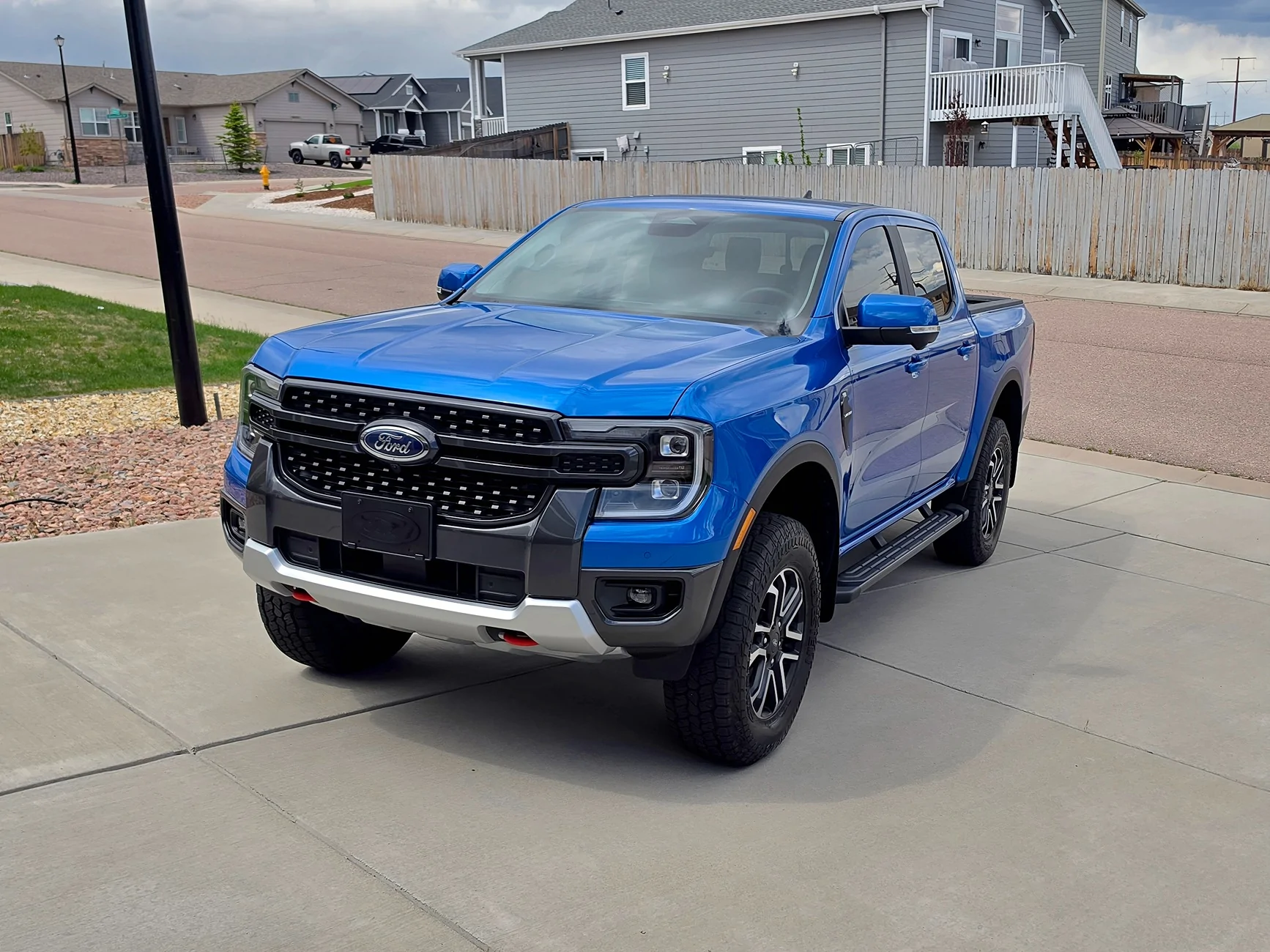

Here are a few more photos of my truck from different angles with that tire size, along with a chart showing the size and spec differences between 275/70R18 and 265/70R18 tires.

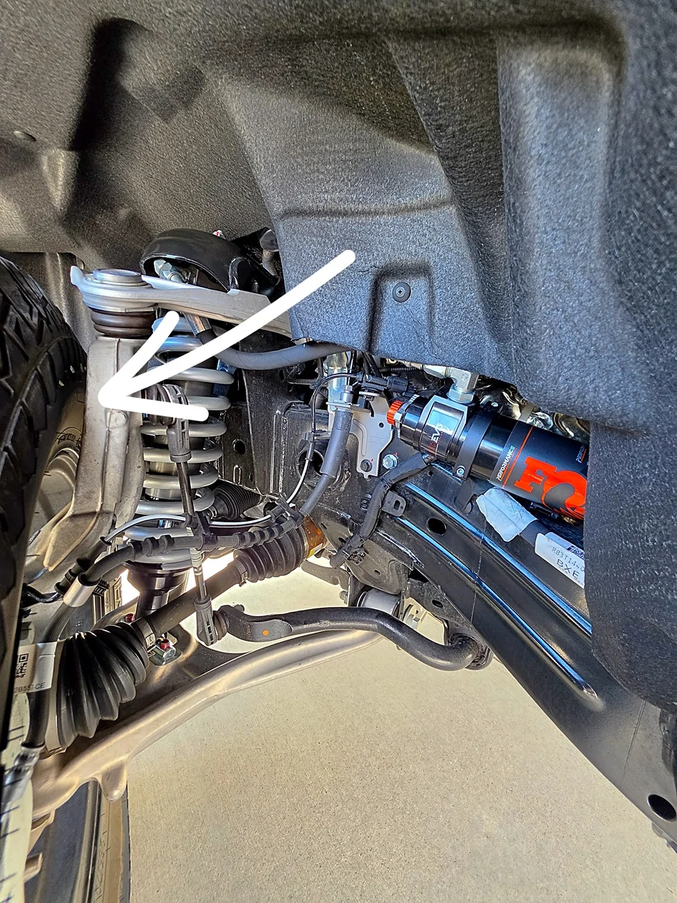

Also, so you can actually put eyes on it, this is how much clearance 265/70R18 gives you with the stock upper control arms. 275/70R18 reduces that clearance by an additional ~0.2 inches or ~5mm.
