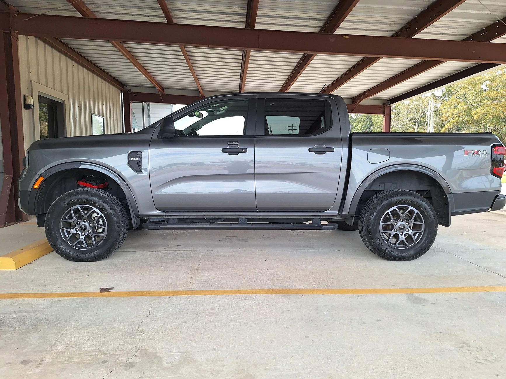

I have a 2wd with a 2.5 spacer on front and 1" shackle lift on the back. Gave me back a little rake so I can still tow properly.
I keep stock size tires though, just a little more aggressive tread

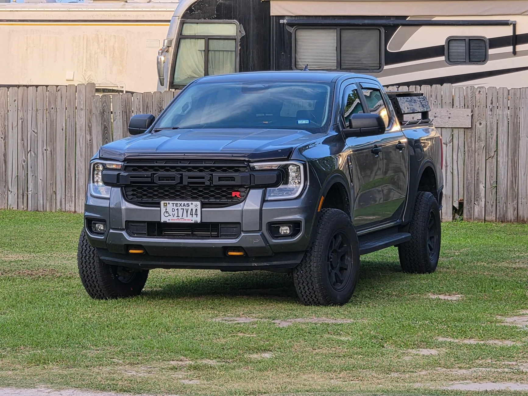

That was exactly my issue, it was so level it looked front high so I did the shackles.
It came out perfect and I always get compliments in how it looks. I imagine you will end up in the same boat
