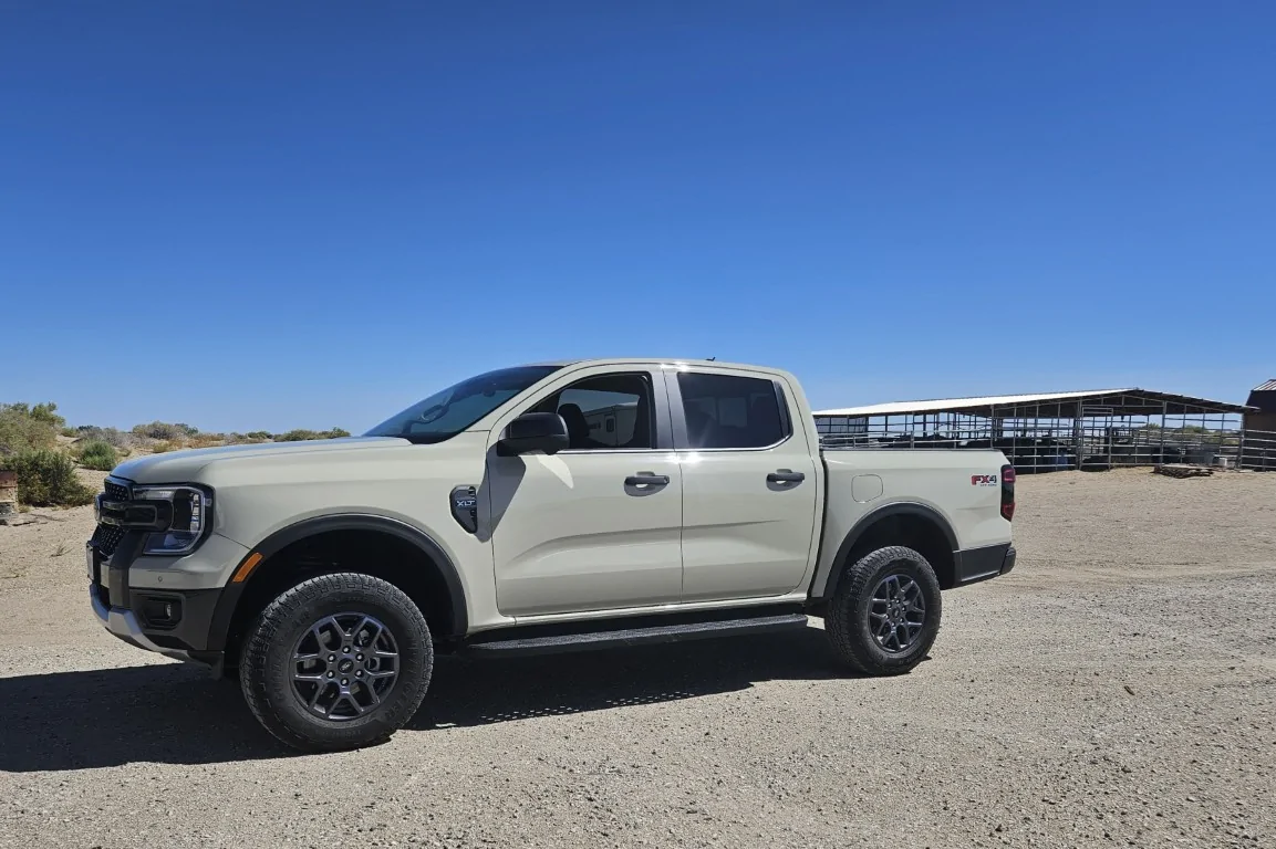

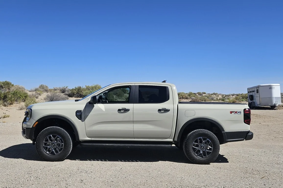

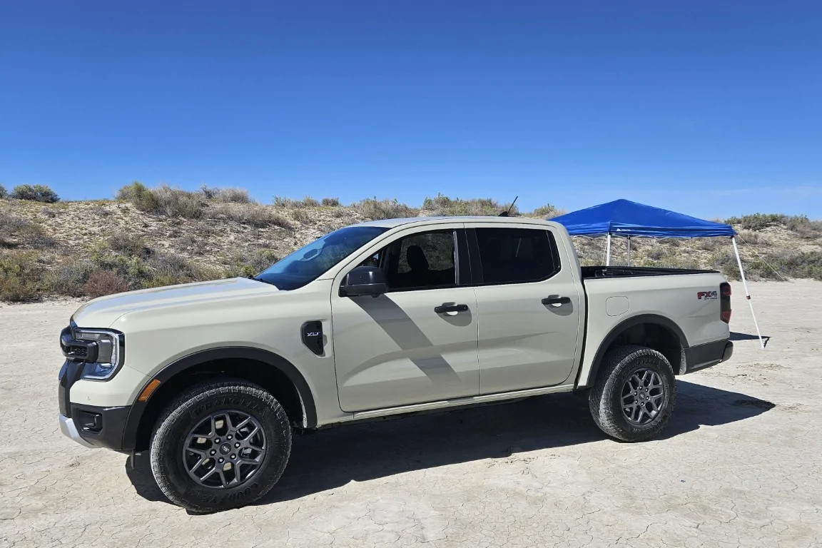

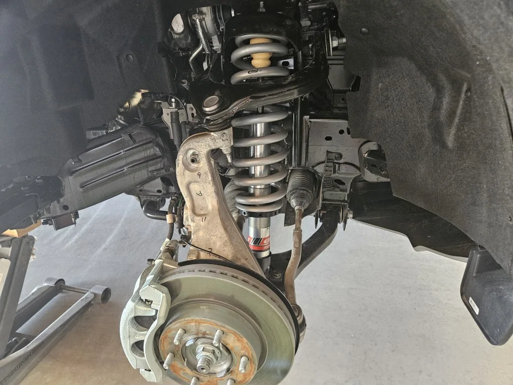

I had the local Ford Service Dept install the Eibach struts on my Ranger yesterday. I have the knowledge, tools and space to do it myself, but in my 70s now and just didn't have the motivation.
These are the struts that you adjust the spring preload for the 2.3L or 2.7L engine. I left mine set for the 2.3L because I wanted to see where the lift ended up with a 2.7L. Figured I could adjust it later if need be. I'm pleased with the result so no adjustment needed.
I was looking for 1.5"-2" lift. The 2.3L preload gave me right at 2". Perfect.

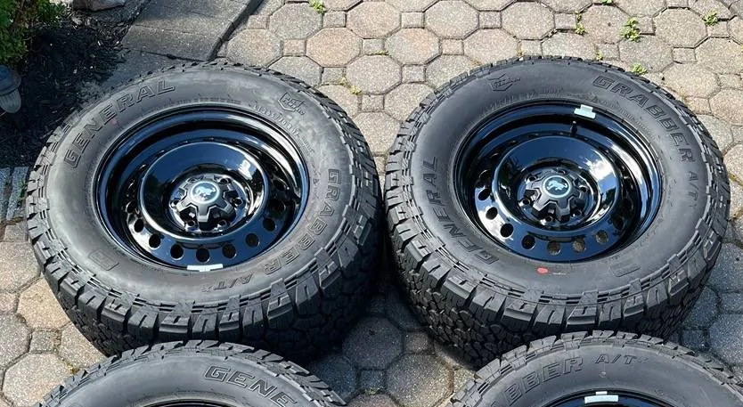

Oh, and yes, those are the stock tires. I recently got some Bronco Steel wheels from a member of the Bronco6G forum. I'll likely go with the 265/70 tires so it will look like these.

Thanks. I've always preferred steel wheels on vehicles I take off road a lot. I've been known to scratch wheels and a little black paint will touch up a steel wheel. And I think those will look great on the truck. The wife is kinda meh about the wheels but it's not her car :wink:.
I haven't really drove it enough to form an opinion yet but I'll report when I do. I still need to get it aligned and don't want to drive it too much until I do. Initial impression is maybe a little firmer than the stock struts.
I also still need to install the rear shocks and will probably do that in the next couple of days. I sprayed some clear coat on the rear shocks today because of a site member's report about the Eibach shocks showing corrosion after a trip over Donner Summit in the winter.
