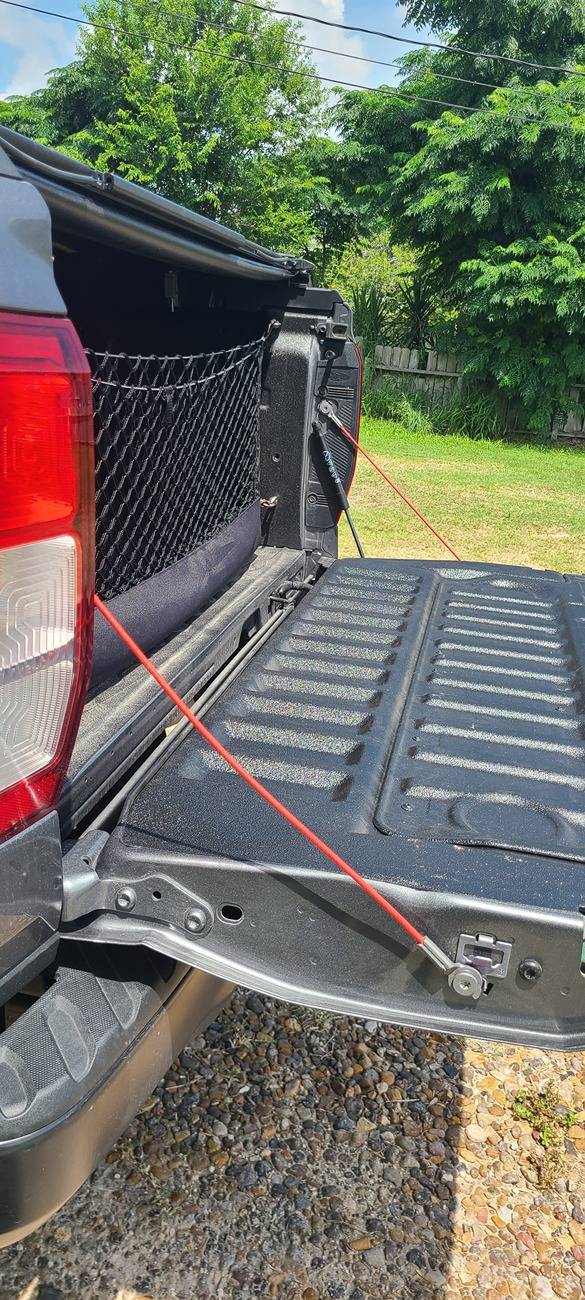

The more I look at the tailgate cables - I’m thinking the passenger side cable is tighter to protect the strut from getting too stressed. Which to me makes sense. I could be totally wrong.

Ha! I just noticed my cables are the same. Ha ha ha. How long ago did this start snd i just noticed, ha ha ha
