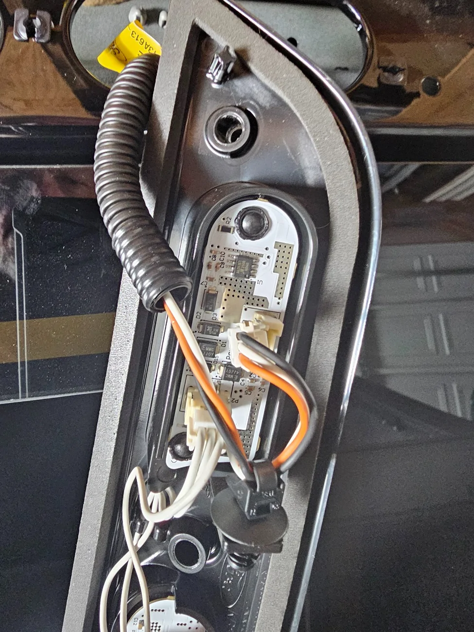

I replaced my third brake light. It works great, looks great, and I love it. Because I'm a moron and can't leave well enough alone, I replaced the OEM silver screws with black ones that promptly rusted. They are spinning in the retainers and I can't remove them so I may need to drill them out. Before I go this route, I'm trying to figure out why the screws are spinning in the retainers so that I can attack the problem correctly. I don't remember seeing the retainers when I installed and I might need to buy new ones depending on how this all goes. Does anyone have the diagram of how the cab brake light is attached, and what the part number is for the retainers? If anyone has pics with the cab brake light removed that would be a big help. I don't think the retainers can be accessed from behind the headliner and I think I need to remove the brake light to get at them.

Can't help you with removal other than see if you can apply some outward pressure to them while backing them out. If you want black hardware do not buy black carbon steel. Get some stainless steel that is coated black,
Don't use crappy hardware.
This may be what you are looking for (top-left corner of photo):
Ford Ranger Third Brake Light (cab) Assembly Help 20250909_130404
Hope this helps, if I remember correctly we installed the same 3rd brake light.
I just spray painted the heads of the original screws.
Good luck! - Morahn

Thanks! I think that plastic retainer is what Im looking for. Appreciate it.
