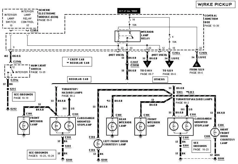

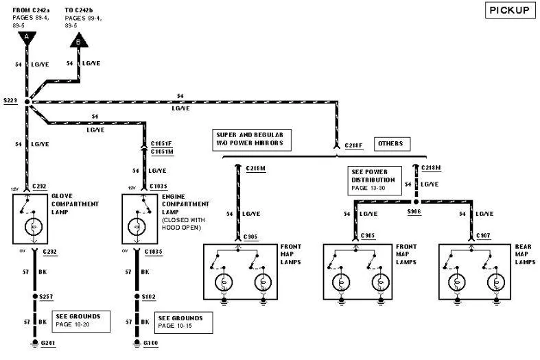

The dome light should be easier to operate than that. There is also a timing relay involved that dims and automatically shuts off the lights after leaving and turns on the lights when you enter. The other possibility is a faulty connection or ground that doesn't allow the timing relay coil to energize the lights. If it is this challenging, consider taking it to the dealer.
From another forum.... Note the GEM module might be called something different with current vehicles and the diagram is from a much older vehicle.
The door ajar light would indicate a ground signal is being sent to the GEM module which controls the Interior Lamp relay. Check the fuse that powers the Interior Lamp relay. If the fuse is good, there could be a problem with the relay or the ground signal from the GEM that activates. Here are a couple of diagrams for the circuits that should help.
Ford Ranger Thoughts after 5 days with this AMAZING Ranger Raptor Wiring
Ford Ranger Thoughts after 5 days with this AMAZING Ranger Raptor Wiring2
