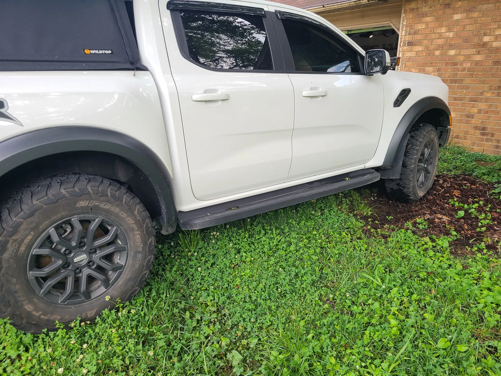

First thing I noticed, the sag from the rack, tent, and gear. 300lb springs are going to be ordered soon, as sitting level-ish really screwed with my visibility, and adjusting the seat didn't help much as I couldn't seem to get it dialed in like before. Braking was slightly worse as well, but not sure how much of that was weight vs rake.

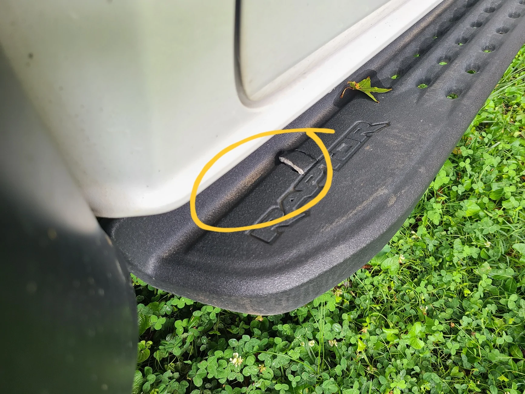

I need real sliders. I made a right turn too tight and got the PS running board hung up on a boulder ballard in a parking lot. I was able to crab walk the truck off the rock, but not before putting a new hole in it and realigning the running board. Kiddo didn't see it either, so I'm not a total idiot, just partial.

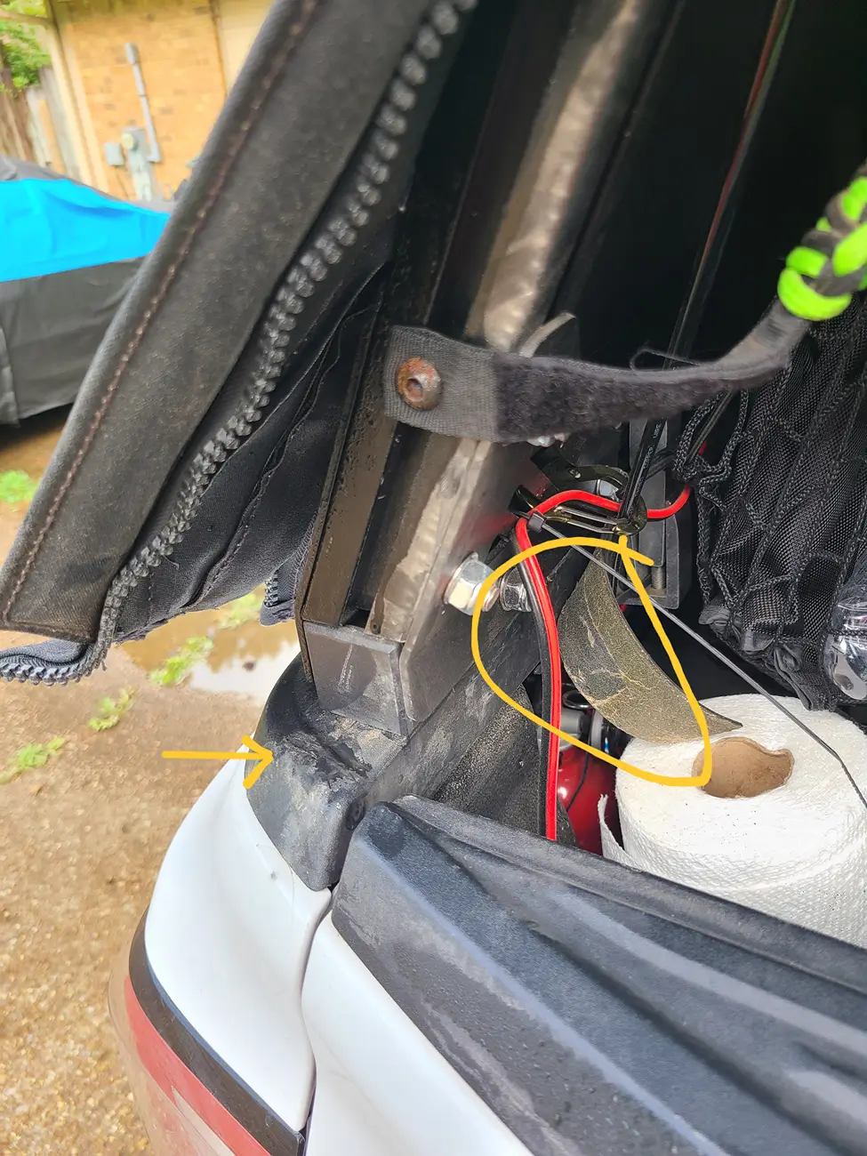

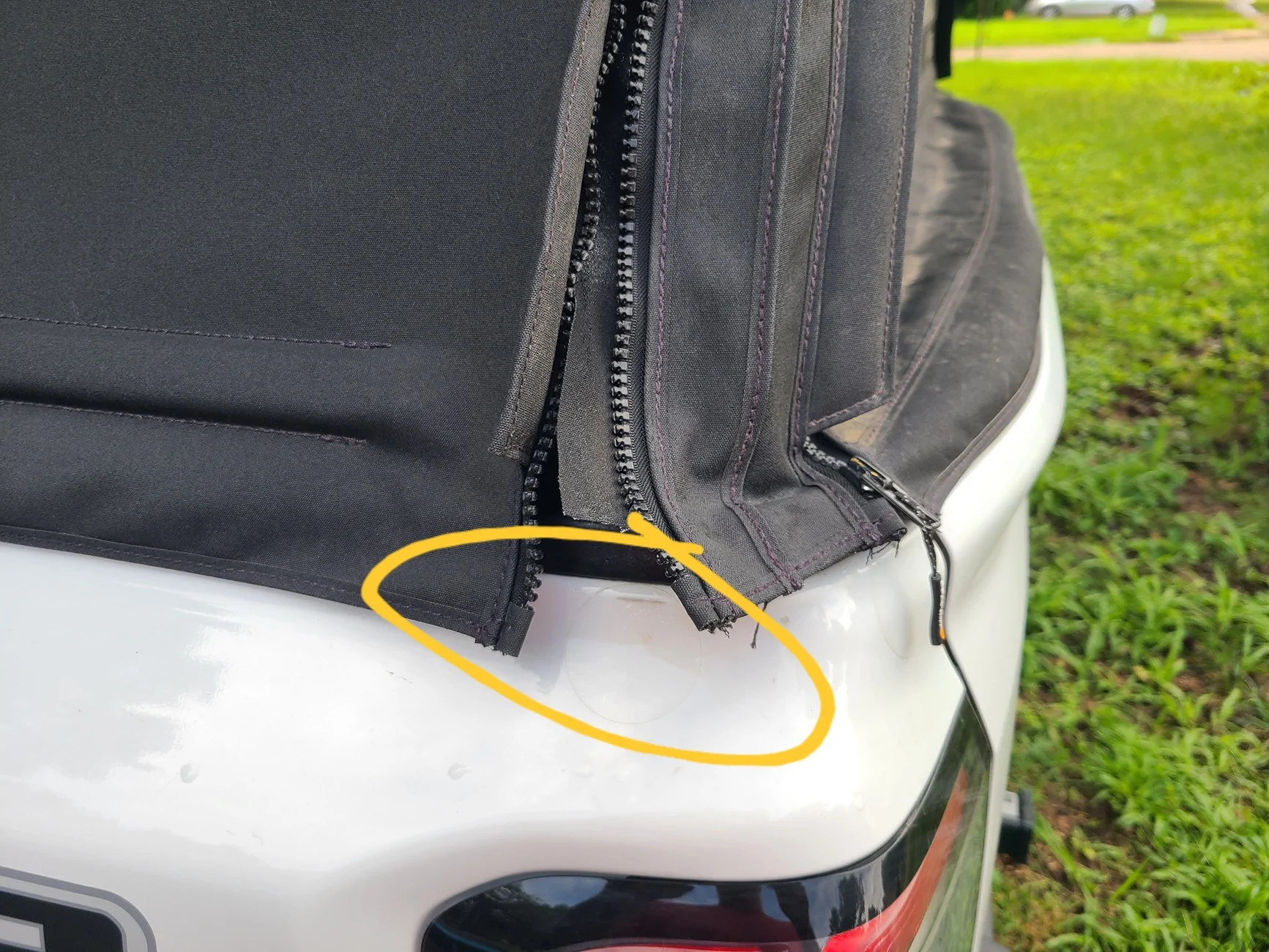

The Wildtop rack I bought cannot be recommended at this time. I had my concerns before the trip and posted them here. After doing the Cathedral Valley loop in Capitol Reef, the clamps loosened enough to slide the rack forward a full inch with enough side-to-side shimmy that the rubber feet on the bottom rails came out. Also allowed the zippers to rub directly on the paint. I had to retorque the bolts every couple days the remainder of the trip. I will be removing everything in the next few weeks to redesign this thing to make it Raptor approved, and might even market my own version.

Running board damage. Not bad, and it held the truck's weight, but I haven't gotten under there to see if anything bent yet.

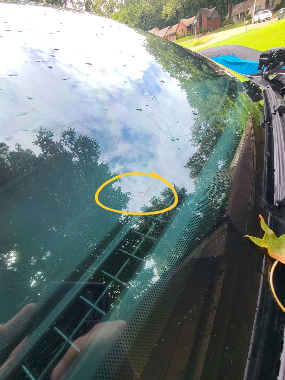

Rock strike from a Tundra with poke. It's hard to see, but the lower circle is about the size of a golf ball.

The rack. Wildtop can kiss my grits. I told them this was a bad mounting solution. The arrow points to a small gouge in the rail cap where the rack was originally located. Circled the rubber foot hanging out.
Ford Ranger Thoughts after our 8k mile trip to Olympic NP. 20260622_133707
You can sort of see the difference in zipper location in this one, but the lovely scratches don't really come thru.
Ford Ranger Thoughts after our 8k mile trip to Olympic NP. 20260622_133646

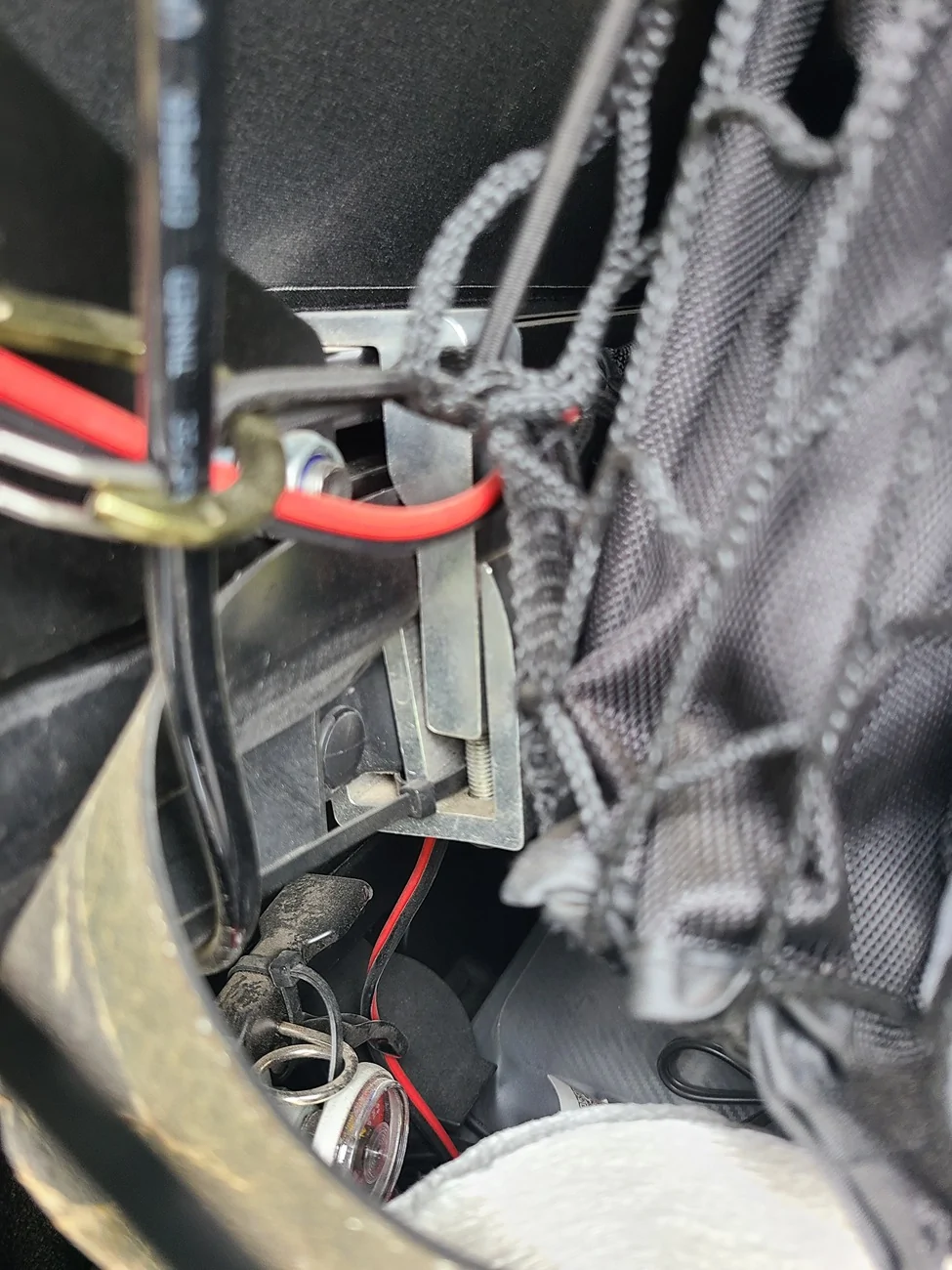

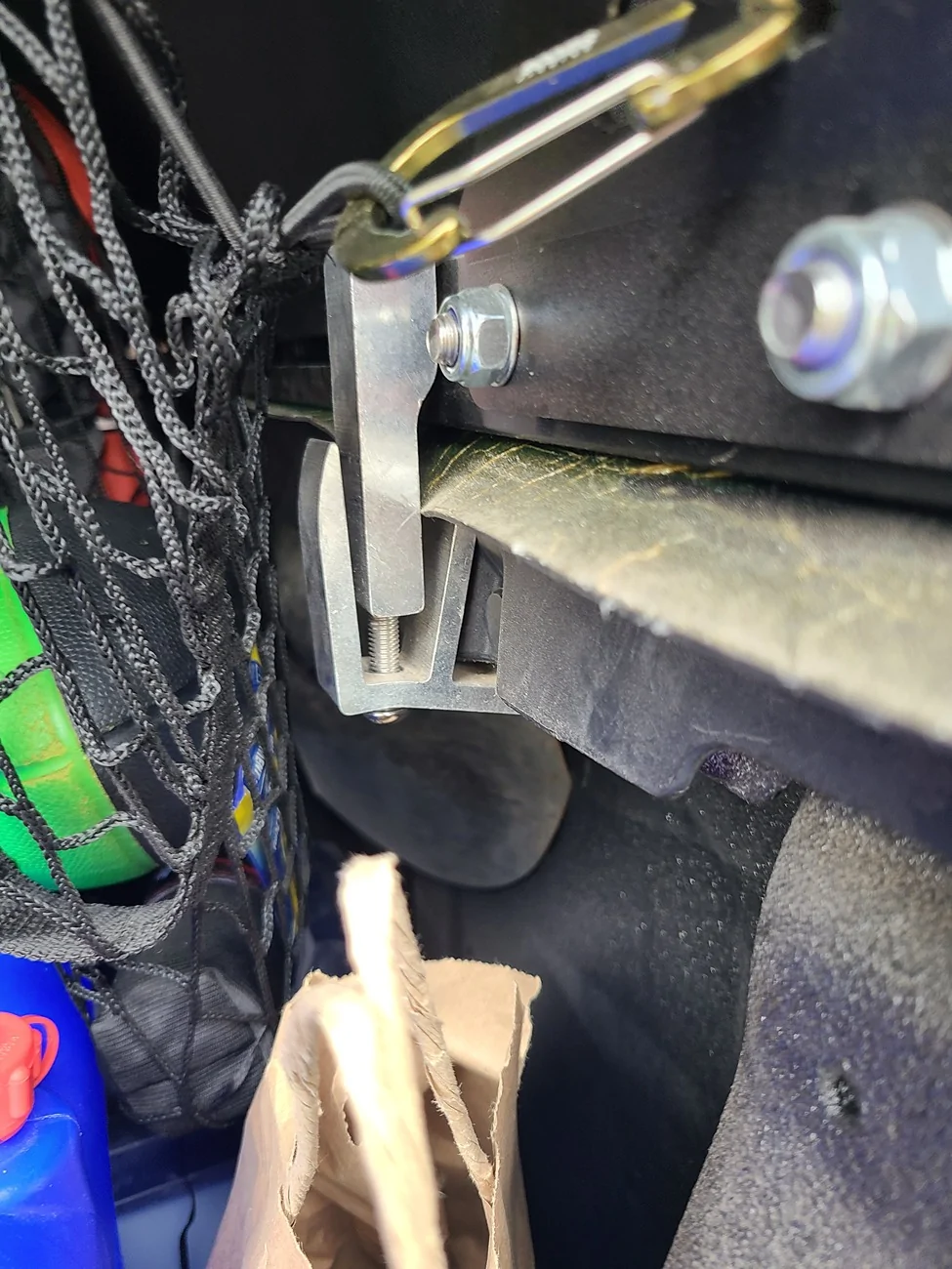

Clamps didn't look like this originally, either.

Just looking at the tire to fender gap tells me you have no rake left. When i put my Honda Fourtrax Rubicon in the bed (751 lbs), I had about 1/2" of negative rake and definitely affected visibility over the hood! I notice a big difference in visibility. Now 200-300lbs in the bed evenly distributed wasn't an issue, just when I maxed out payload with over half of it in the bed.

Yeah, total trip payload was easily between 500-550lbs with 3 weeks of clothes and the rest of the camping/trip gear loaded up. What I'm most surprised about it is that we have very little we need to trim from our setup. Only thing we didn't use, that wasn't recovery or emergency gear, was our individual sleeping bags. Our 0F bag turned quilt kept us pretty cozy at 30F.
