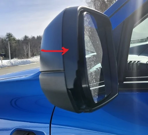

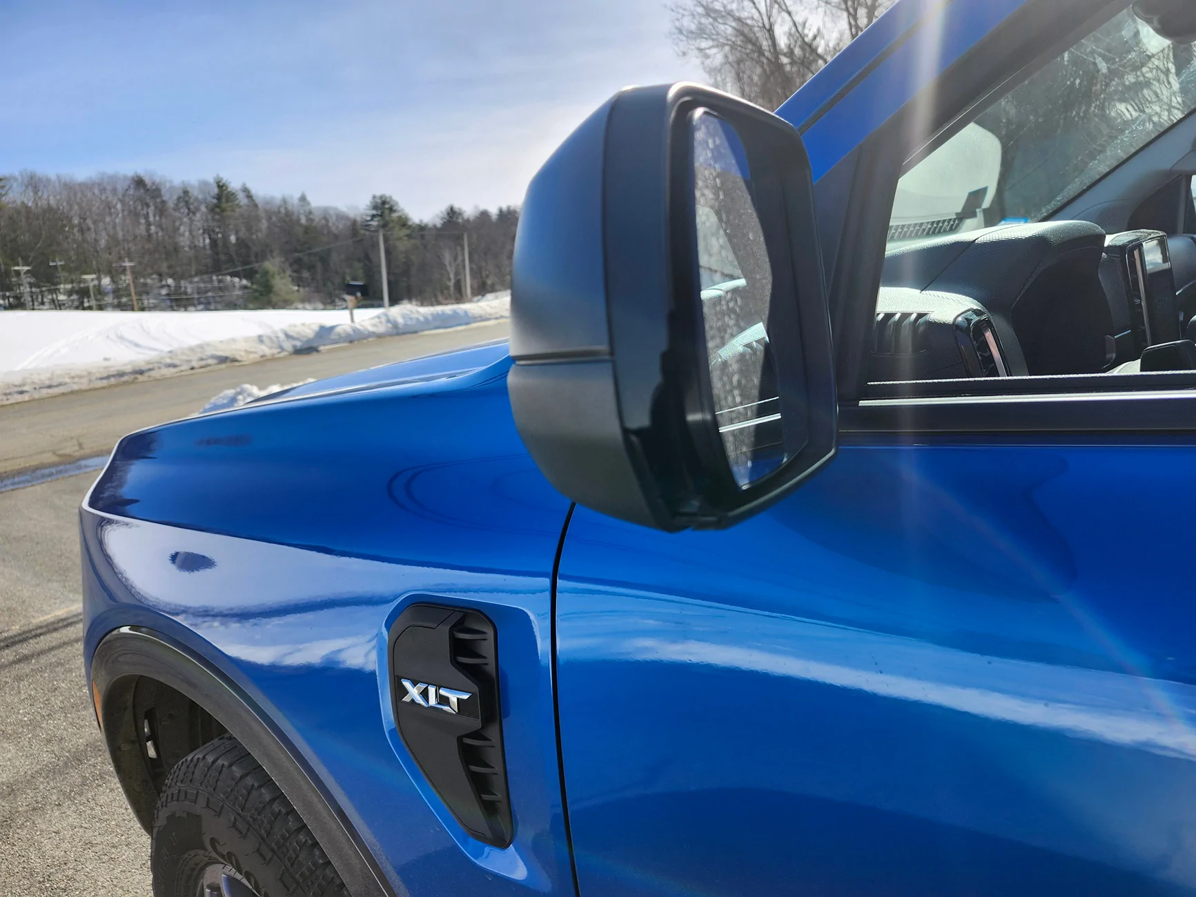

I'll start. Smacked my drivers side mirror on the door frame backing into the garage the other day.
I'll be using the power fold from here on out.
Curious how hard it is to replace. The last time I had to replace a mirror was on my 2003 F150. Mirrors back the were not as technologically advanced as they are today. Any advise would be most welcome.

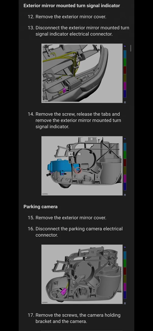

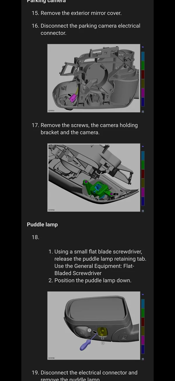

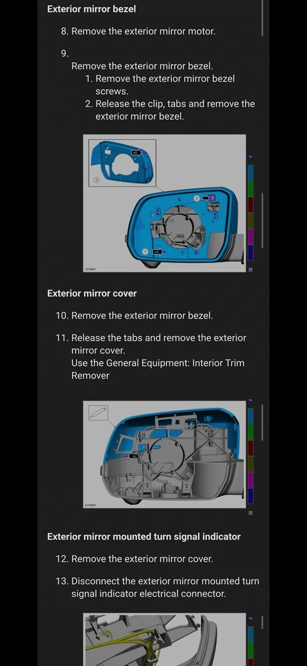

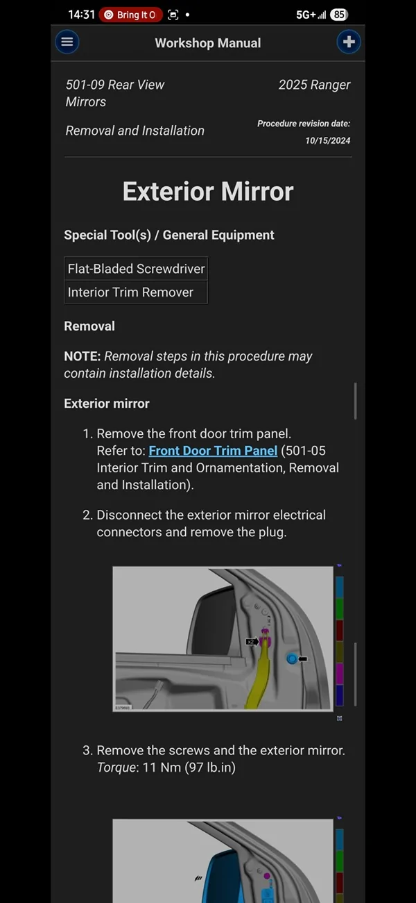

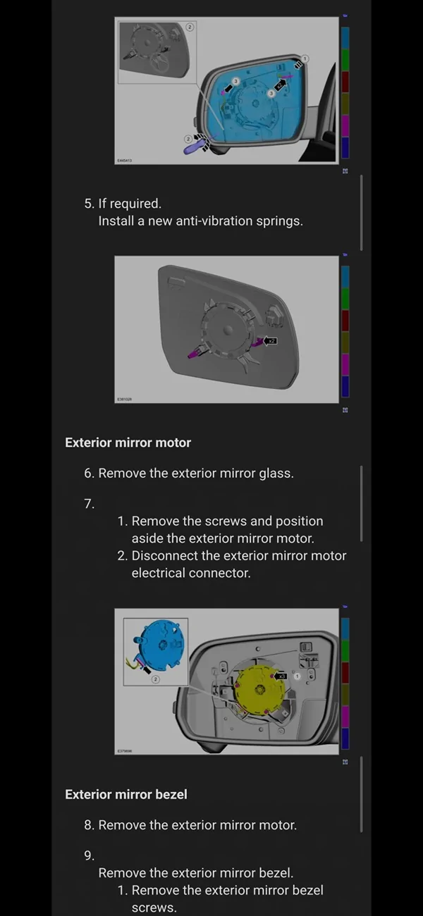

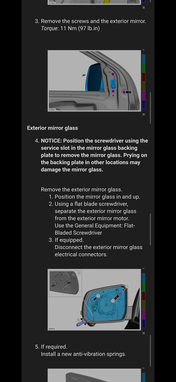

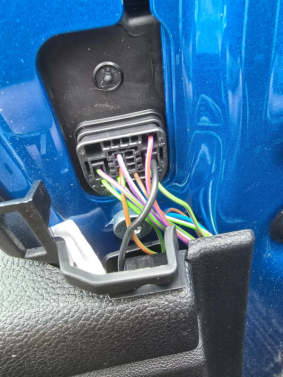

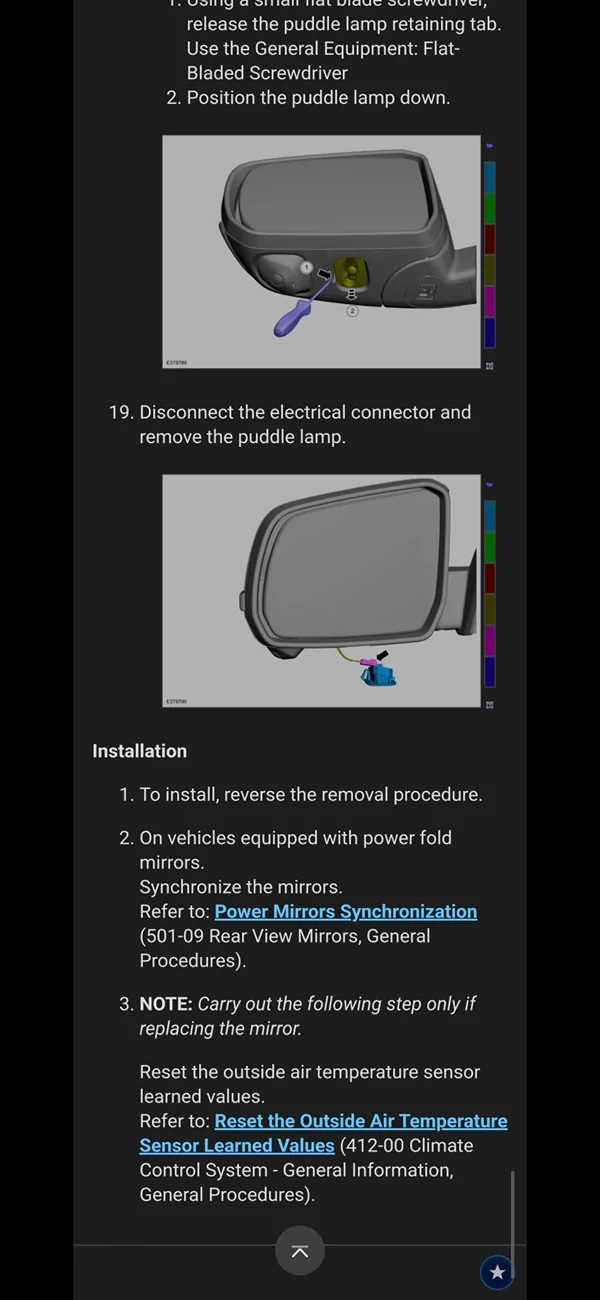

If removing the while assembly, or just the glass, here the the ford workshop manual page. you shouldnt have to remove the full door card, if you can fenaggle the bottom bolt. just dont drop it. lol
once you take the cap off the corner of the doorcard, it exposes 2 of the 3 screws and the electrical plug. the bottom bolt you might be able to get with the doorcard still on, and to the right is a black plug, remove that for the 3rd bolt.

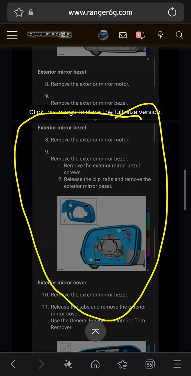

Thanks for the info. I'm thinking I won't need to remove the whole mirror. The only part damaged is this bezel. If its removable from the new mirror it looks to be an easy fix. Unfortunately it's not sold separately I'll need to purchase the entire mirror assembly just for this part.

You might be able to find someone to fix the bezel itself. Plastic welding is a thing and if done right will look great. Will have to repaint obviously.
It was busted up into to many tiny pieces to plastic weld or glue it back together unfortunately.
to replace the bezel, you have to remove the glass, to remove the motor, to remove the bezel
