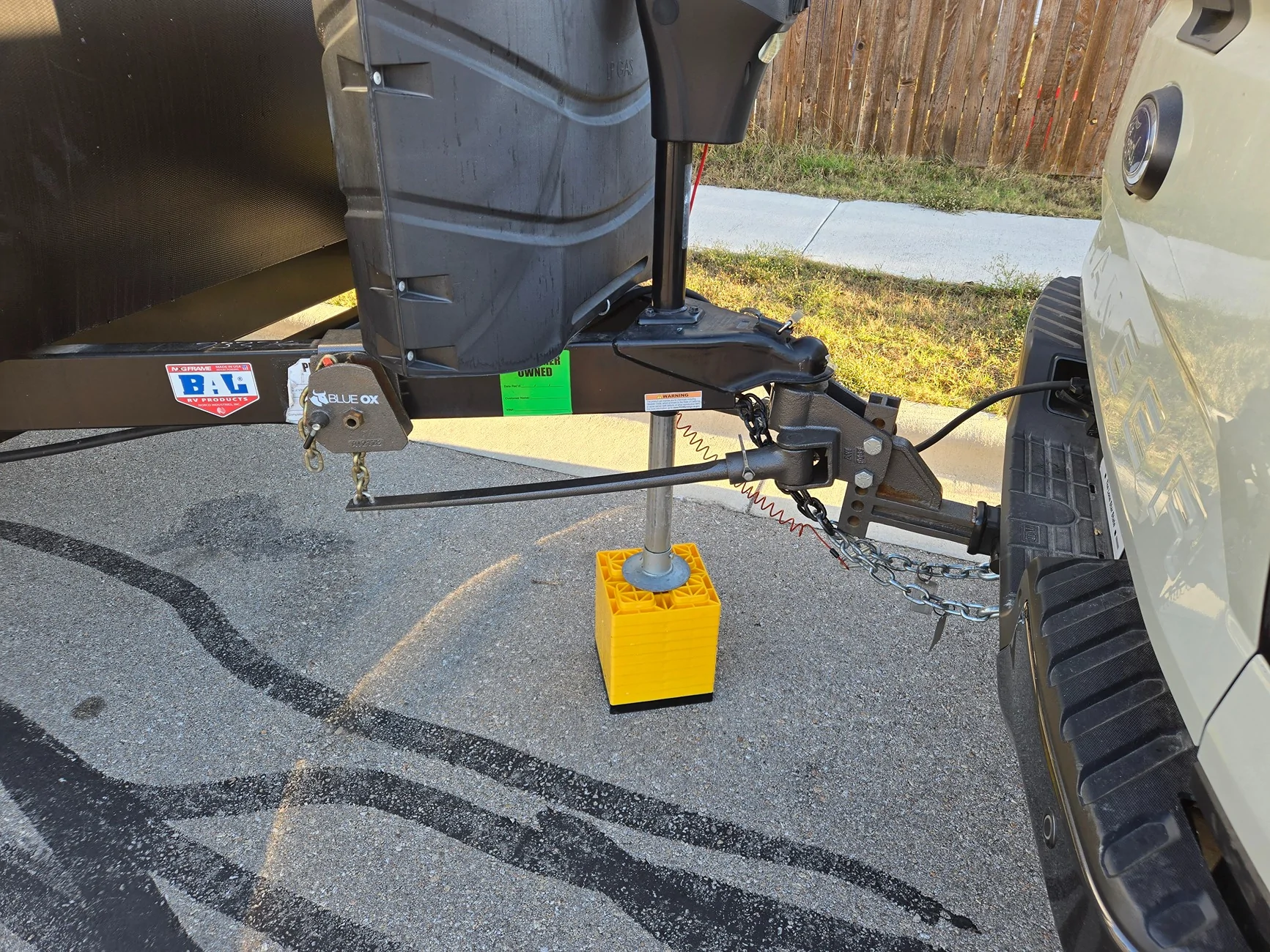

How do you like the hitch? Hard to adjust the spring bars? Noisy when turning? What is the weight? Thanks.

I am not seeing a sway brake , is not a thing anymore with modern sway control tech?
Not to speak for the OP, I had the Blue Ox Weight-Distribution - Sway Pro System for years on former F150, towing 10K car trailer. Best WD system I ever owned and I went thru a few to find the right one.

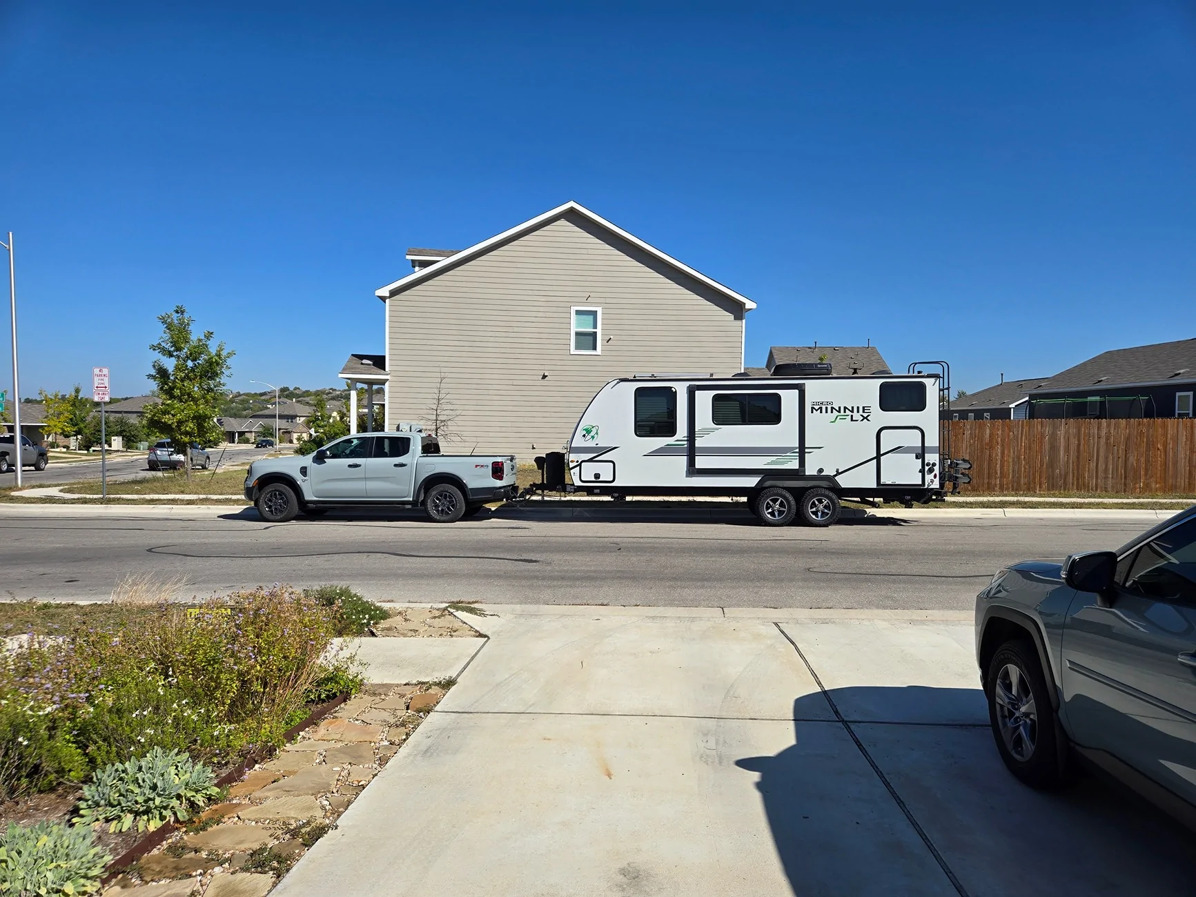

Made it to camp, with one bar of 4g to give you all an update. The truck handles nicely, never felt unsafe. Truck finds one gear uphill and sticks with it. Engine break works great in tow-mode, going down hill. I'm using a redarc break controller. Going over bumpy roads you can feel the extra weight, but the truck held his own. 2.7L never struggled, it could tow way more.

Back from my trip.
This Lil truck is a beast is the short version.
Highway: drove 65mph, wind pushed me around a Lil bit, but the truck was able to fight back with little resistance.
Up hill: easy, no problems at all. Acceleration was great.
Down hill: tow mode knows when you're on a grade and will engine break when your trying to slow down
Breaking: installed a RedArc break controller and worked flawlessly. It took a little more distance to break, but that's to be expected with a heavy load
Suspension: shocks never bottomed out. Going over road bumps/dips was fine. The suspension quickly stabalizes the truck after a bump
Windy roads: never felt like the trailer was pulling me one way or another, it just followed the truck.
At the end of the trip, I gave my truck a pat on the dash and told it "good job truck"

Not sure, I borrowed it from my boss. I can say that it's a little too much for 2 adults and a fur baby. But other than that, it's a great rv.
