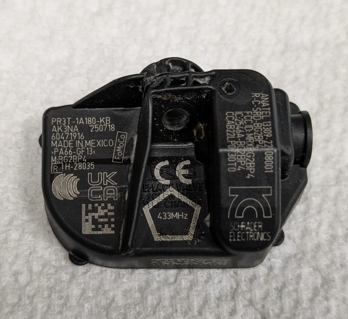

Anyone with an earlier 2025 build date know which sensor their truck has? Mine is a May 2025 build and wondering which sensors I need to order for my spare wheel set.
If you don't have a scan tool that tells you what the mhz frequency is try a local tire shop, explain what your plans are maybe even let them give you a quote on tires for your future plans, it'll take them just seconds to read the TPMS and then you'll know, and then let us know so we (the forum) can maybe lock down a start date for the change.

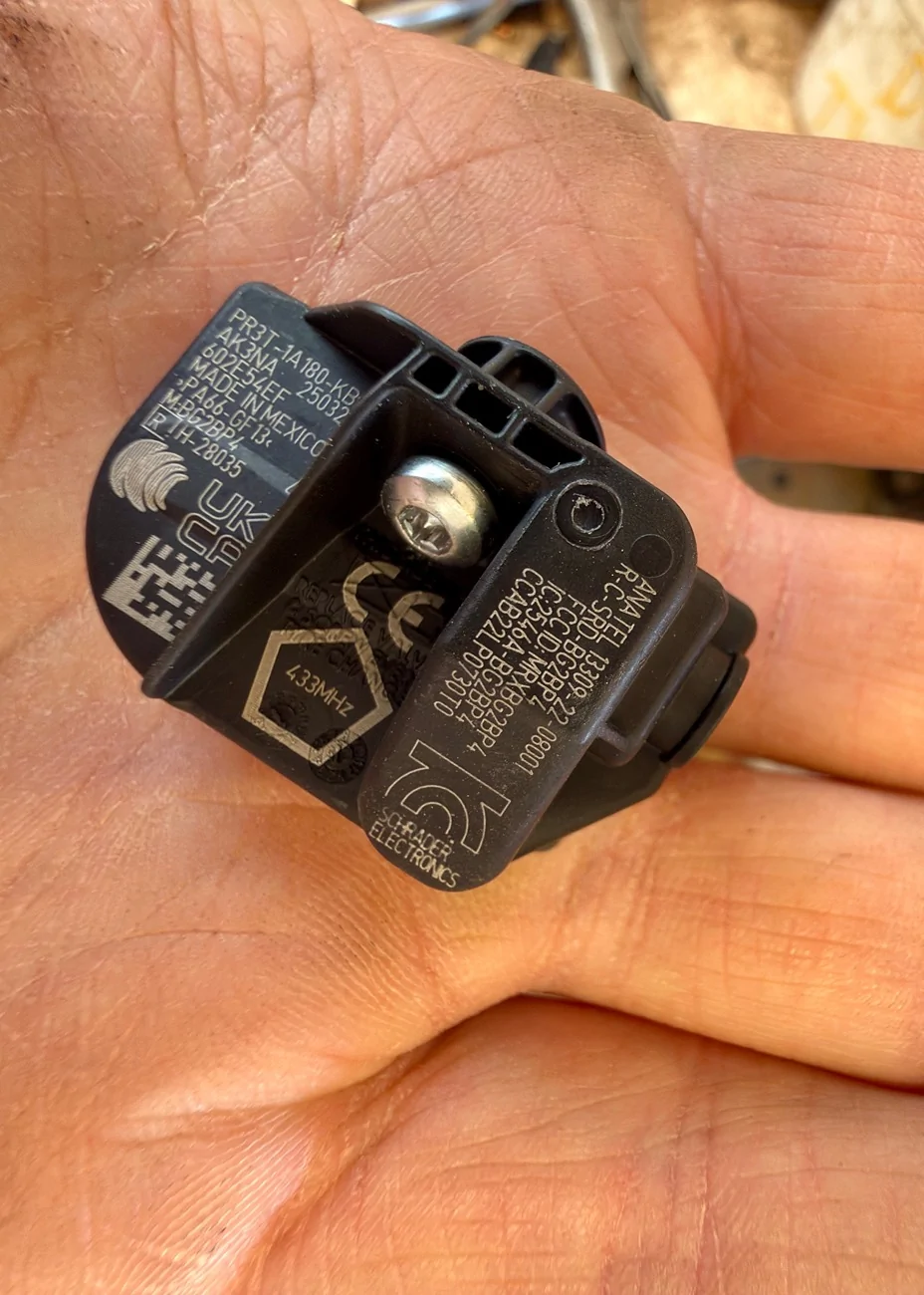

UPDATE:
I was able to reprogram the Schrader EZ sensors to 433mhz using my scan tool without removing them from the wheel, now to mount my new set on the truck and see if there recognized automatically by the trucks computer or have to do a manual relearn, I'll post back.

I installed the new tires/rims and went for a ride, the truck recognized the sensors without any input or programing/learning.
