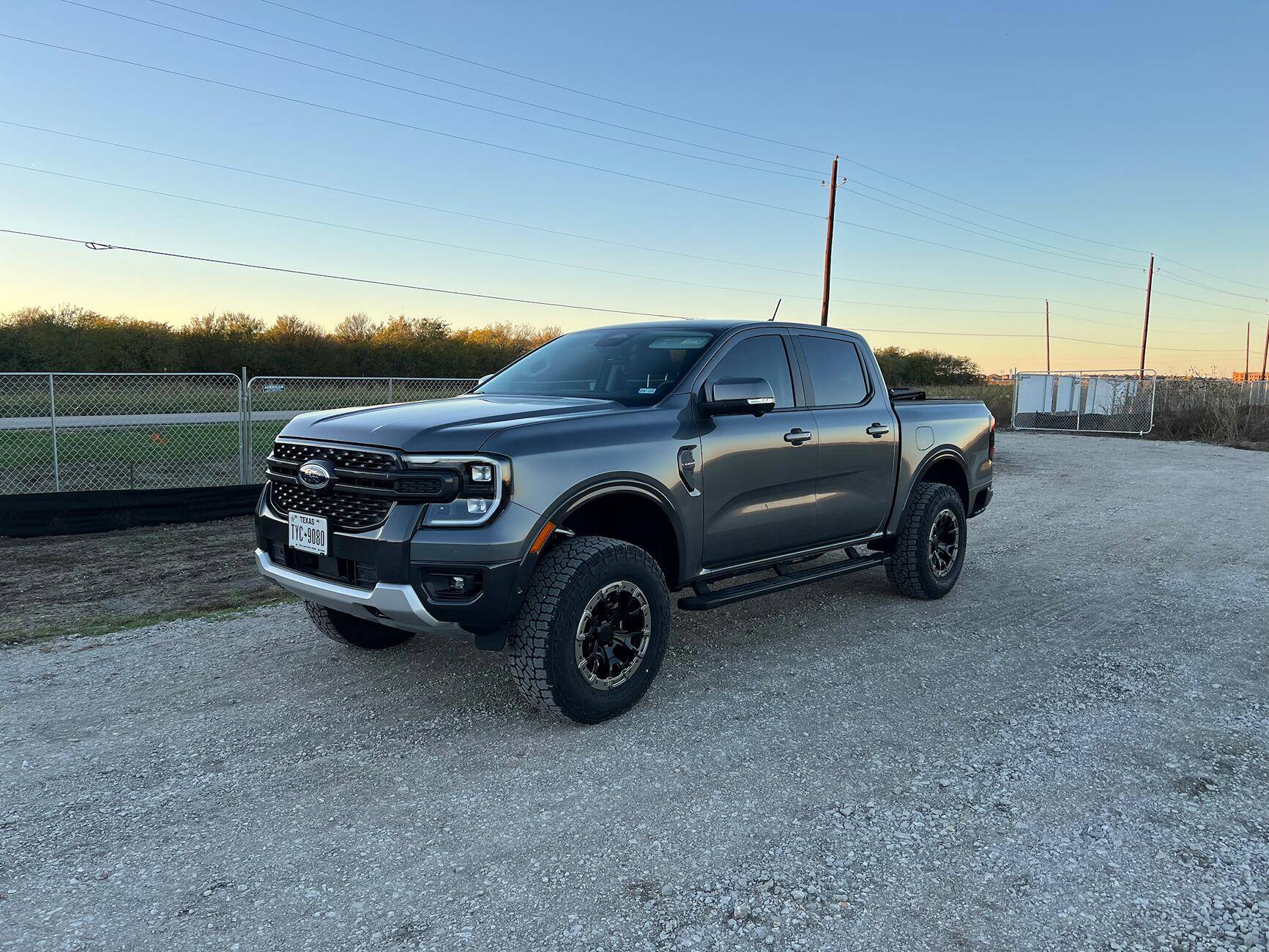

Very interesting,I just installed brand new wheels and tires on my ‘25,and installed the 433 sensors,and they work perfectly.
