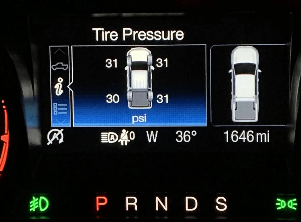

I have nitrogen in my Mustang and in two years I have not had it add any air or nitrogen.
I also had nitrogen in my Explorer Sport same thing.
On both those vehicles the dealer purged the factory air and serviced with the nitrogen.
When I took delivery of my Ranger I asked if it too was serviced with Nitrogen in the tires and they said that they only do Nitrogen in performance vehicles (Mustang and RX Sport).
I have had to adjust the tire pressure twice in 4 weeks on the Ranger, granted I have only added a total of two pounds but still...
BTW my tires were properly serviced by the dealer during "prep."
I am seriously considering a Nitrogen purge and fill on the Ranger...

Hi Folks,
Yep...Dealer is supposed to adjust tire pressure but many dealers blame the factory. We build the Ranger and install the tires, the pressures are elevated for a reason, Seating the tire bead. So when the dealer falls to do so during PDI, the customer is critical of Ford for ride...This problem is and has been going on for so long it makes me cringe. I wish we could figure out a way to use the Tire Pressure Monitoring System, TPMS to indicate too high pressure and pop a warning, but we are not there yet. My as received tire pressures on my Ranger were over 70 psi! Told the salesman and he blamed Ford...I gently referred him to the Dealer PDI and he called me back apologetic...They missed the boat so to speak. I have a certified gauge as was required at Ford for any handling work. It agrees with the Dash Icon. Some gauges are "off" but by law the "off" is not all that great. Worst are the stick pencil gauges. Dial gauges are much better. I wish every owner was a fanatic about tire pressures...Sorry for this anal rant...one of my pet peeves...

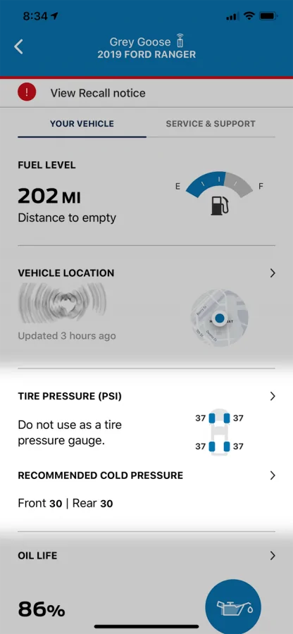

Hi..
Tire pressure was here in AZ in relative high ambient...so dismissed... Sidewall of the tire lists Max pressure for driving...not for installl. In my case dealer dropped the ball. I agree 70 plus was concerning, but when we were roadracing Rangers as part of the SCCA, we regularly bumped up pressures to stop sidewall compliance and never had a tire failure. Goodyear rep at the races approved... Thank you Carolyn A. Your "stock tires" were the best!
Bottom line. Inflate to the door label, not the sidewall.

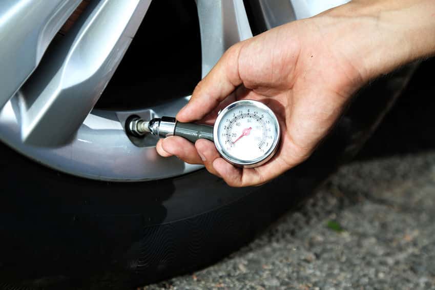

There's few ways to check your tire pressure:
1) Use a good old fashioned tire pressure gauge.
2. Use the tire pressure display in your instrument cluster.
This can be reached by going to Driver Assist > Tire Pressure.
3) Use the Ford Pass App (charges may apply)
The Ford Pass App shows you a variety of info about your Ranger, one of which is your Tire Pressure!
Thank you! I couldn't figure out how to check tire pressure from the instrument gauge.
