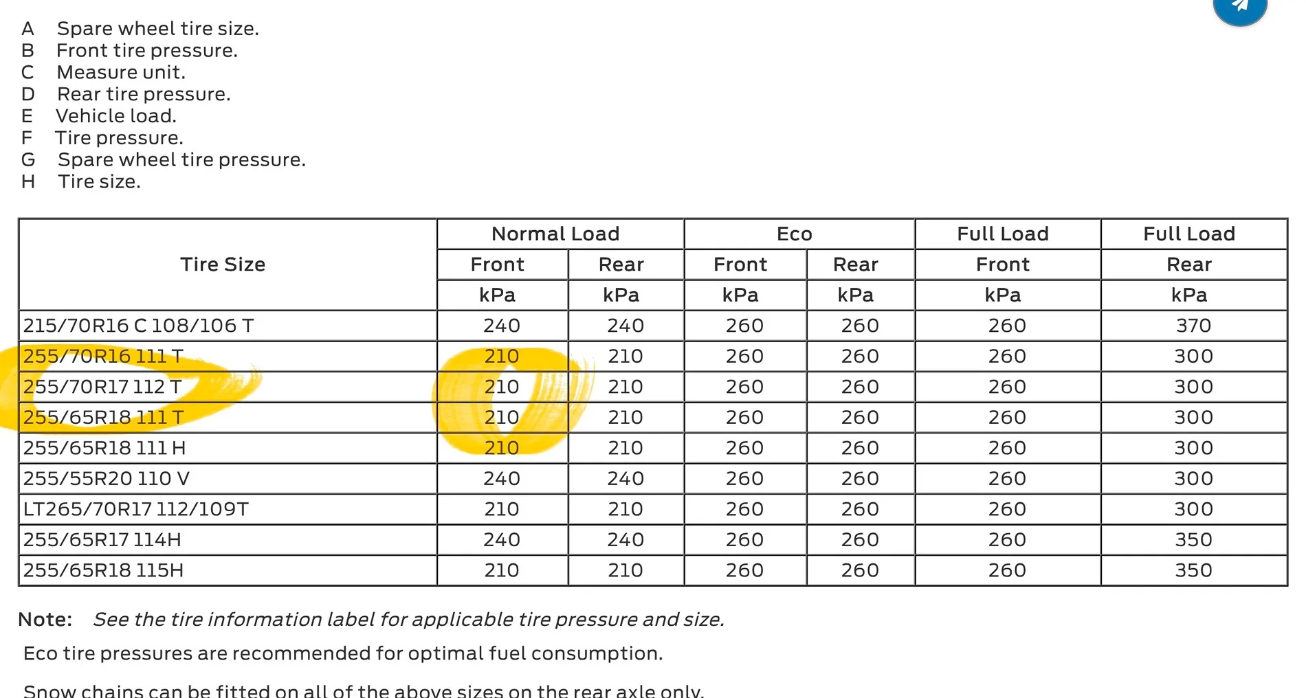

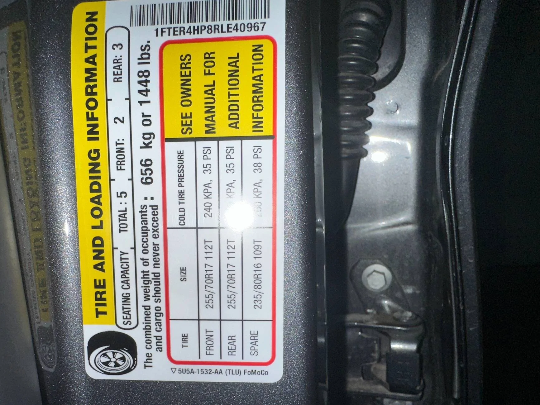

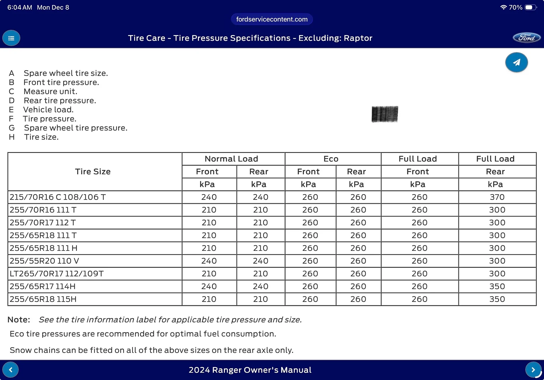

I just don’t understand why the pressure is so different on the door between the 17ā€ and 18ā€ Tires.
the tires aren’t really that different in size, have essentially the same load rating, same tire construction.
the chart from Australia makes more sense to me.

well 6.5ā€œ sidewall versus 7ā€
that doesn’t seem to me like it should be 8psi difference to. Me
i believe sl tires are rated at 36 psi and the 255/70 r17 actually has a higher max load
and then there is the chart from the ford Australia where the pressure for the two tire sizes is the same

since they are the same width, the volume difference is the ratio of the side wall dimension
7/6.5 * 30psi = 32.3 Psi. That is a lot less than is on the doors for the 17ā€ wheels
but once again there is the chart from Australia that shows recommended pressure is the same
and
the 255/70 r17 has a load rating of 112 at 36 psi
The 255/65 r18 has a load rating of 111 at 36 psi
so you could actually push a little less air in the r17 tire to have the same load carrying capability.

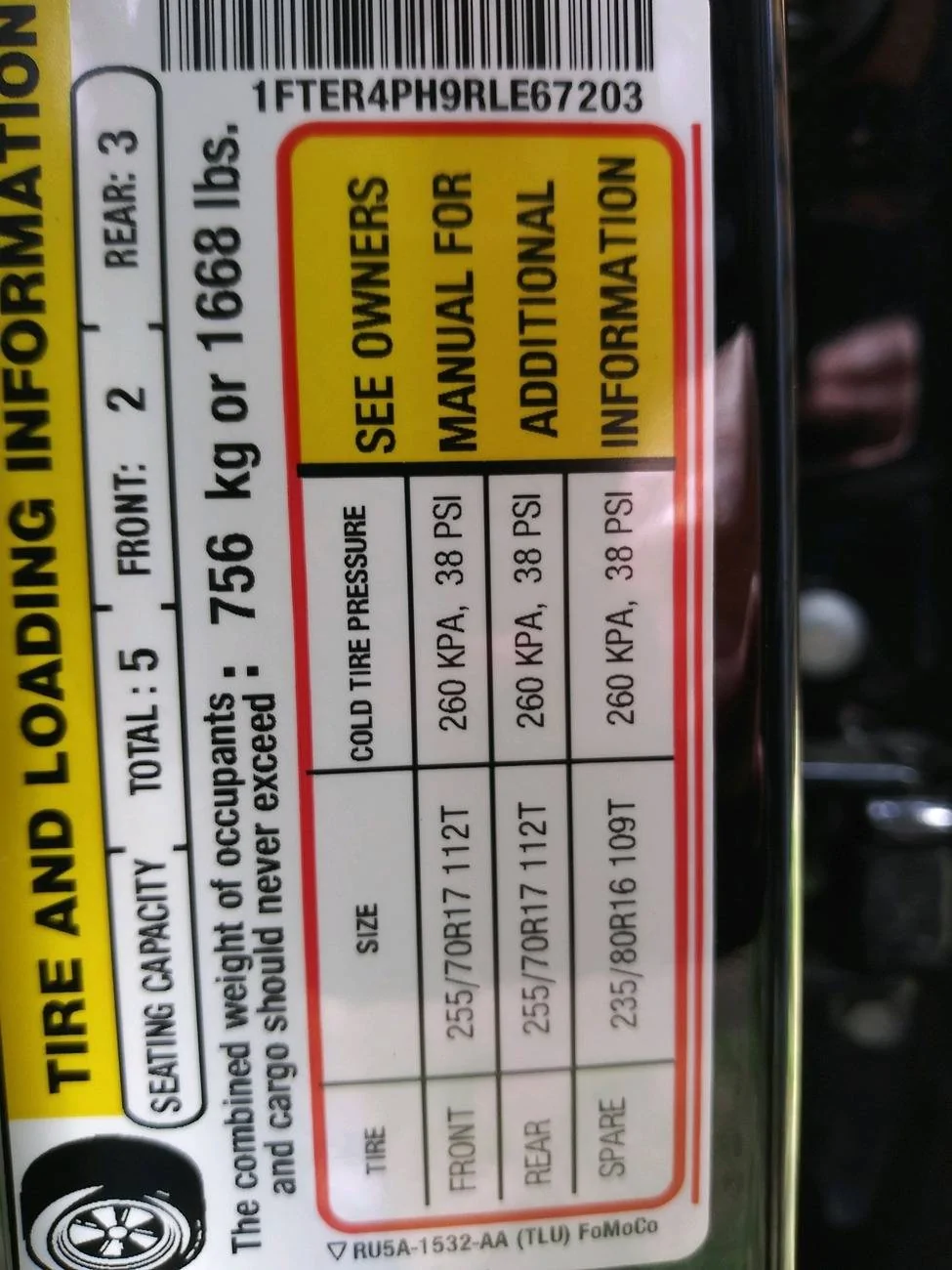

What's it say on your doors? My 2024 XLT FX4 with 255/70-R17" wheels says 30 PSI.
The Ford Pass App says "Optimal cold tire pressure is 30 PSI"
