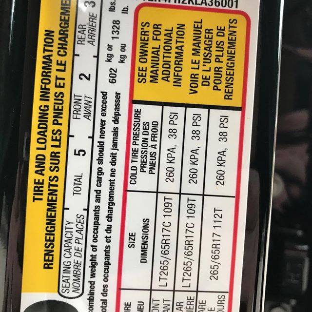

Tire width is a big factor, as it changes the size of the contact patch. (Note that the highest-pressure standard tires listed so far are also the narrowest.) Also sidewall flex: the LT tires generally have stiffer sidewalls which you don't want to flex as much as offroad tires because they'll get too hot and fail. If you change the tire diameter you're adding more sidewall and may need more air to keep them from flexing too much. Some tire manufacturers will provide a recommended value for a particular vehicle (though the ranger is probably too new for this), otherwise you could try a chalk test https://www.intercotire.com/using_chalk_method_determining_psi. I'd probably start at the manufacturer pressure based on width and come up a bit for a larger diameter tire.This discussion is very interesting but brings up a couple of questions in my mind, assuming tire pressure is really this critical
Since the recommended pressures seem to be tire size and manufacturer specific for the vehicle loading. How does one decided where to set the normal pressures when changing to a different tire size or manufacturer?
Interesting article. A little difficult to do so I hope the tire manufacturers do the work for me before I decided to change tires. I guess the Ford recommendations for the various tires supplied with the Ranger would be a good starting point for the experiment. Thanks.Tire width is a big factor, as it changes the size of the contact patch. (Note that the highest-pressure standard tires listed so far are also the narrowest.) Also sidewall flex: the LT tires generally have stiffer sidewalls which you don't want to flex as much as offroad tires because they'll get too hot and fail. If you change the tire diameter you're adding more sidewall and may need more air to keep them from flexing too much. Some tire manufacturers will provide a recommended value for a particular vehicle (though the ranger is probably too new for this), otherwise you could try a chalk test https://www.intercotire.com/using_chalk_method_determining_psi. I'd probably start at the manufacturer pressure based on width and come up a bit for a larger diameter tire.
2nd ?:This discussion is very interesting but brings up a couple of questions in my mind, assuming tire pressure is really this critical
The second question is, should I just trust the accuracy of the TPMS system readings when I decide what pressure to use? I don't have my new Ranger yet but a couple of days ago, I was adjusting pressures on my other vehicles with my Viair 400P. I tried several gages including the Viair and the various gage readings differ by about 5 PSI. Using the Viair gage to set my Malibu tires, the TPMS gave me three different numbers among the four tires and they varied about 4 PSI highest to lowest. Which one to believe?
I worked in quality assurance for a long time and always had to be aware of accuracy and repeatability of various measuring instruments. Seemingly simple things can actually be pretty complicated sometimes. Maybe there's a tire pressure setting course somewhere that I can attend that takes this all into account. LOL

Yeah, the App says very clearly NOT to use it as a Tire Pressure Guage!I have the 17" Hankooks. What tires do you have? Also, look at the driver's door panel sticker of the truck as well for cold tire pressures. I would not trust the app to tell you what pressure it should be at.
