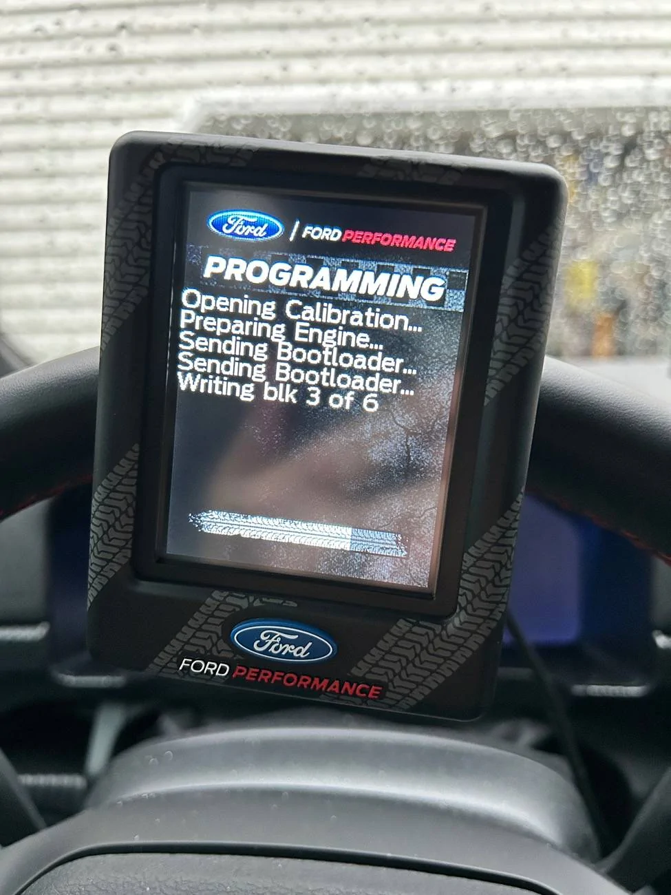

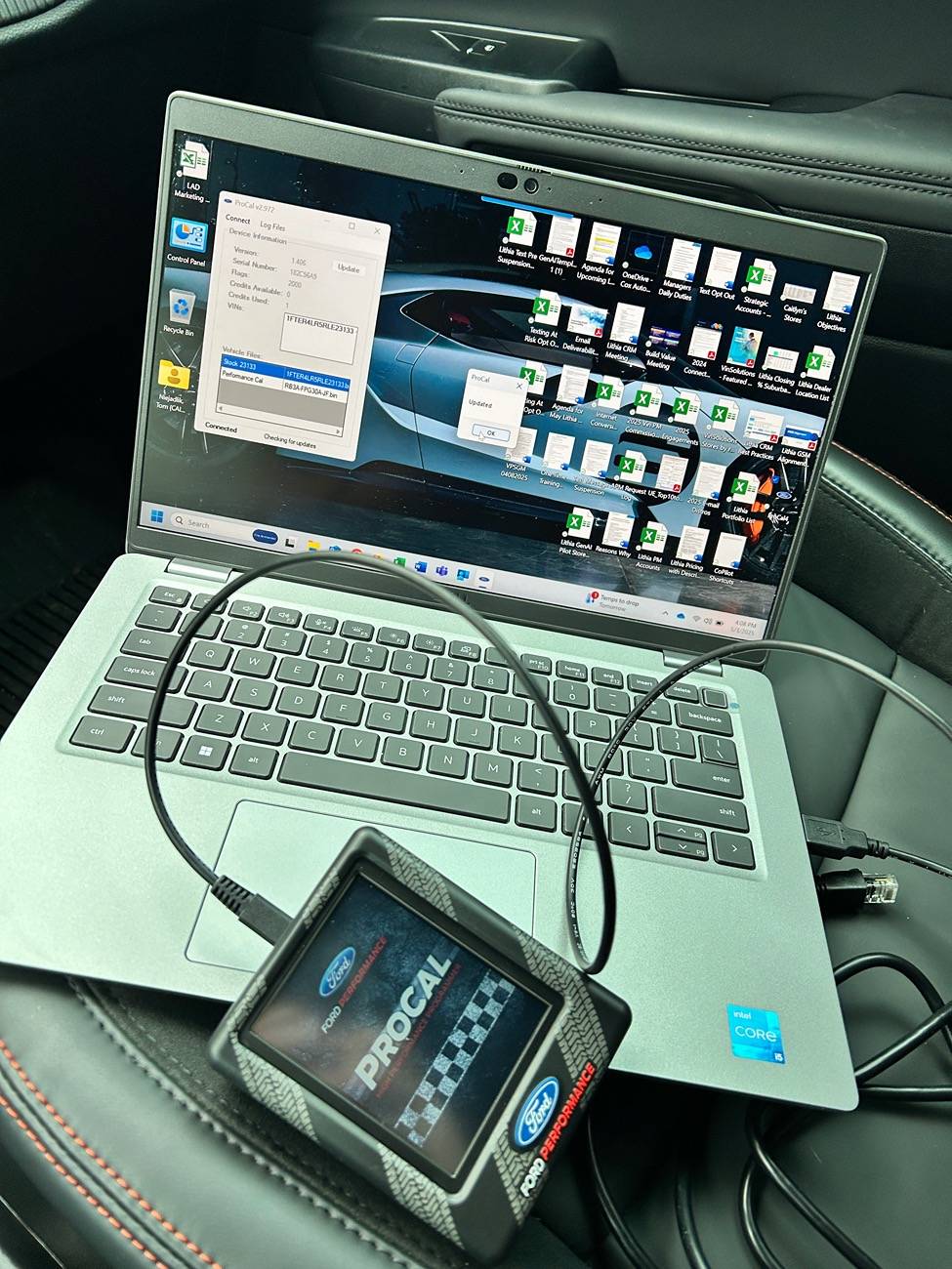

Gave it a try today. It was pretty easy and yes, there was an update available. I drank the kool aid back in October for reference. Even if you had the dealer install it you can easily update it yourself. As long as the dealer created an account for you and provided the account login AND you have the yellow paper with the voucher code. Took me about 15 min from start to finish. I should have documented the process but I didn’t. Anyone wants more details me know and I can add to this.
