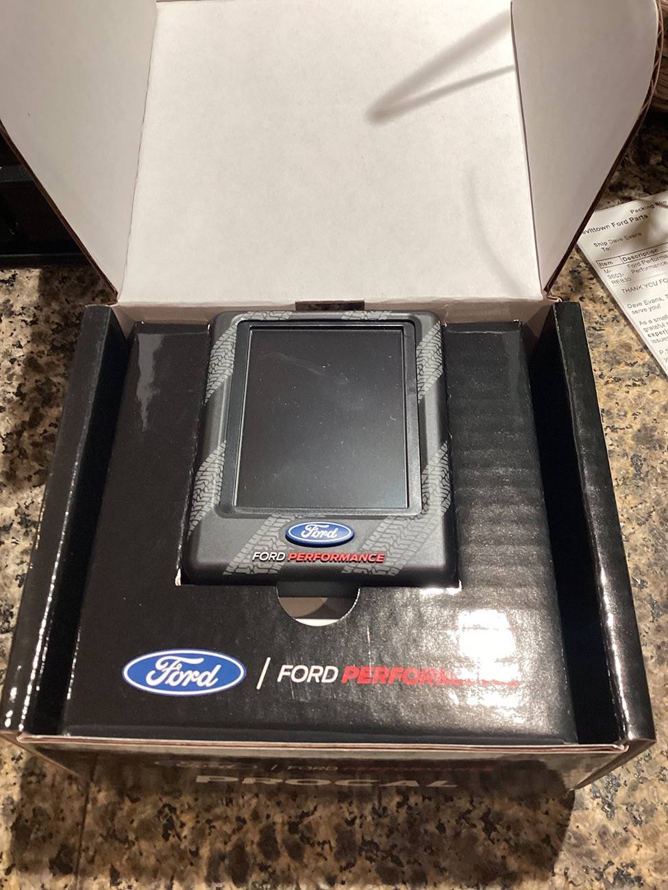

Preparing for the Procal tune to be installed

I should have my Ford Performance Procal tuner early next week and I have a dealership that will do the install. Can anyone explain to me what, if anything, I should do before I take it into the dealership for the install. Should I create an account with Ford Performance and register it? Does it matter if it's registered with Ford vs Ford Performance? Can I download the necessary files and have them on the tuner before taking it in to have it installed? I want to avoid running up my shop time ($) but also don't want to throw any kinks into the process that would confuse or delay the installer. Thanks for any input!
You can perform every task up to "Installing Performance Calibration into the vehicle" on page 3 of the install PDF. Have the dealership mechanic or ASE mechanic...whichever route you go...start on page 3. Make sure you get an install work order/repair order with all your vehicle and owner information after the job is complete. Email the paperwork to [email protected]. You will get a confirmation email back.

Ok, thanks for all the advice. I have the tuner in hand, updated it via my PC and the software, married it to my truck, backed up the stock calibration file onto the unit, connected to the server and verified the VIN and allowed it to backup the stock cal and download the procal file. I'm at the point where it should be ready for the tech to proceed with the install.
I have to admit, it is REALLY hard not to just proceed with the install LOL If the dealership gives me any grief about doing the above steps, that might just happen. I know, but what about the warranty :)
