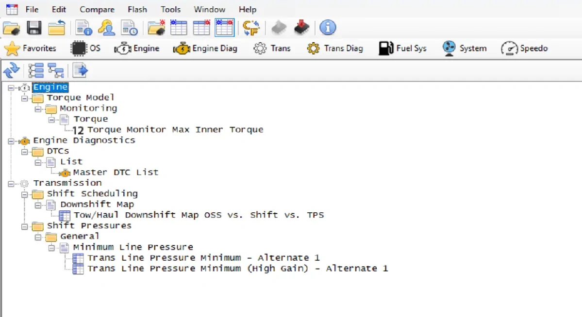

I might have had a early version but these were the changes that were made. These were probably done for durability instead of performance gains.
Ford Ranger ProCal Tune - do we need to check for updates? 1777811199764-t7
