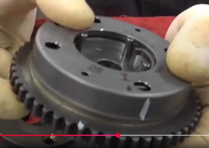

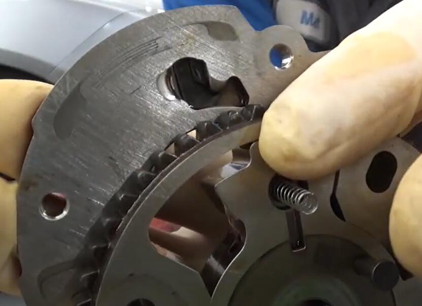

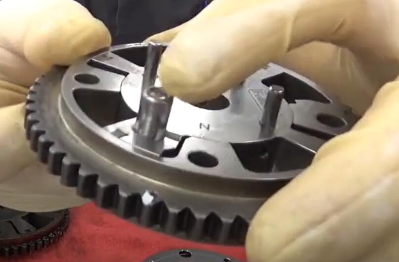

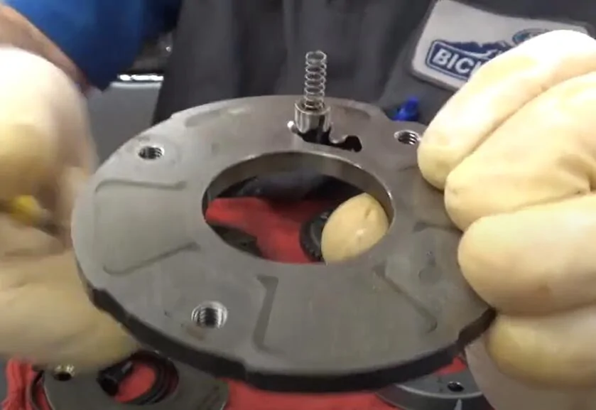

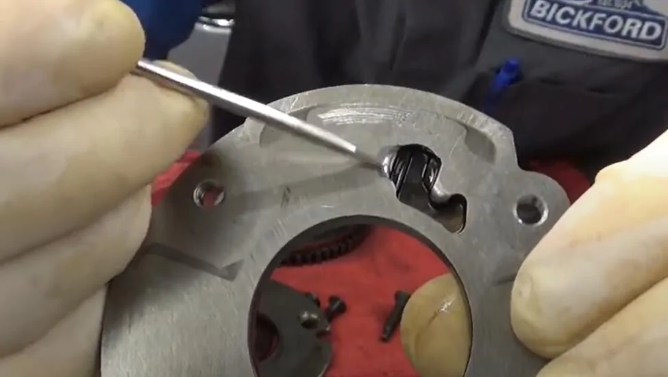

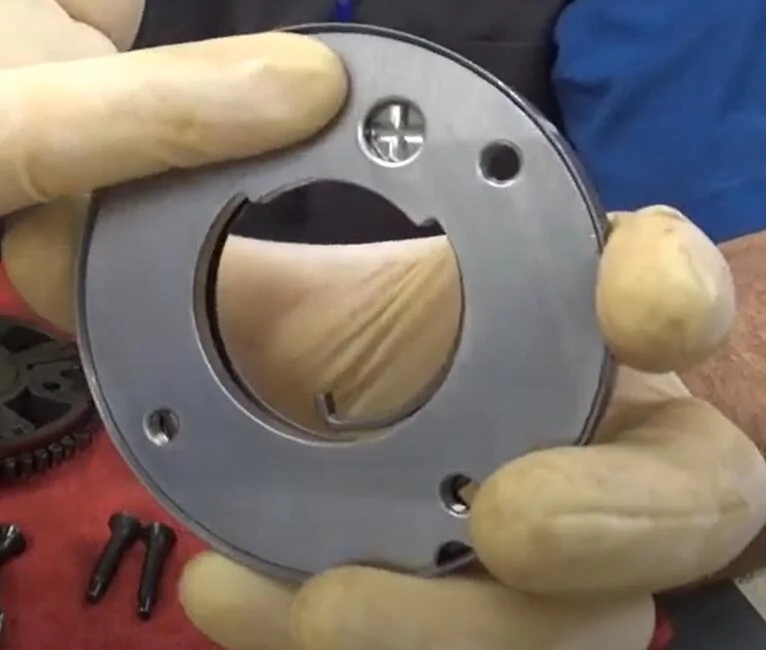

The 3.0 was introduced in 2016. Changeover would not have occurred until 2021 MY, making the majority of 3.0's out there of the older design (at least in the F-150's). Time will tell I guess, but you can't really blame failed cam phasors at 900 miles on the old or new design. That's just pure infant mortality.
Also, the designs are not 100% identical between them. There are some differences. They have different PN's but share a similar architecture. Really the only difference is the locking pin hole was re-designed in the new phasor, aside from that it's the same. That plunger pin doesn't affect normal operation either, as soon as there's oil pressure, the plunger pin is useless and the VCT solenoids control the phasor position by filling or bleeding the chambers of oil.
They could have changed the hole machining dimensions and also the steel grade to dramatically enhance the original design as well. There's more than one way to skin that cat.
