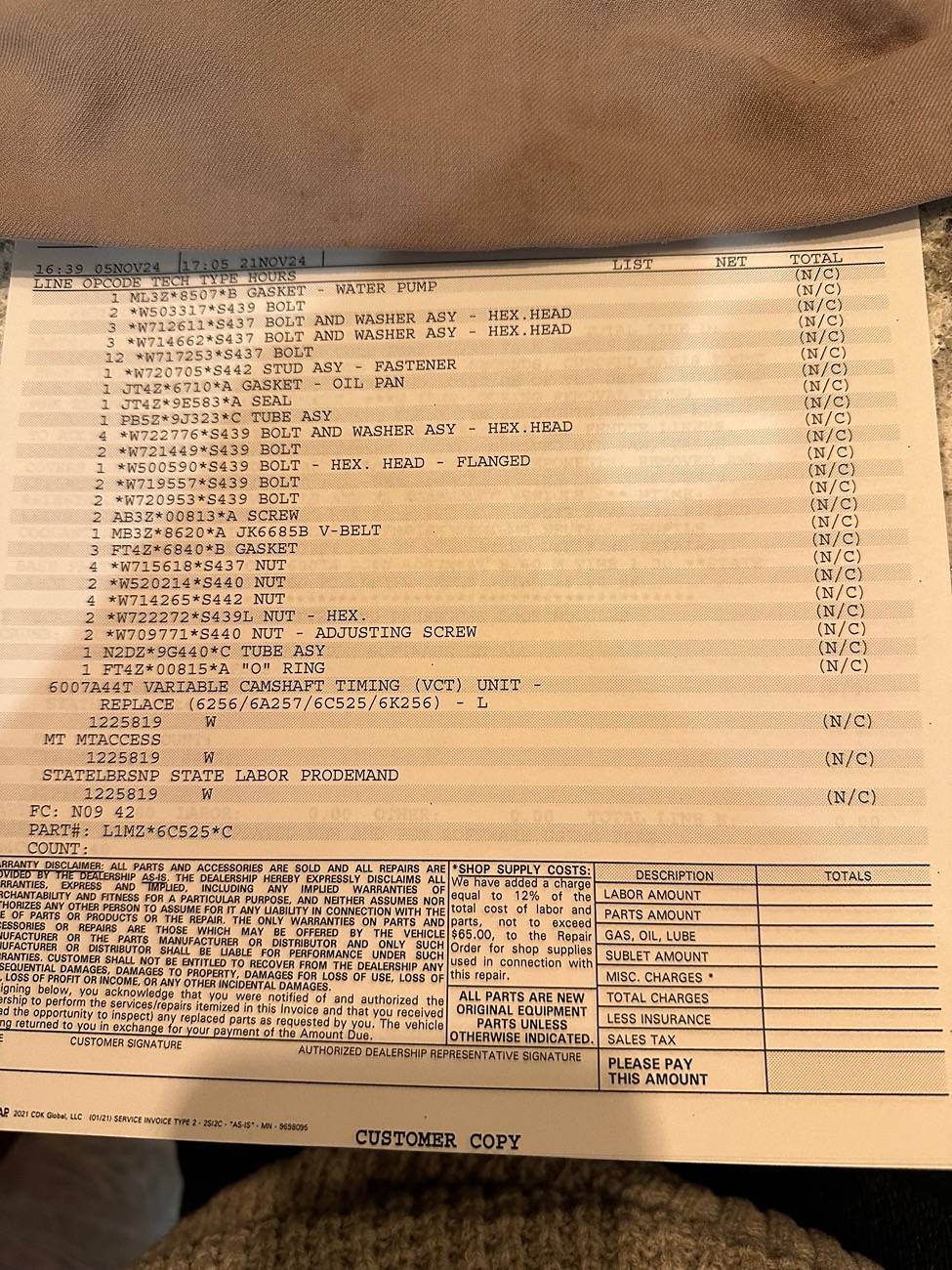

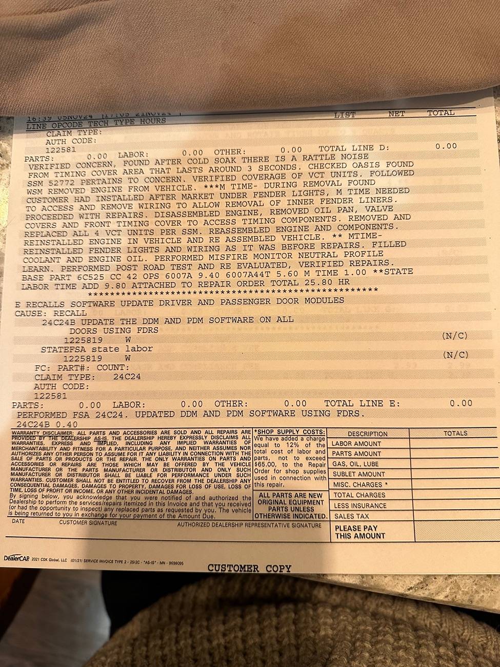

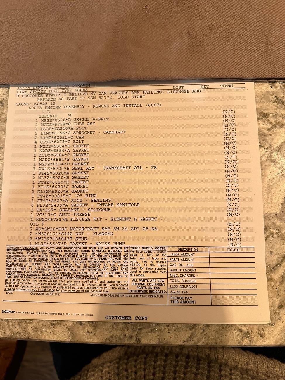

Just got the truck back. Will re record my video in the morning. Here are the service records. Was an engine out service.

They’re in for a tough morning. The sound is still there. Is it phasers? I still think so. Took November 5-21 to fix it the first time. Don’t see how this doesn’t end up in a buy back.
Deleted member 8167
Back at the dealer - At least they had a loaner available.
If this is unresolved by Dec 5th I'll initiate the buy-back process. Not sure what I'd replace it with - but after 3 F150s, 2 Rangers, 1 F150Raptor, an Edge and a Bronco - might be time to be done with the brand.
