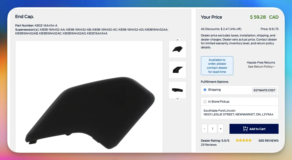

Sorry, should have mentioned that. Weirdly, everything that shows up is Canadian?

KB3B-16N452-A was not available from Ford when I did a search. I damaged mine and had to order 2019-2023 Ranger Running Board End Cap KB3Z16A454A. The number stamped on the part is KB3B-16N452-A, but depending on the revision of the cap, you will need to modify or remove the center tab that slides into the running board to make it work. Removing the tab does not affect the fit or function. 6 gen running boards have a narrow center tab as shown.
