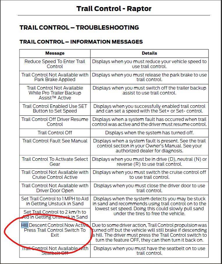

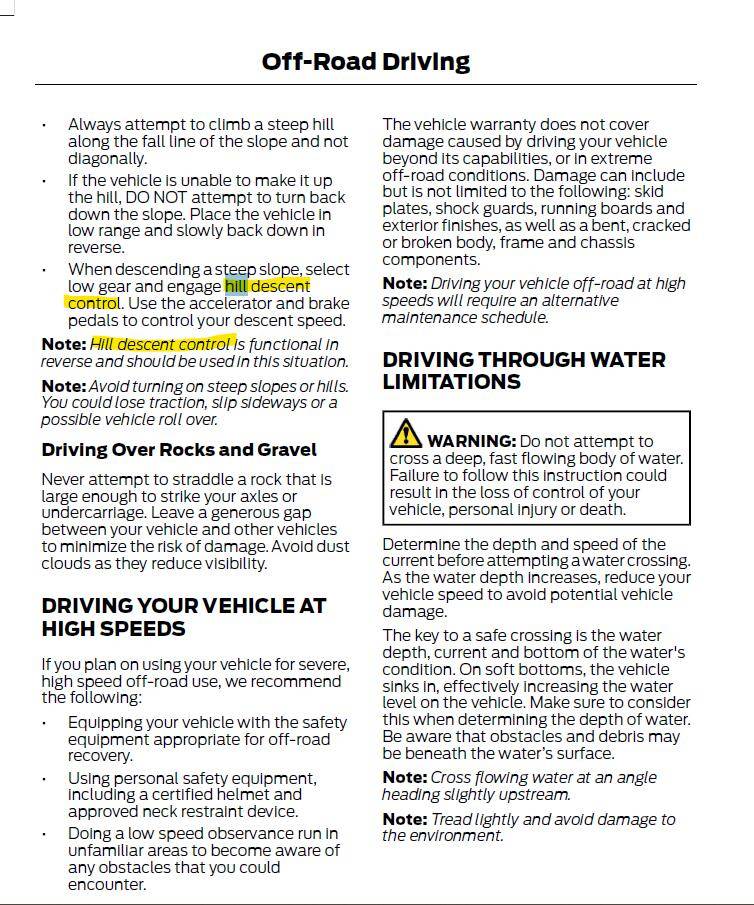

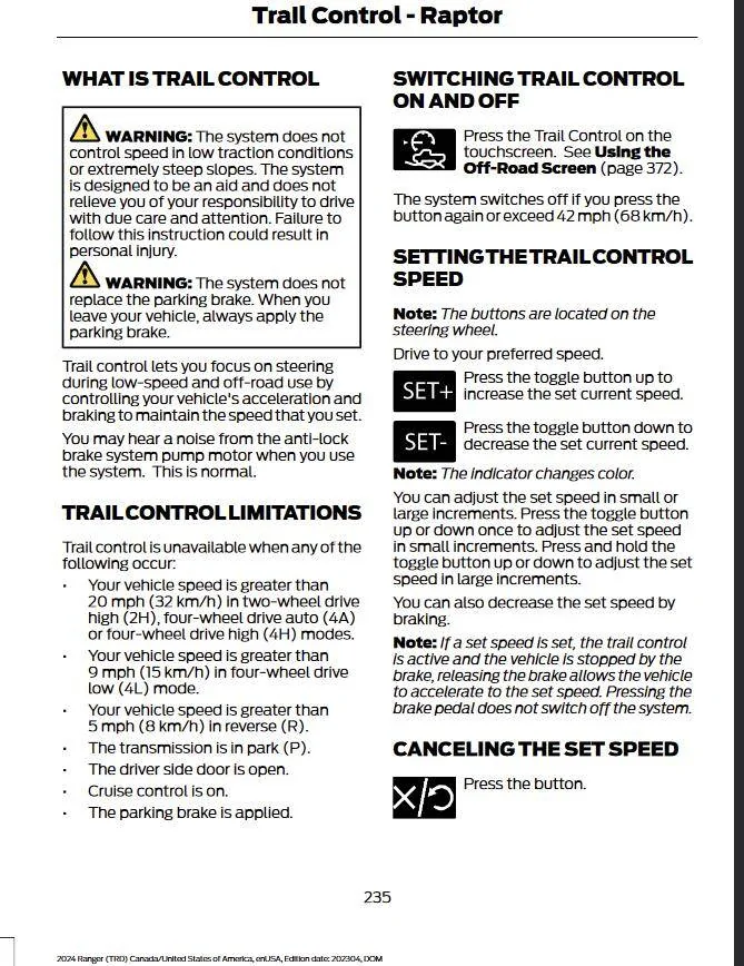

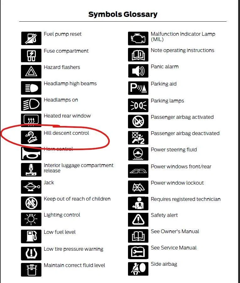

I found several references to "Hill Decent Control" in the manual and even a graphic for it. It falls under Trail Control but interestingly enough, hill decent control is not located anywhere in the index.

Interesting. Had not seen that. I suspect it’s the same thing as trail control and probably got renamed during marketing meetings but documentation wasn’t fully updated. But I’m just guessing here. Curious now….
I see the feature I was referring to earlier is mentioned in your screen shot as “hill start assist”, so definitely a completely different feature.

They are 2 separate functions. I am familiar with the hill hold feature. Trail control is an option that you can use where the truck will maintain a selected speed ( by you) using the abs and throttle functions automatically to control your speed and control on the trail or a hill. The max speed is 30mph. There is another control that's called hill descent. That performs the same function only ment for going down a hill. I'm wondering if the Ranger xlt fx4 4x4 has both or just the trail control feature.

Oops ment max 20mph
And didn't see the reference pages you listed. Looks like hill descent is the trail control function.

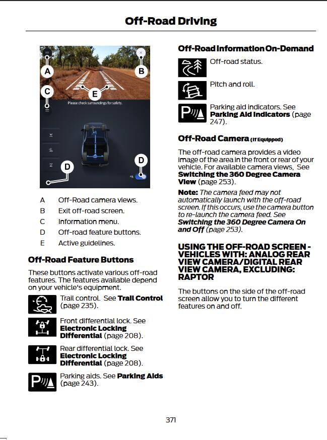

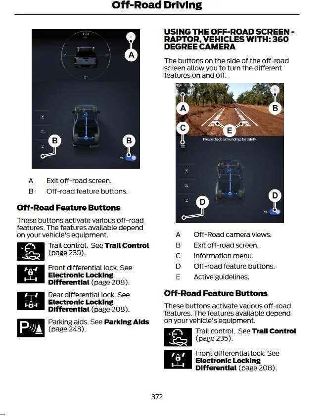

Just found this in the manual, it says "Raptor" but i'm wondering if it's the same for the equipped FX4s. FX4 on the build & price definitely lists "Trail Control" which is what this all is.

Further makes me think my initial assumption was that the marketing team changed the name of the feature. Knowing they added 'rock crawl' to Raptor as well, I suspect all of this is the same thing with hill descent being the old one and less capable. Probably all to compete with Tacoma's "Crawl Control". All speculation of course, but seems logical to my engineering mind...

Went to the Ford dealership today. Their top mechanic says trail control can be used going up or down a hill and on flat ground at up to 20mph. So there is no need for the hill descent feature.
