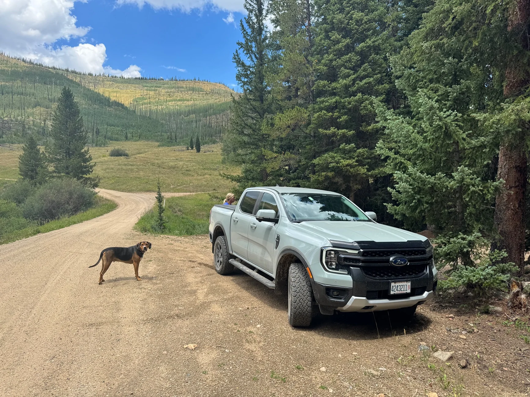

Been exploring the mountains of Colorado this summer, forest service roads etc…nothing too rugged. I was coming down a steep shelf road downhill, rough rocky gravel, and decided it would be worth trying the Trail control out…after a few miles (only) at about 10 mph, I realized the TC must be dragging the brakes alone to regulate the speed, as I smelled the hot brakes, and came to stop and pulled off (on gravel, stage 2 fire restrictions prohibit parking hot vehicles in vegetation of any kind) each of the 4 wheels was almost too hot to touch, and seriously smelled of hot brakes.
took a bit of hike to the let the truck cool and then rolled on -this time in 4L and low manual gears to regulate downhill speed….much more better….and much more what I’m used to in older, less digital-controlled off-roaders…
so, is this the use case for trail control? Or is it purely for rock crawling at -15,20mph on more or less level grades?

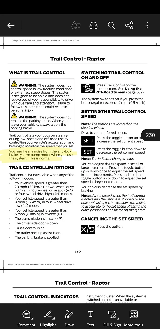

does say you may hear the abs engage. so it is dragging. trail turn assist actively uses abs to skid the inside tires in 4 low and maybe 4high to help turn. idk if the hill descent would work a bit better.

I don’t interpret what the manual says as indicating that it’s dragging the brakes, but that brakes may be automatically applied as necessary and in turn, the abs may be activated.
it sounds like if the OP was in 4h on that long, steep downhill then engine braking wasn’t enough to keep the vehicle at the set speed so the brakes were used. IF that’s the case, maybe 4l would have helped.

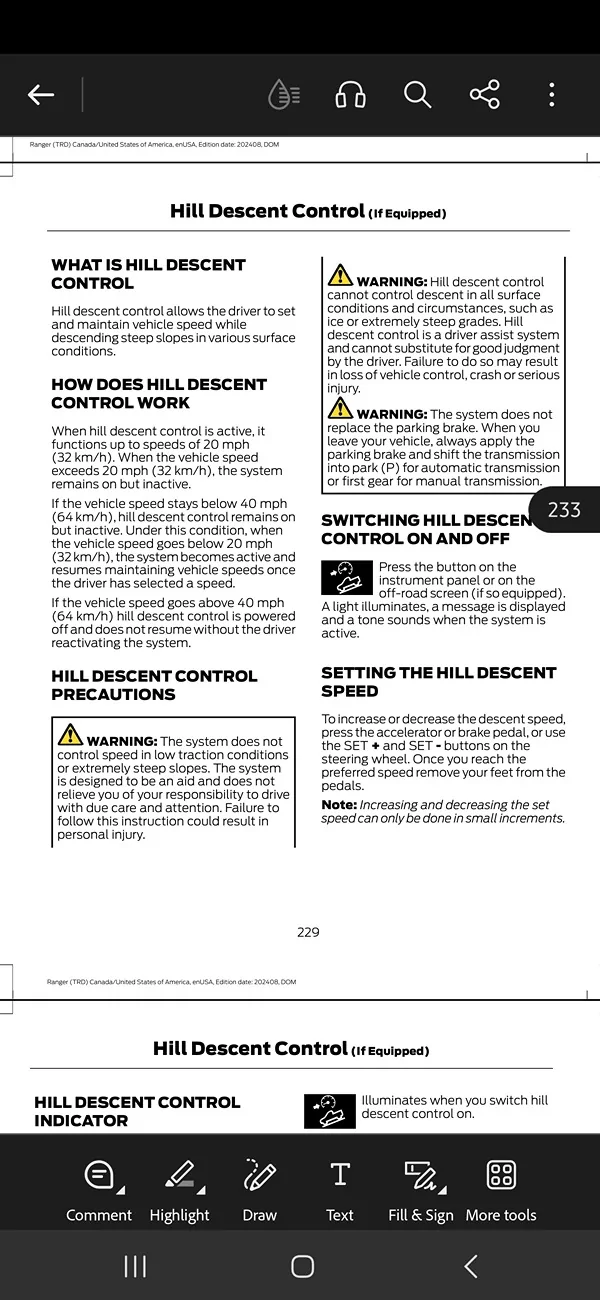

It is my understanding that trail control is only for level and uphill driving and at very low speeds.
If you were going downhill, you should have been using downhill assist or as you mentioned, 4 lo and driver controlled.

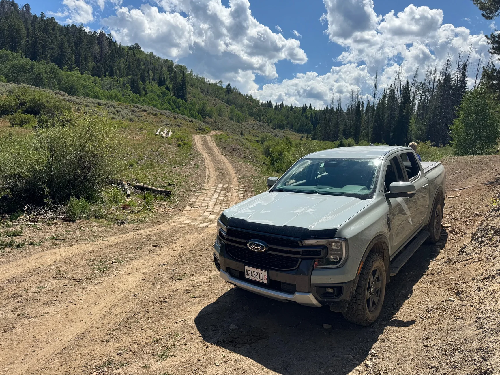

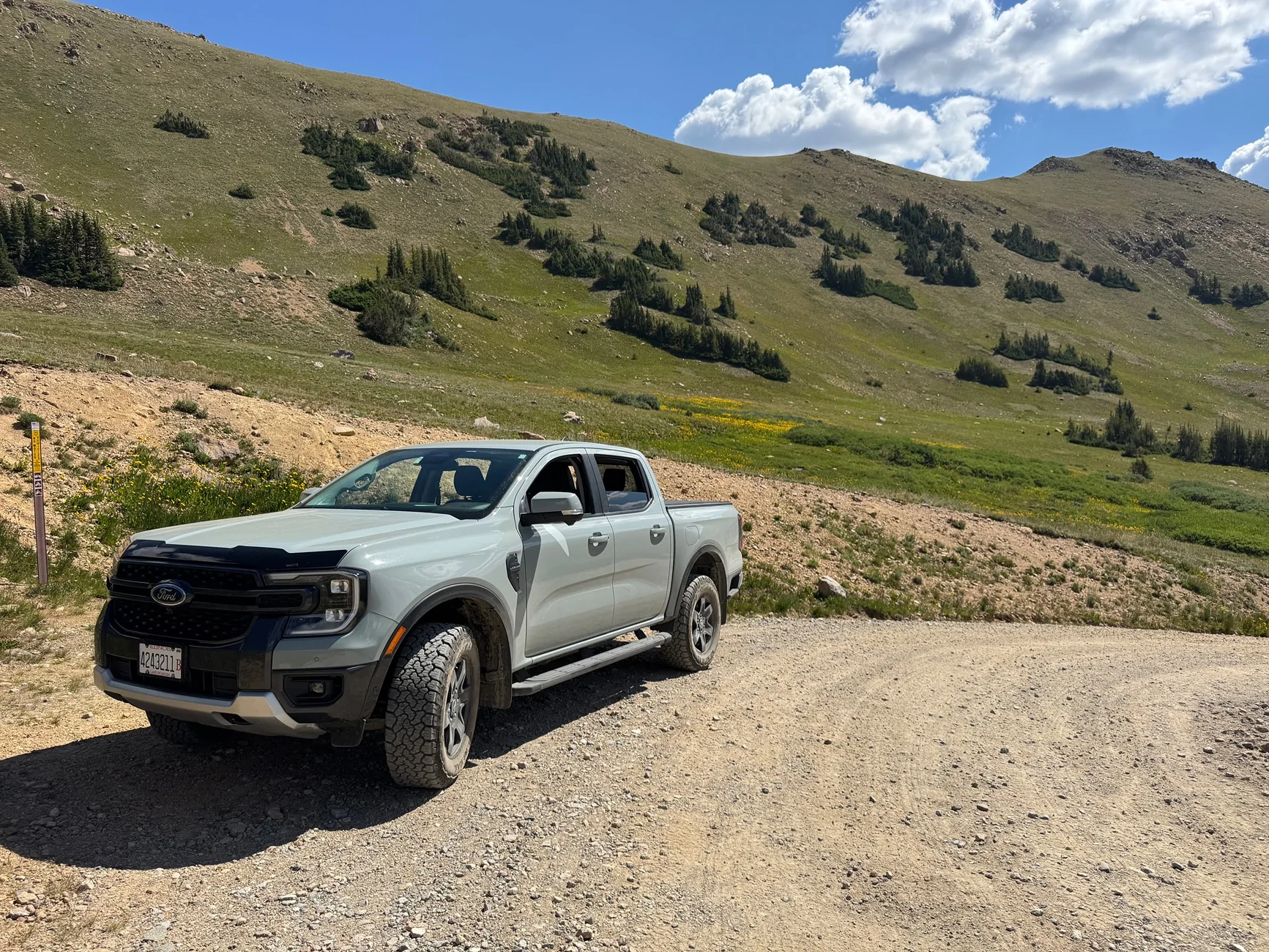

Thanks for the replies - most are correct, the Trail control 100% uses the brakes to control downhill speed, which is likely better managed for long periods with 4LO and manual low gear selection. For level or ups and downs the trail control works great - as mentioned. Like slow speed cruise control, and helps with the foot bounce on the throttle I. Rough conditions making the ride more comfortable….
I don’t know (don’t think) my FX4 Lariat has decent control)
And as stated, totally miss my 98 manual wrangler for such operations, but the ranger does well, just need to try out all these spaceship computer functions and get used to when and how to make best use of them…
today it was the muddy creek road in Grand county, beautiful scenery, and dry (like the whole state lately) but also 4LO on the steep extended downhills proved the best use….
